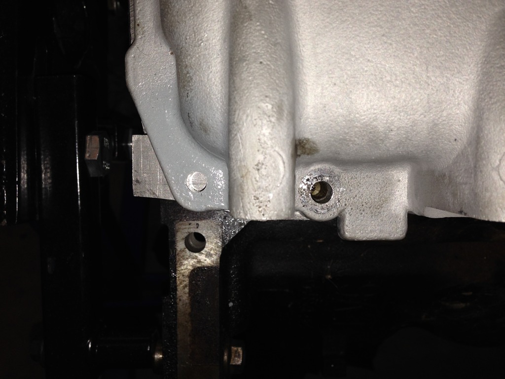

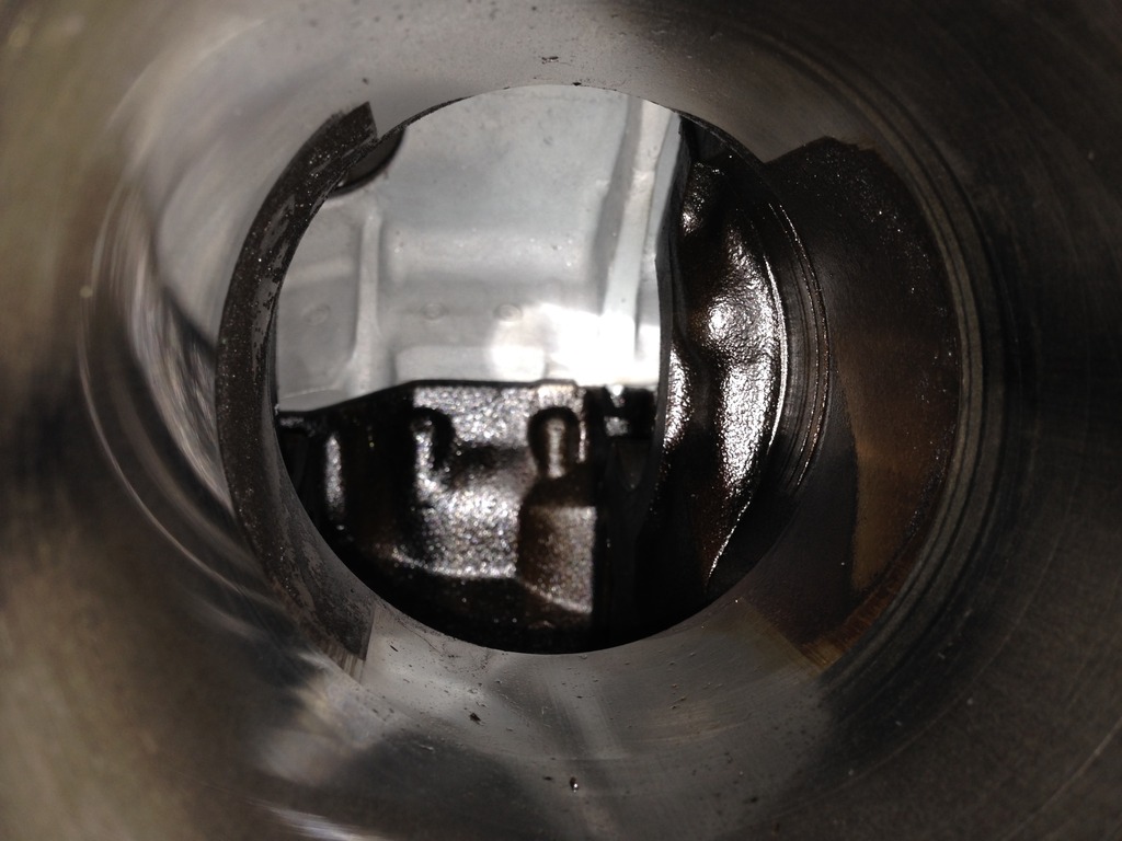

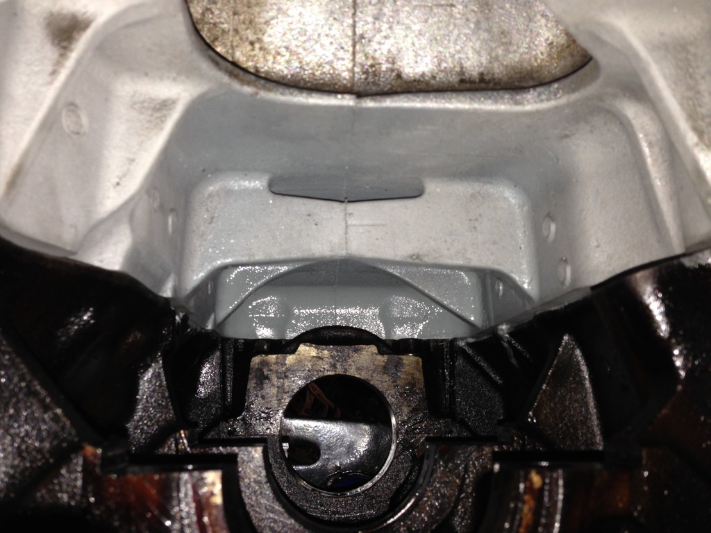

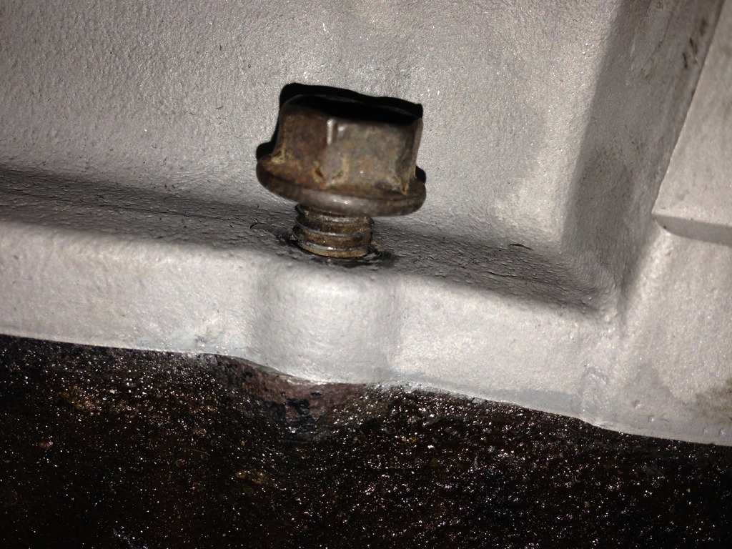

So here it is. Testing on another block I have.
nicely across the back there.
You can see the strength in it, its real solid fit. Also the sump flange is wider than the block's one so the sealant will be coated to the block to prevent exposed sealant inside the engine which could have the potential to break off. I will be testing how much I need on this block, it will be a bees dick worth as there is virtually no space to fill. Though this block is a bit low at the back pass side. I checked it with a straight edge and was low by about an estimated 0.05, the sump is dead flat. With a a bright phone light inside I checked for light something through the interface, none at all except a fraction in that low spot. So hopefully my actual block will be flat.
Dead perfect flat fit across there, like it was meant to be.

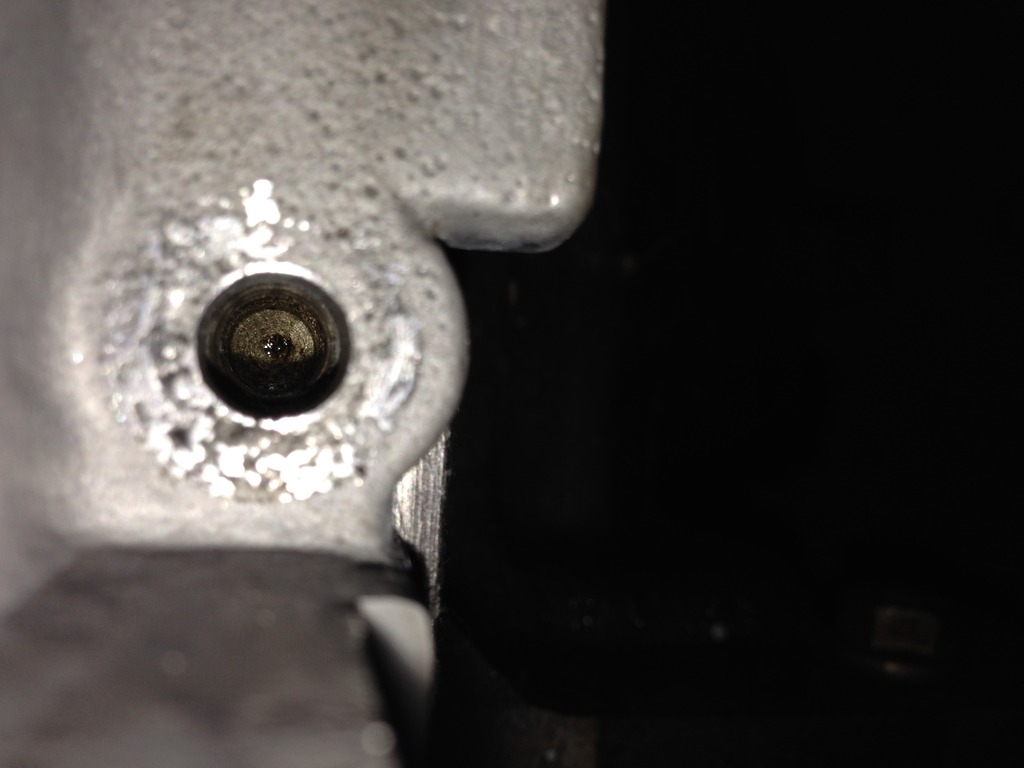

You can see where I have to add a thread, also the difference in the new hole size vs the old, only about 0.1mm or there abouts.
The precision alignment. Could not be happier, incredible considering I drill with a cordless drill haha.

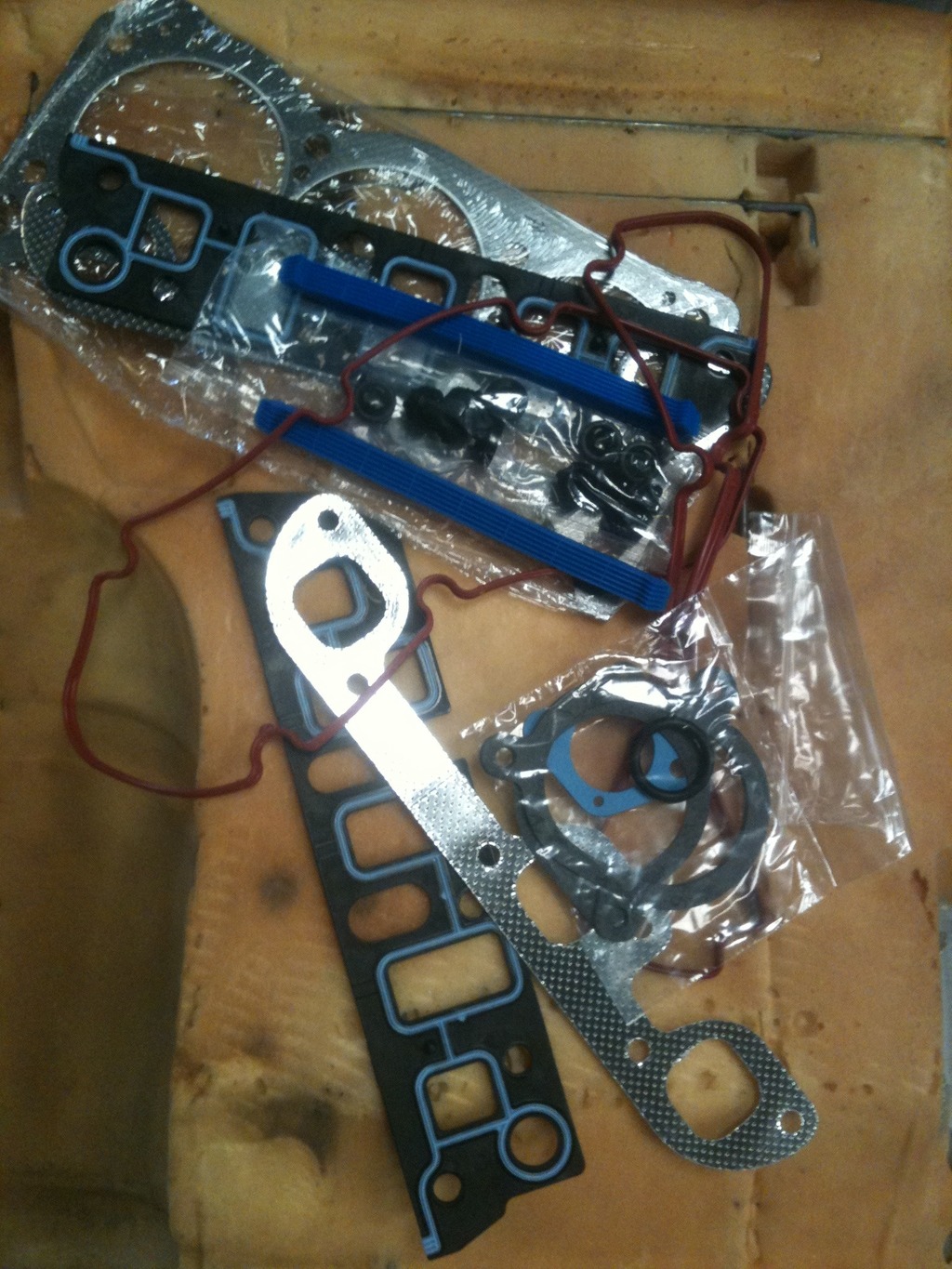

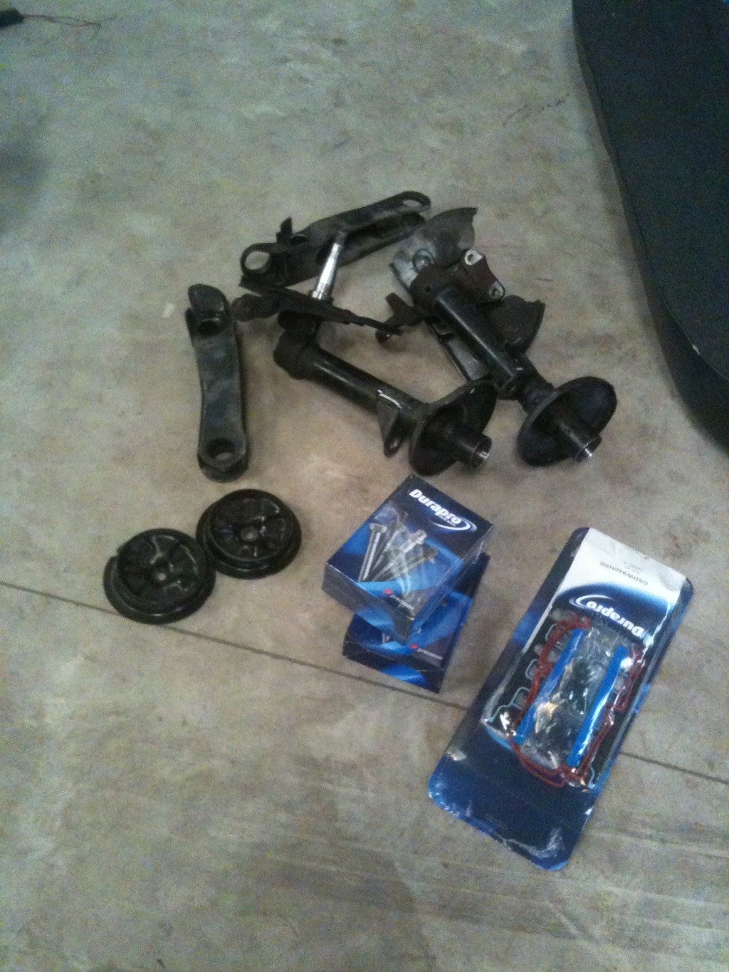

So I got some gaskets and head bolts . And all my spare front end disassembled and pressure washed at the local car wash :lol: Then all this stuff plus other bits will hit the sand blasters, lots of rust and dirt, stones stuck in the strut that needs blasting before a good coat of paint.
I have NOS boge shocks to go in there which I scored the other week for $93

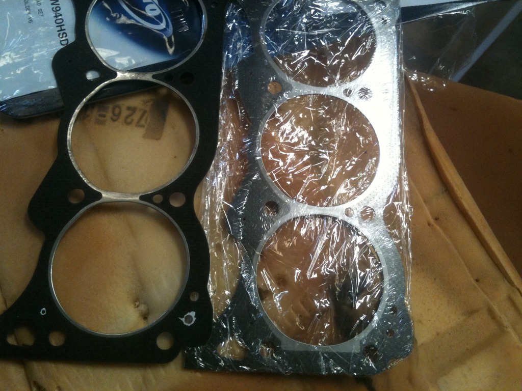

Durapro head gasket kit, very comprehensive and excellent quality unlike some other brands.
Compared to an old stock ACL one, the thickness is the same as well as the ID of the fire ring, well tinny bit smaller on the Durapro. However the fire ring is much wider than the cheaper aftermarket as seen it the pic, same width as the original factory. Also graphite like factory, not Chinese news paper? like the other cheaper brands.
