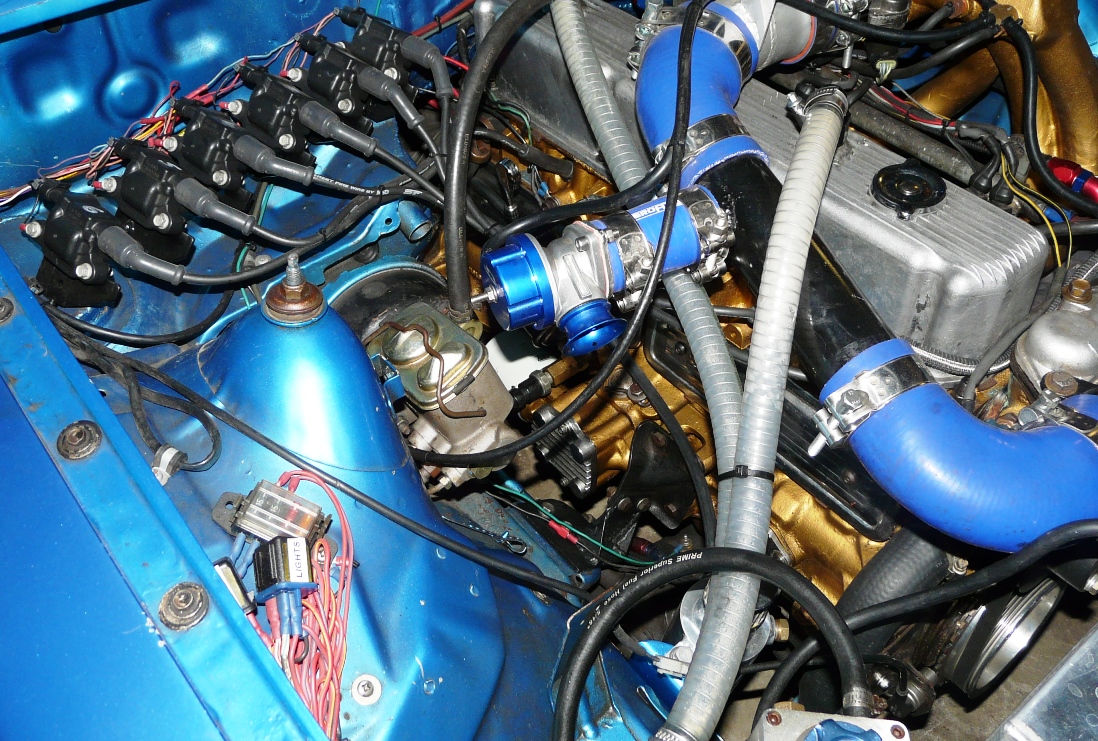

Re: Converting 202 to ABS Crank Trigger
yeah i think we are all but sorted with the 6 coils and the ignition module, the car run a 10.54 at WSID a few months back and the motor sounded crisp the entire run, no missing or anything like that! but unfortunately i haven't been able to get too many logs of my good runs (long story) but i am happy to say its working flawlessly ...
it is running wasted spark, i had a look at a cam sensor and it just got too hard and i really didn't see a massive benefit from it so didn't go any further!
as far as when its going to be available thats for VL400 to answer.
heres a pic of the completed setup, 6 coils dizzy removed and a bung in its place and you can also see the 36 -1 trigger wheel and ABS sensor on the side of the crank.
