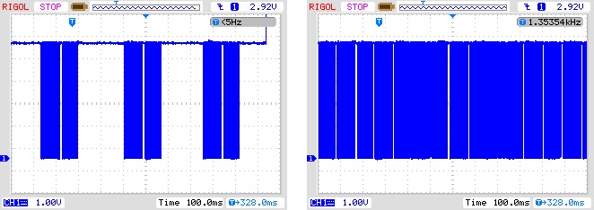

The frames/sec calc must be a bit out as I noticed things were a bit jumpy, and the data LEDs on the ALDL interface were flickering more than normal. Scoped it and looks like this on the left, on the right is logging engine and trans using TunerPro...
Looks like a 200ms pause between the frames, might be able to fine tune some delays if you are looking for silence?

AED opens/closes the comport everytime if goes to send/receive data, could that explain that?
And I noticed the frames/s being jumpy on my VY V6 as well.. as it calculates the frames/s for both engine data and transmission data frames. I might do the entire frames/s calculation over both of the frames for a more smooth reading :thumbup:
Not sure why it wouldnt connect to the VR manual.. Ill have to double check what happened there or make a more "detailed" error message to describe why its not happy. My bet is the frame received was shorter than expected which set it off possible.

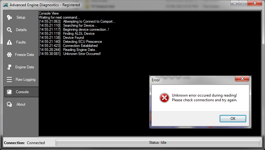

Just had someone else let me know that his VT V6 errored after reading engine data for about 5mins.
I previously had the checksum check disabled going to re-enable this and see if this makes a big difference! It may be that the application is grabbing the wrong data!

The speed might improve by not closing/opening the port, would need to experiment there. The data rate should really be over both the frames as your wanting to know the rate an item is received - say RPM from the engine frame, with the current setup logging engine and trans its about 3Hz but its possible to get close to 6Hz with no delays.
What also got me thinking was the 4-5Hz on VT and later when looking at the heartbeat, the heartbeat only occurs every 300ms so the best you can get on them is really 3.3Hz getting one frame sent/received in the spare bus time. Logging both engine and trans you are down to around 1.6Hz.
