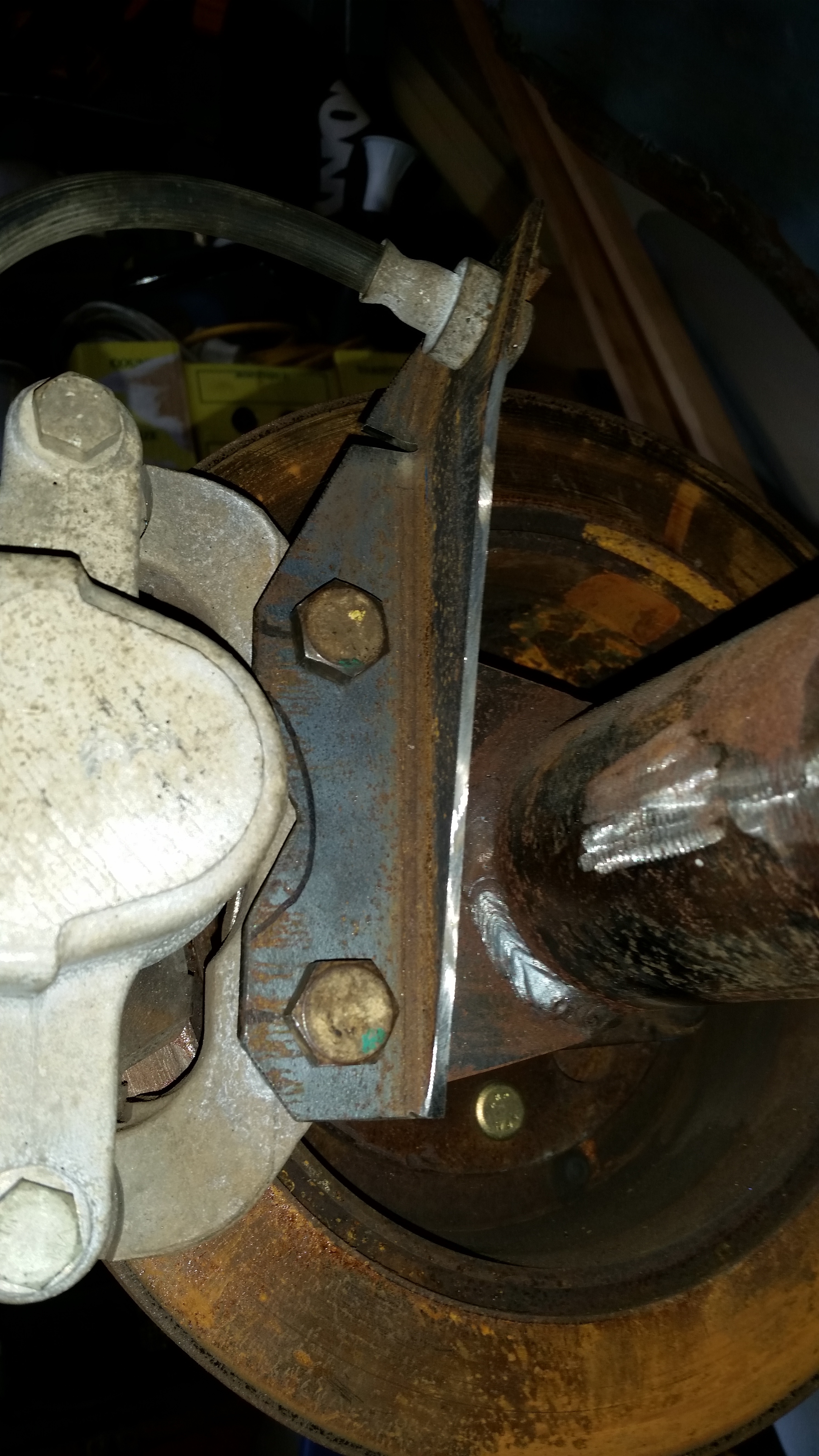

Looked up the specs for the VT rear, I think in my case the group A will be a lot better as its vented and not solid as the VT ones are. Heat being the biggest issue with older commodore models often the rears overheating well before the front do as in the case of all my cars. The group a also have a piston in the rear caliper so more force and better heat rejection.

They got the larger HSV versions which are vented. I recall they need 17" rims though?

They can custom make them to suit any disk or caliper
mine fit the std VT rear disk and caliper on a 15" wheel

I want this set up for my VS live axle rear. I currently run the 315mm rear vented disc & calipers that come in the UPC kits.commodorenut wrote:Here is an awesome rear brake upgrade for solid axel VN-VS commodores.
You can run STD Rear VT-VZ Disks or even go all the way up to 343mm Rear Disks
I have used these many times before and they are awesome, McDonald Bros in Melbourne do the kit.
Some one was selling the conversions through evilbay every now & then I saw.

The guys name was Turbo202. He was on eBay of years. He had a website too. Gone now. I have his shoes on the rear of my beast. I have a walk thru on how to weld and modify to suit the later VT-VZ rotors somewhere. I will see if I can post tomorrow.

of course these are available after I make my own mounts to put VT-VZ rears on my car!

With brackets i put up before
Im running DBA2021 with std VT rear calipers ( dusk are vented )
Also a std 15" wheel will fit.
Thats the combo i have run on about 4 of my cars in the past
