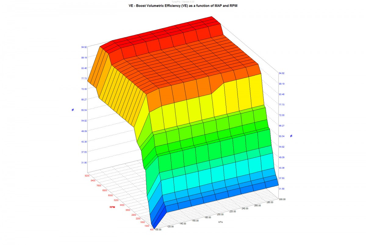

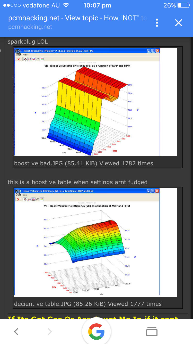

Anyone know why my boost ve table looks bad like in the top photo. How can I fix it?
Re: vr v8 turbo base tune
At the risk of stating the obvious, start tuning and change the values in the boost VE table?
You cannot just randomly change the values to make it look pretty, and what you have (which is not what is in the picture) is sort of OK for an initial config. You will find the VE increases as boost increases but will need to get the wideband on it and start tuning to find out what the engine needs.

Ok cool. I was worried that I'd done something wrong. If it's suppose to look like that before tuning than that puts me at ease. Thank you
theres a few factors that can effect how it looks too, like for example, if you have a rising rate regulator or not, like VL400 said, just start tuning with what you have and if the wideband says the fuelling is right don't worry about the look of the table! although obviously smooth out spikes as you go!

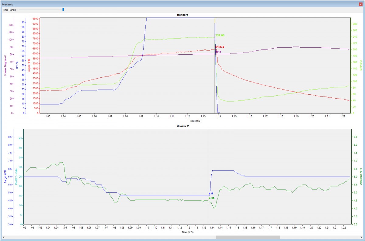

took it for a drive to the servo and back after work. boy did I get some looks lol. keep in mind I only have half a dump pipe off the back of the turbo. I probably wasn't as smooth as I should of been with the throttle. any way heres the 2 logs

Also found a couple things that need fixing. Still got an exhaust leak from one of the manifolds and I've figured out why. Really needs an exhaust. It's really hard to start, turns over really slow. Under acceleration the engine fan is just hitting the top of the wastegate, so the fan will need a spacer. For some reason the blinkers ain't working. And under deceleration it's going straight to 20:1 afr's
Posts: 2605
that will be decel fuel cut off (dfco)
