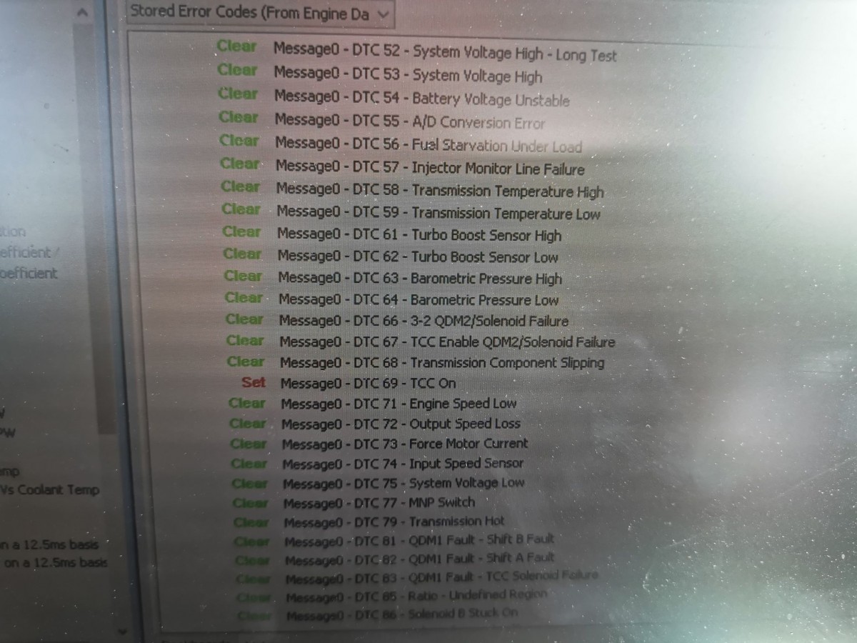

vp304
- Posts: 479
Re: 11p transmission 4l60e holding gears
Took of from work tonight got around corner started logging and 6 7 sec into log the tps faulted again so i pulled over and stopped and saved the log.
I also noticed sometimes i am getting a dtc 69 TCC on. I google a bit on the tcc fault and it says can be related to tps also ?
Trans in the car i was driving before i fitted the l67 and was in perfect good working order. Car is still running the original vr 95 model 4l60e trans.
I watched the transmission dash page and it looks like the tcc is locking up and unlocking as it should at around 80kph were i have it setup for in 4th gear
vp304
- Posts: 479
What I have knoticed driving the car daily. Is the Tps fault always happens around 40 50 kph in 2nd or 3rd gears.
I saw on another post on here someone swapped a 3.8 v6 into a 4wd and was having Tps errors due to the larger wheels.
I'm in a standard vr Ute standard 3.08 diff so don't think that's my problem but could my problem be something like that a glitch or bug or wrong numbers somewere in the Tps trans settings?
vp304
- Posts: 479
Anyone >?
This is part of the tune i was mentioning in the post before
