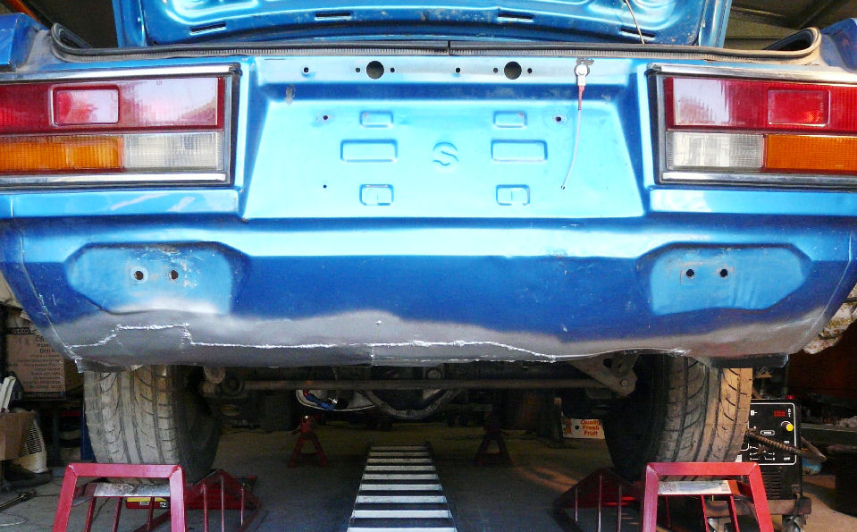

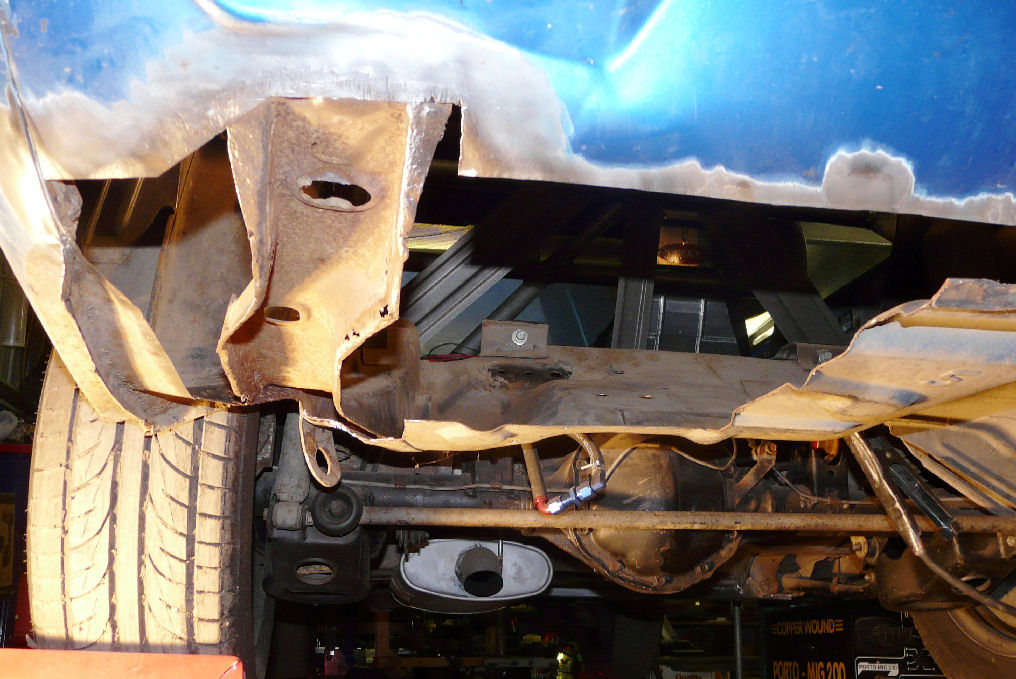

You sure are and thats a damn good welding job too!!.....not a perfectionist huh??....it looks good mate
Re: My Delcoed Rides
thanks, but if you saw it close up you'd realise how ugly the welds are, up side is i will grind them back and put some paint over them and they'll be under the car so usually never in sight .... the bit that goes up the back of the boot a few inchs i made sure it was neater and being not under the car it was alot easier to do anyways, so aslong as it blends in i'll be happy!

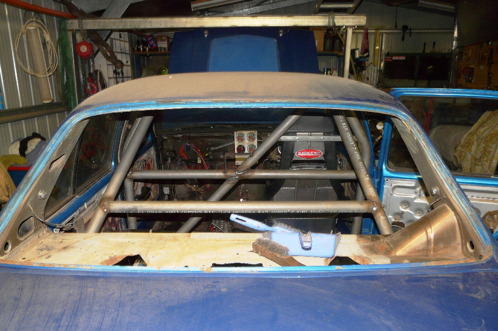

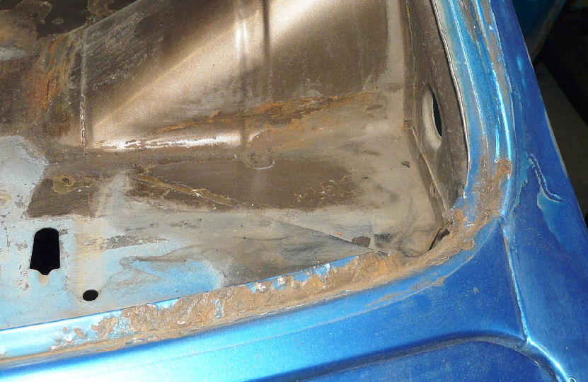

well after getting a big sheet of .55mm thick 2400mmx1200mm plate and looking at the options for getting a piece of it for the back seat i decided it should have been done before the cage went in and as a result the only easy way to get it in that i can see is through the back window, i did also want to fill the holes in the parcel tray or cover it aswell so i bit the bullet and removed the rear window.
as you can see i found a small suprise under the seal .. really the suprise was how little rust there is i was expecting alot more after what i got out of my torana when i did the same thing. So theres a few hours work there to replace some of the metal in the corners, nothing to loose sleep over though and atleast now i'll know its done!
im also planning to cut the filler neck panel out and make it flat like the other side of the parcel tray seeing how i don't need it.
i didn't get much more time this weekend other than to grind back the welds on the outside of the rear below the bumper.

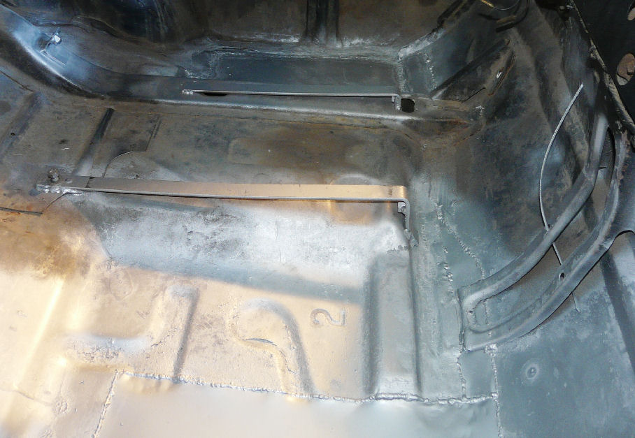

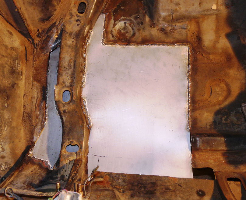

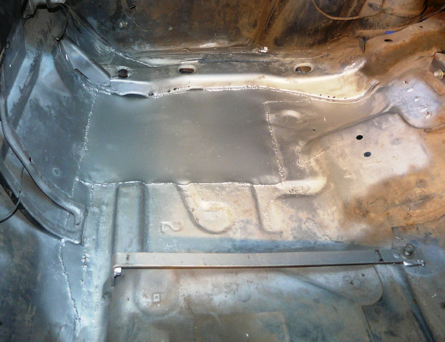

it seems like weeks since i last had time to work on the car!! logged a good solid few hours tonight while the wife was at painting class!
finally got all the rusty bits removed from the floor pan in the boot and got stuck into template making for the replacement panel.
got probably 70% welded in tonight so pretty happy with the progress!! makes the boot feel much more complete now!!
sore back after leaning over into the boot for like 40 minutes!

its nice watching someone online do shit properly for a change LOL nice job man
yeah its funny you should mention that, when i started cutting the rust out on the back section where it curves up from the floor i was like WTF, dust and shit everywhere .... put the wire wheel on the grinder and no joke removed close to 10mm of bog ... looks like previous owner has just bashed the rust area in and put a big layer of bog over it all .....
makes me wonder though, cause the car has a really good paint job so i reckon the paint shop could have done it!

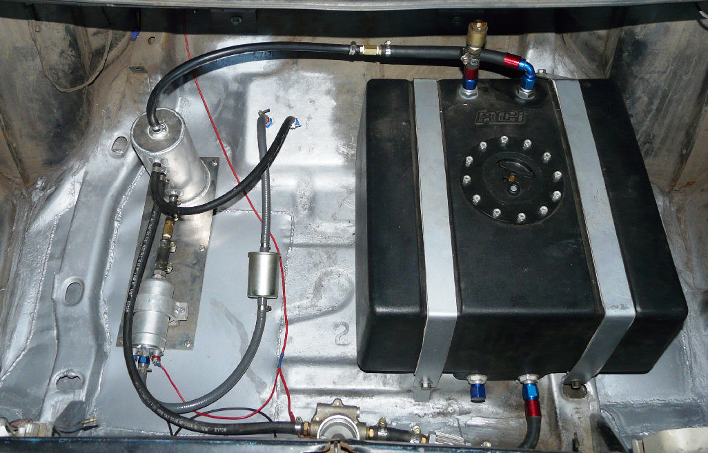

finally patched up all the rusted bits in the gemini boot and got it all back together ...... so far its just painted in cold gal to stop rust, and i also need to do a heap of grinding on the welds at the back .... but its good to have all the holes gone!
i wasted no time in getting the fuel system back in the car so i could get it going
also fitted my boost gauge which just arrived on friday, at the moment it only uses the vaccum portion of the gauge but all in good time

Good to see the cheese has gone.
I use a rust converter primer it has worked well for me.
And in boots i use that stone gaurd under body sealer crap it comes in an aerosol can now and covers up a lot of imperfections welds etc with the textured finish makes em look all pretty again.
