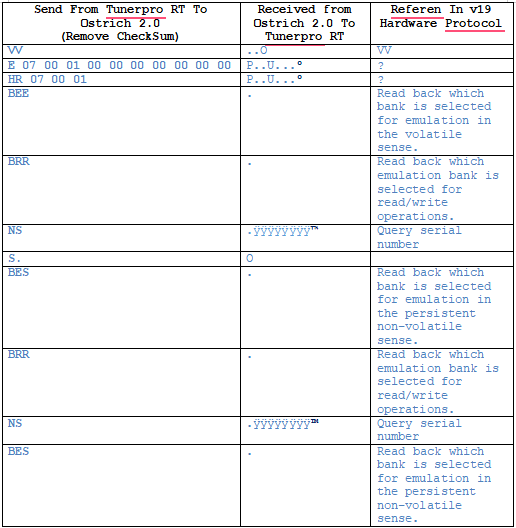

And here is ostrich 2.0 serial data capture, maybe help anyone woking on DATA Trace in tunerpro RT.
#Update with Address Hit Tracking serial data capture
https://www.mediafire.com/file/98j4gth8 ... e.pdf/file
***Some command need to send in hex, it wont respond with ostrich if send in string / ASCII
Ostrich 2.0 - v20.9 usb hardware id
FTDIBUS\VID_0403+PID_6001+A506XGLFA\0000
FTDIBUS\COMPORT&VID_0403&PID_6001Code: Select all

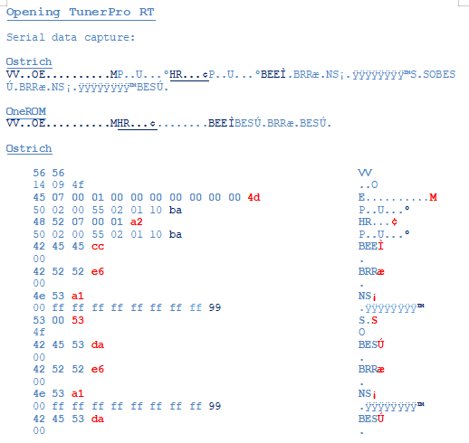

Opening TunerPro RT
Serial data capture:
Ostrich
VV..OE..........MP..U...ºHR...¢P..U...ºBEEÌ.BRRæ.NS¡.ÿÿÿÿÿÿÿÿ™S.SOBES
Ú.BRRæ.NS¡.ÿÿÿÿÿÿÿÿ™BESÚ.
OneROM
VV..OE..........MHR...¢........BEEÌBESÚ.BRRæ.BESÚ.
Ostrich
[17/07/2026 23:12:37] Written data (COM43)
56 56 VV
[17/07/2026 23:12:37] Read data (COM43)
14 09 4f ..O
45 07 00 01 00 00 00 00 00 00 00 4d E..........M
50 02 00 55 02 01 10 ba P..U...º
48 52 07 00 01 a2 HR...¢
48 52 07 00 01 a2
42 45 45 cc BEEÌ
00 .
42 52 52 e6 BRRæ
00 .
4e 53 a1 NS¡
00 ff ff ff ff ff ff ff ff 99 .ÿÿÿÿÿÿÿÿ™
53 00 53 S.S
4f O
42 45 53 da BESÚ
00 .
42 52 52 e6 BRRæ
00 .
4e 53 a1 NS¡
[17/07/2026 23:12:38] Written data (COM43)
42 45 53 da BESÚ
[17/07/2026 23:12:38] Read data (COM43)
00 .Code: Select all

If you need to understand the trace look for Moates Hardware Protocols v19.xls

themr.m
- Posts: 18
- Joined: Sun Jul 05, 2026 6:42 am
- cars: EK3
Re: OneROM
Refer to Hardware protocol v19
(CS) mean Checksums are just 8-bit additive of the rest of the request, no carry.
Example : Query serial number >> N+S+CS
So, CS for NS is A1(In hex) which is ¡
Converter:
https://www.rapidtables.com/convert/num ... erter.html
Checksums Calculator:
https://www.scadacore.com/tools/program ... alculator/
Breakdown command:
https://www.mediafire.com/file/js73kf22 ... d.pdf/file
Converter:
Breakdown command:
