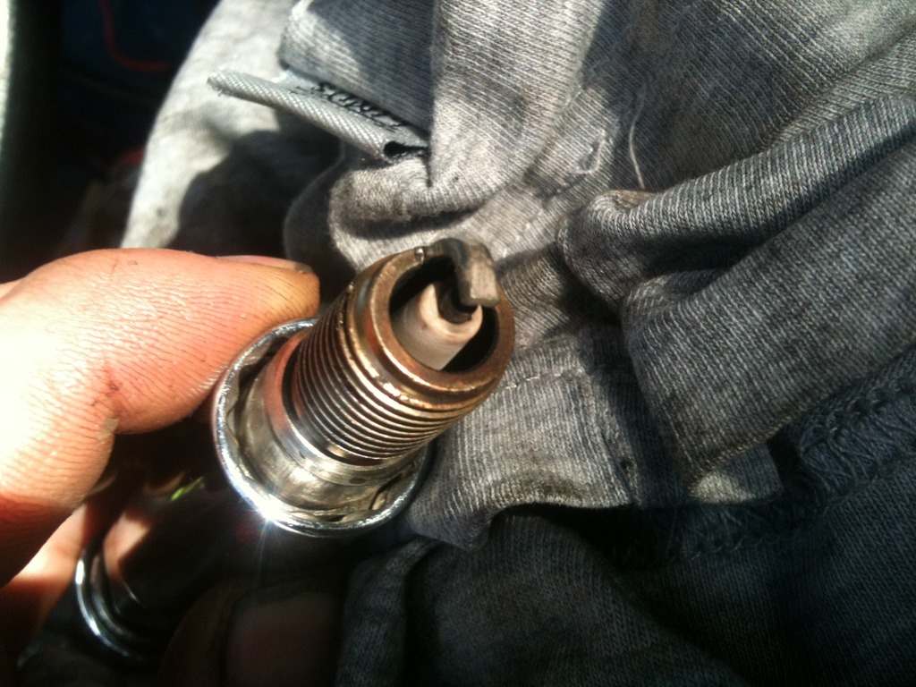

So I set the top end at 12.8 AFR and also backed off the timing 2% as there was evidence of detonation on the plugs but not sure if that from the previous tune.
So I cleaned a plug til shiney like new, did a 20K run, pretty hard.
looks ok to me. porcelain has a bit of grey and tan and the ring of the casing a brown colour. Strap although already set from the previous running shows the plating discolored to the bend, just slightly past.
Still goes pretty good, the VE table is now quite stable.

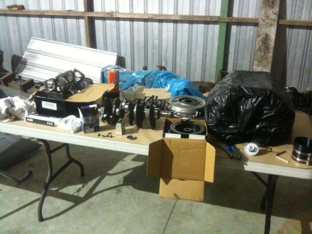

Some engine porn time!
Go the bits back, what workmanship!
Very very clean.
Setup a table for all the bits.

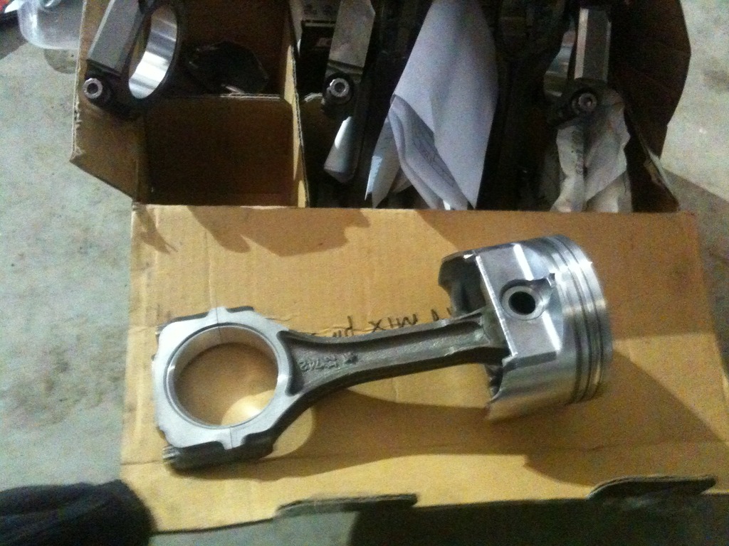

high comp Nason (ACL race series) piston, resized rod with ARP bolts.

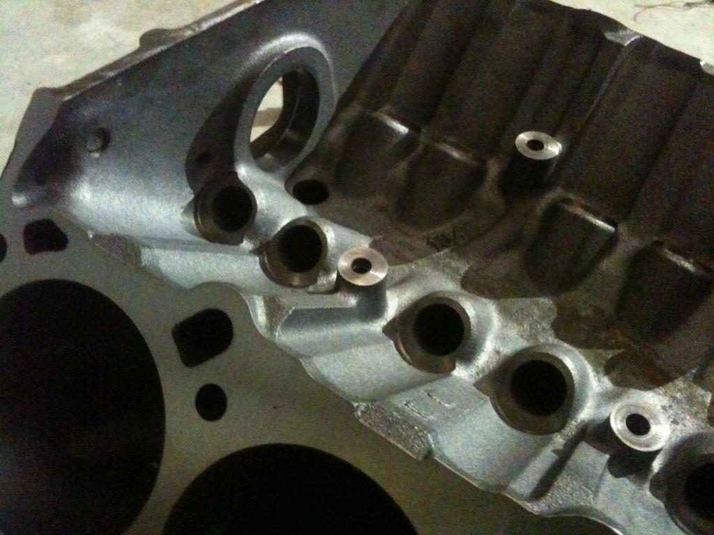

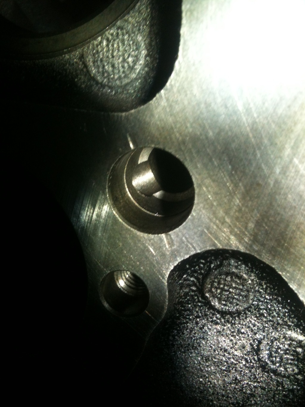

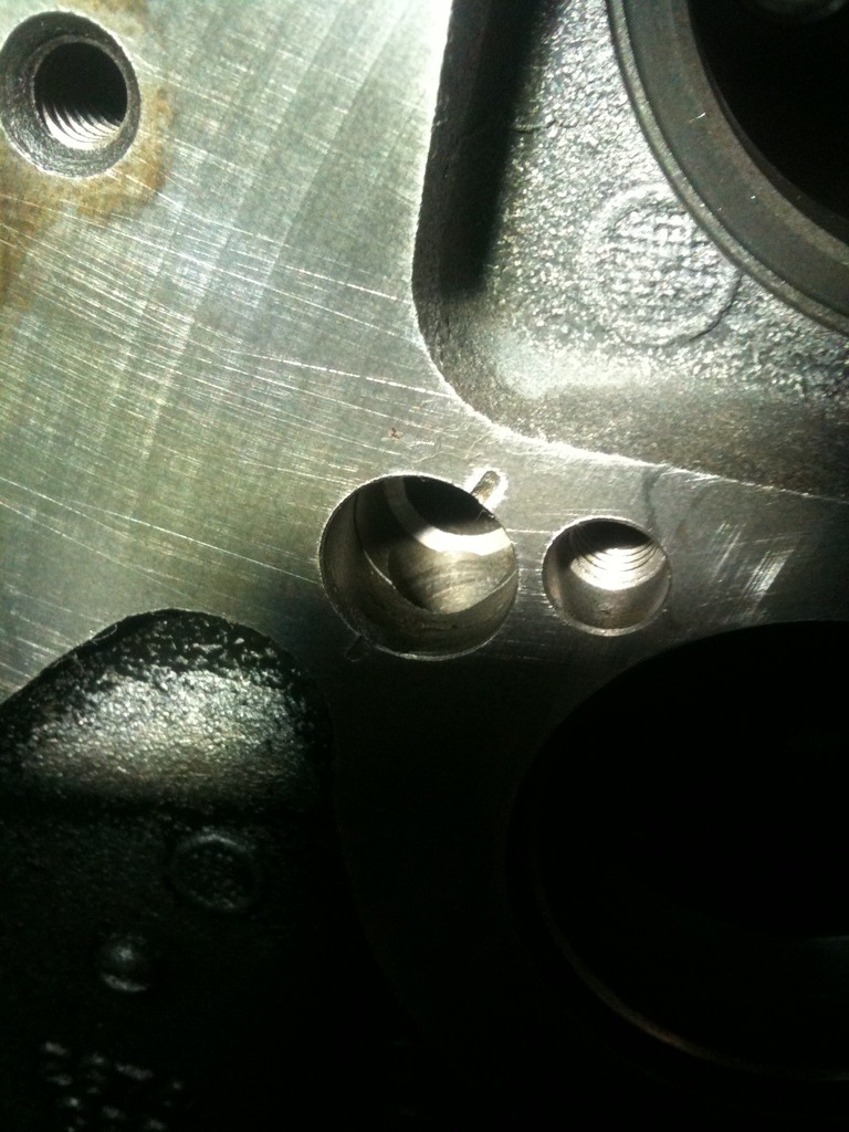

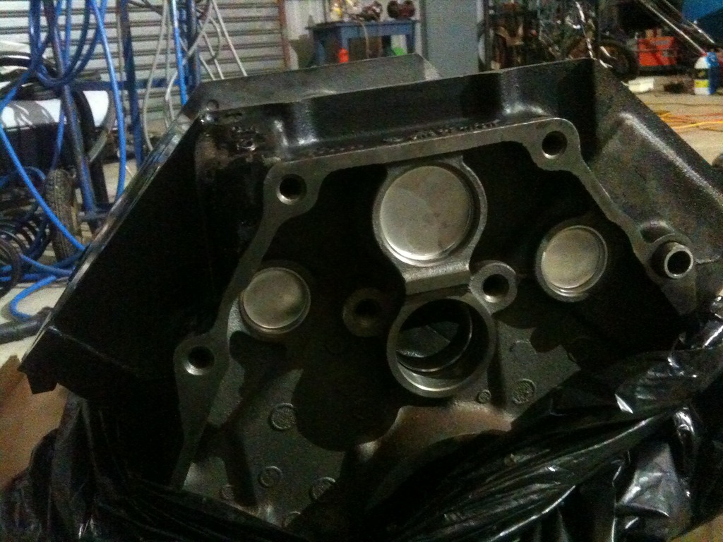

Had all the jig points drilled at tapped for use of flat response knock senors for when I hit the dyno. Much better spots than using the back of the heads.
Not too keen on reusing the old mini welsh plugs as they are an odd size and hard to get, So im looking at making some alloy solid plugs 14.75 x 8.5mm and bang them in with some loctite and peen the edges over like original, the cam thrust place also covers them so be a solid solution over using old loose welsh plugs.

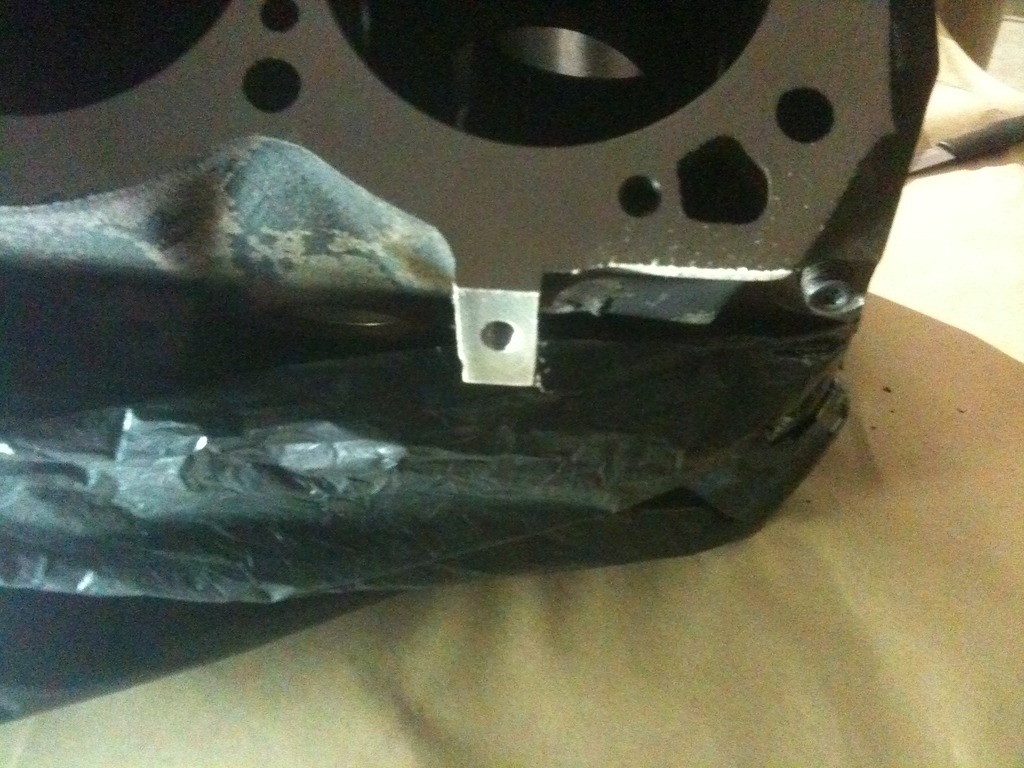

Everything balanced easy to 50% except the excedy cover which needed a weight welded to it lol. That might be Biggvl's complaint on them vibrating haha. Anyway, all good now.

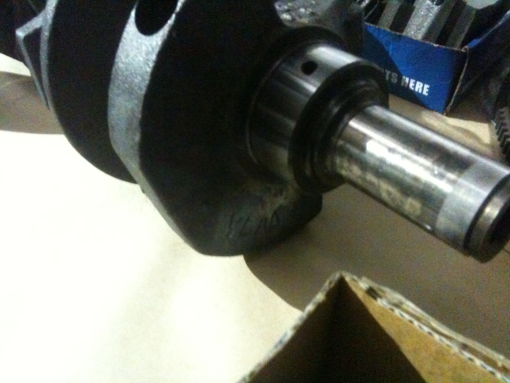

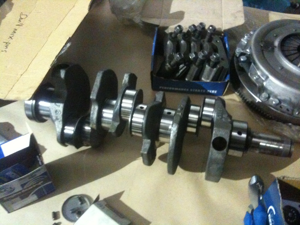

Duggan's installed King bearings for the rods and cam, ACL duraglide for the mains. Good stuff!

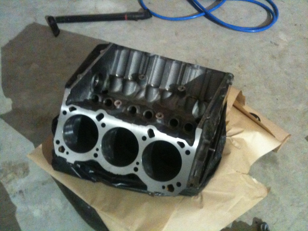

Had the block decked, bored 20 over, honed, tanked, line honed. Crank polished, rods resized and ARPs, balanced to 50%. New bearing all round. Fully blue printed and labeled for assembly.
Owes me $1800 odd for all the work and supplied parts. Not bad at all really.

the drilling and tapping of the block for the knock sensor is a great idea, well done :thumbup: :thumbup:
yeah I agree!
