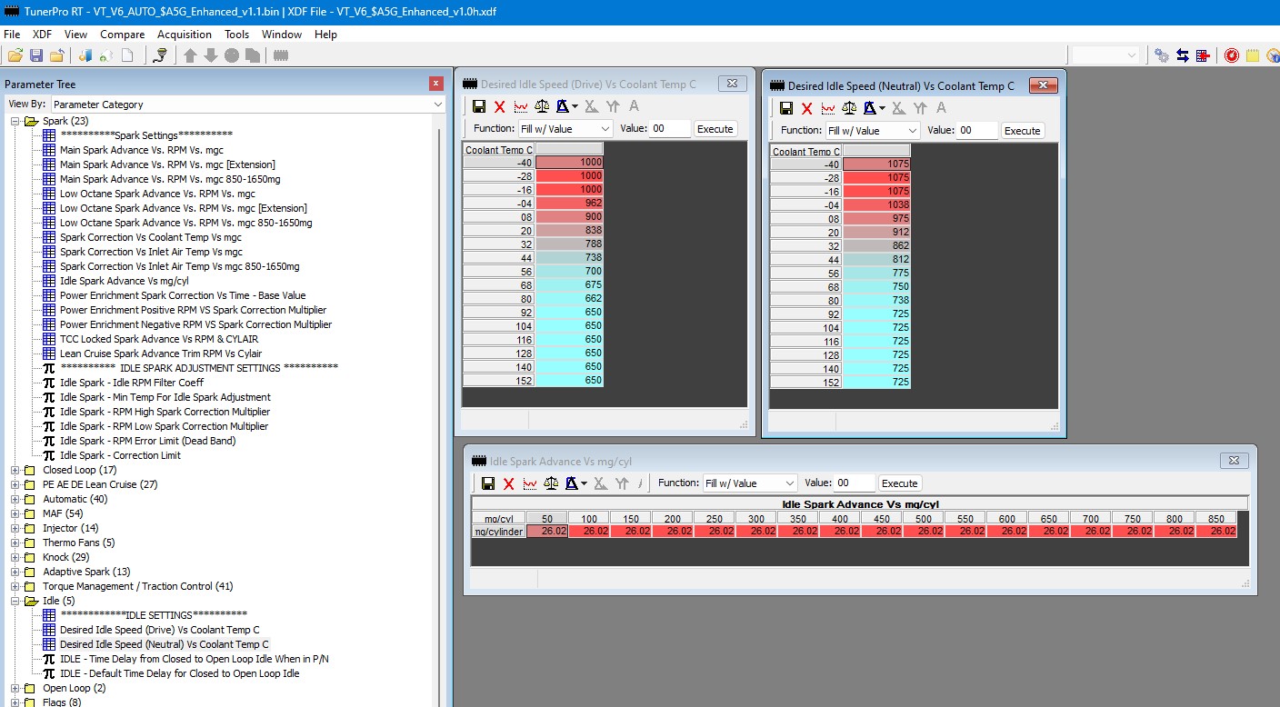

Idle spark table and other idle spark settings are in there already. Idle RPM has P/N Adjustments, spark doesn't. It's not a thing.

There is only this and when it's in park or neutral it pulls about 10° vs when it's in gear
Posts: 4853
Re: VS-VY Enhanced Factory Bins
It'd be the idle adjustment scalars, change the min temp one out of range and see if it works
Posts: 3823
cars: VS,VT,VX,VE
Kevspec wrote: Sat Mar 08, 2025 10:57 am There is only this and when it's in park or neutral it pulls about 10° vs when it's in gear
Are you sure? I noticed a similar things when in P/N but to me it looks like the timing is showing about half of what is in table. I almost wonder if that is a problem within Tunerpro.
The PCM will also adjust the timing to control the idle.

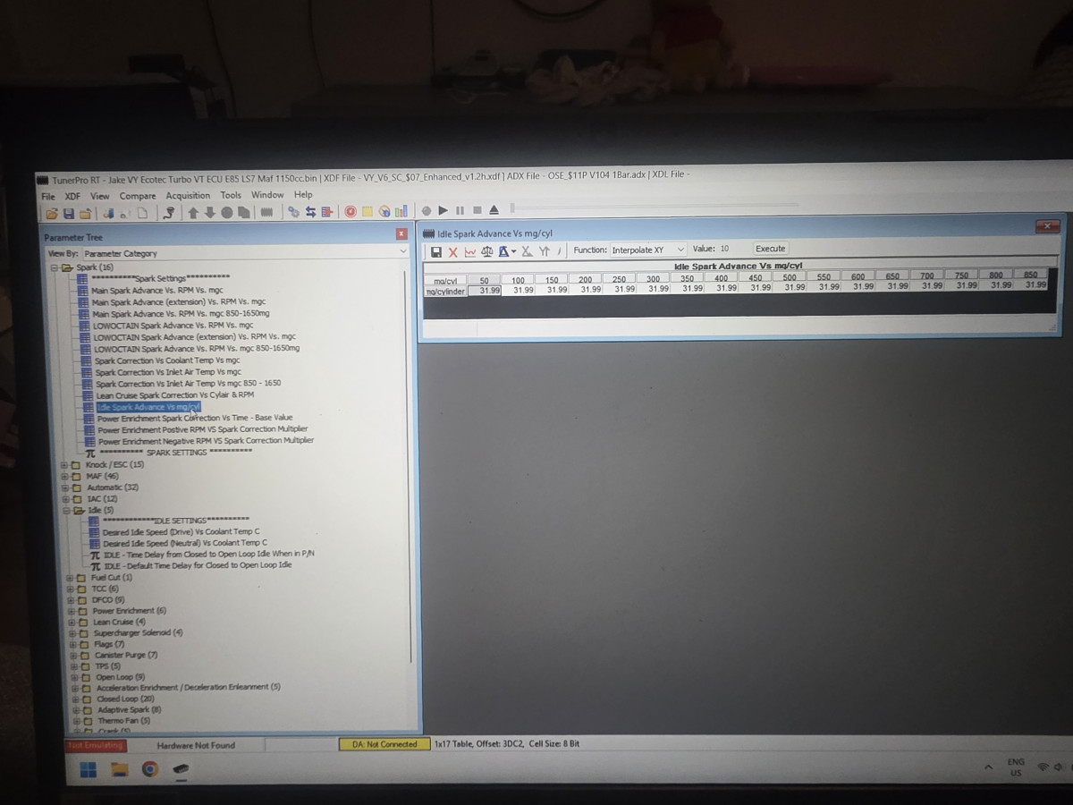

Yeah I had the same issue, no defined table showed why timing was being altered.
I gave up and just tuned around it.
