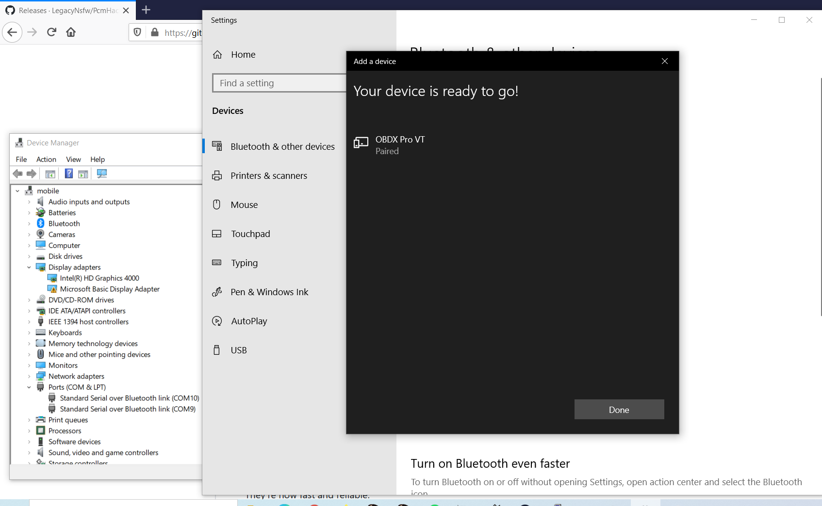

My laptop is a Toshiba, but my wife's laptop is a Dell, and get basically the same behavior on both, except for the numbering of the COM ports.
- Posts: 10111
Re: PCM Hammer P01 and P59 flash tool v015
@tazzi - that link specifically says Toshibas only provide one port with their own stack, so thats why your not seeing the same. If you can you might need to fire up a W10 VM, and use vmwares BT passthrough. That might maybe kinda give you the same behaviour, but with a virtual shared BT port, so whether its useful or not, hard to say. Maybe Toshiba didnt do the same across all models.
- Posts: 10111
Well I went around to my workshop after my day job with my tuning laptop and put the xpro vt through its paces. Lets see what Tazzi says, but it looks like it might be a hardware problem after all that. But I think we still need to test with lsdroid to confirm. Mine works with lsdroid and pcmhammer on win 10 with 2 com ports (using the first one). I guess the 2 ports is a windows oddity on the stock non-oem BT stack thats no more than a red herring.

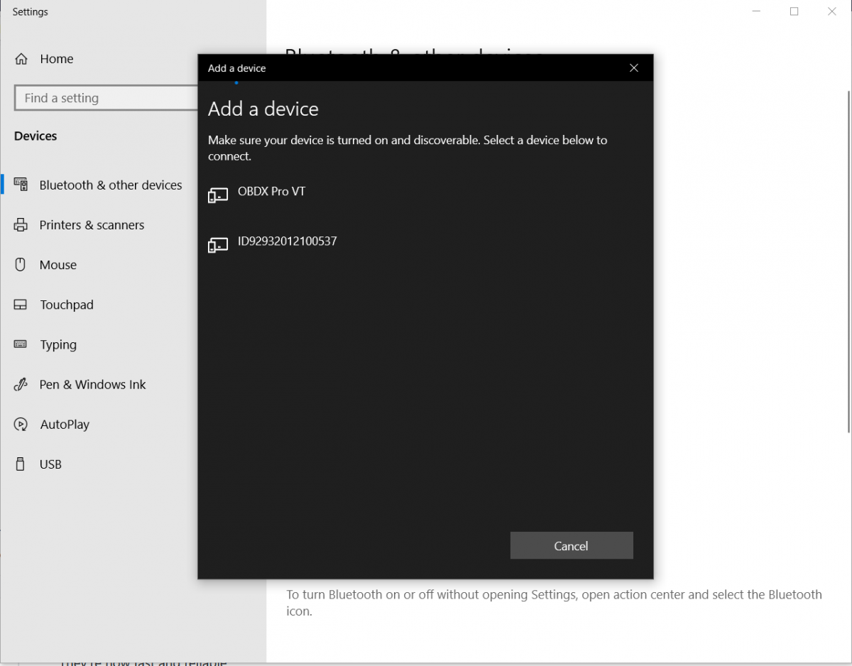

Ok so I have managed to get the same issues that draz is getting.
The bluetooth works perfectly on my android device, but my windows installation is having problems.
So, windows pairs, but then instantly disconnects from the device. I can tell as the blue LED goes back to flashing quickly. When then using pcmhammer with either comport, it does into appear windows tries to reconnect to the device.

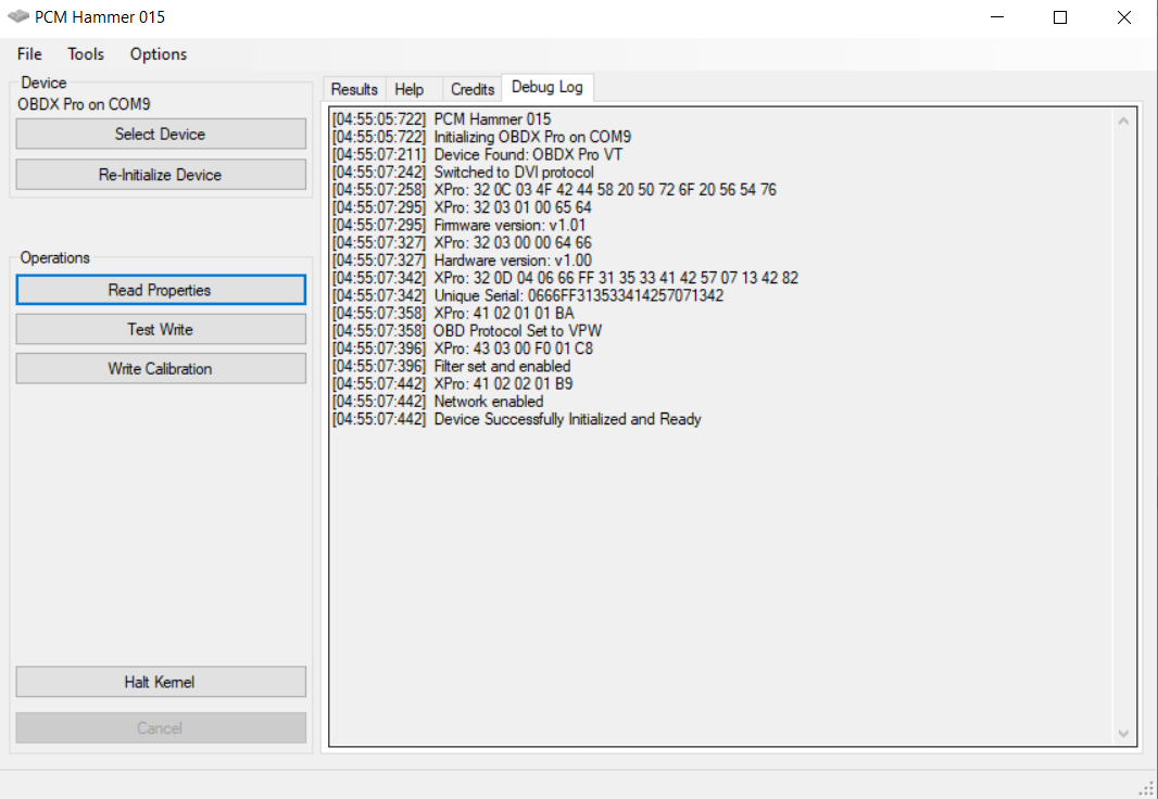

Ok so after about 20 attempts, finally got windows to actually connect then read with pcmhammer.
So, I paired up then entered the pin when prompted. I then disconnected the OBDX from the OBD port, then reconnected and in PCMHammer I selected the Bluetooth comport thats associated as the OUTGOING bluetooth connection.. and it seems to have connected.
I also set my computers bluetooth to "discoverable" and "allow bluetooth devices to find this PC".
I cant get it to work any other way, app either hangs or crashes.
*Edit
I have to repeat that exact process every single time since windows doesnt seem to just reconnect.

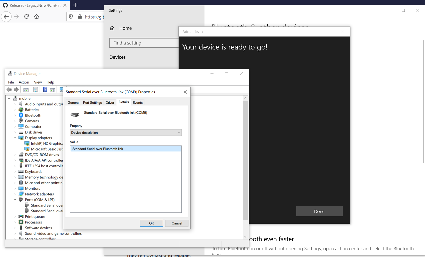

Wow so its a Windows race condition over which port is which when starting up with two! ugh... Microsoft... And if we are to fix it properly and support windows we'll need to find a way to identify which port is which and find the device. Or maybe scan all scannable com ports and see which one answers as the device. Auto hardware detection would be nice but it wont be the smallest change.

Update: I note that I now have COM3 as incoming, COM4 as outgoing, the opposite of what it was the last time I checked, so confirming the COM initialization race condition idea.
