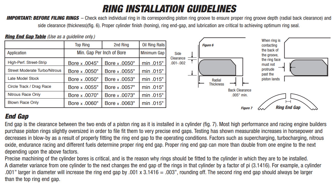

i've heard of this happening in LS motors as bit, this is what i used for my ring gaps.
ring gaps.jpg (380.94 KiB) Viewed 4172 times

Holden202T wrote:i've heard of this happening in LS motors as bit, this is what i used for my ring gaps.
Thanks Sam, I will definitely use that. Using my bore an increase of 0.004" of ring gap looks about right assuming the ring gaps aren't too tight to start with.

Re: 265 Hemi to efi
Did that sheet come with ACL pistons? sure looks familiar :thumbup:
Re: 265 Hemi to efi
nope got it with my SRP pistons.

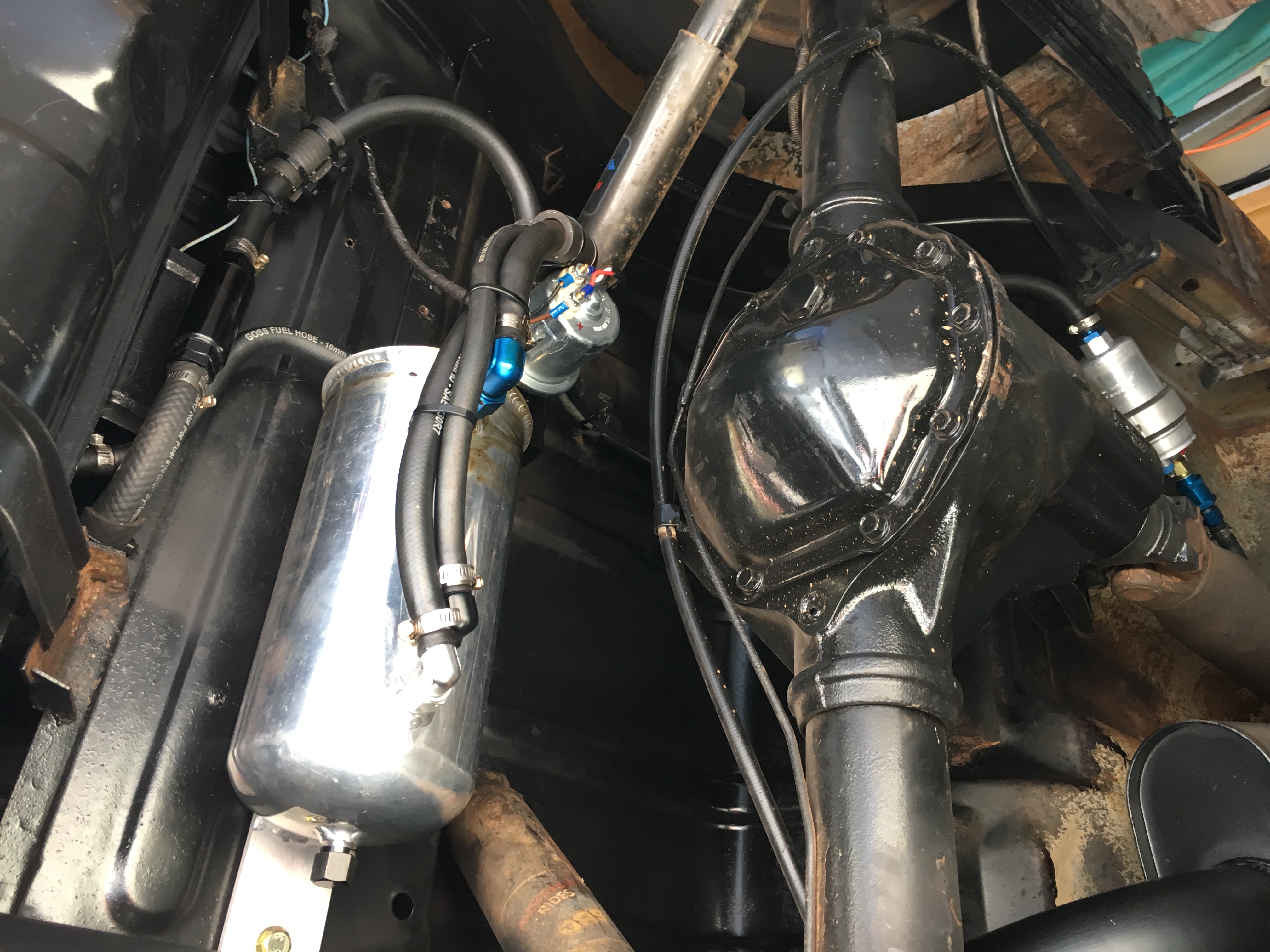

Got the motor out and the pistons are intact and the bore is ok. I will take the pistons out tomorrow and see why there was no compression in cylinder 3. In the meantime here is a pic of the fuel system with th3 surge tank installed.
