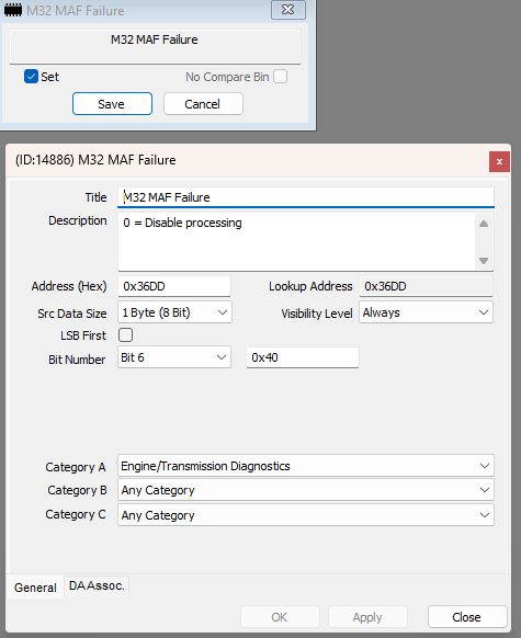

Is anyone able to give me a pointer in adding in the DTC 32 to mask it in a VX L67, managed to find all the others.
Have wired in a Haltech 2500 into a customer car that has to go over the pits.
Last DTC/Engine light that is popping up as far as I'm aware.
All the XDF's I can find for VX and VY L67 they skip past DTC 32 Maf Failure
Cheers
Cheers
Wade
- Posts: 1229
Re: VS-VY Enhanced Factory Bins
Try that

Wade
- Posts: 1229
Awesome mate. Thanks for letting us know
