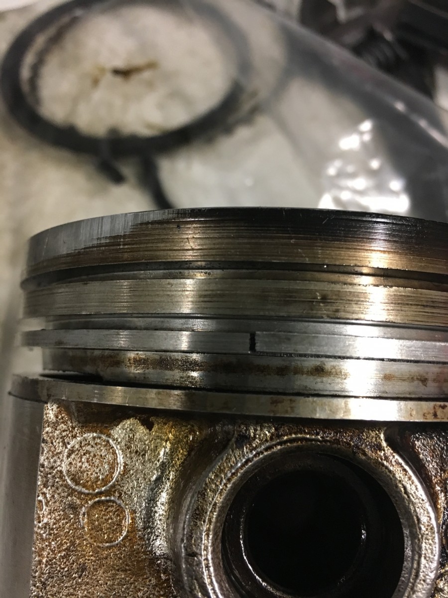

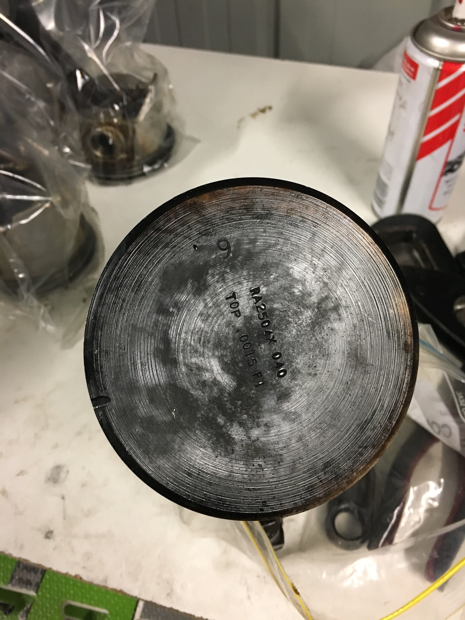

Thanks guys, I will post some more pics of the carnage soon. I reckon there was just one piston that couldn't hack the pace and maybe the rest weren't far behind. Anyway it just might be that the forged piston, mains cap girdle 265 with 904 Torqueflite may be coming into service earlier than expected.

Oh aftermarket cheese it looks like it's been cocking over in the bore looking at the top edge of that piston
Re: 265 Hemi to efi
it definitely doesnt looks lean

Hey there heff0018,
Well the damage does not look bad so saving of a motor might have happened.
While it is hard to say that it was caused by over expansion of the ring and binding, there is that possibility. Your other option is that the ring lan itself was too wide for the ring and therefor the ring would beat the lan support to death.
All in all the piston and thus the motor has been rebuilt in the past. I would be steering away from pistons of this construction as the oil lan is weak with the slot in it. Even if the lan had not given up you might have lost a piston crown eventually due to the weakness prebuilt into the piston. It is just the way alot of factory pistons are and thus because it is cheap to manufacture this way they will use it. Try and make sure your new pistons have drilled oil lans.... like below.

Re: 265 Hemi to efi
Thanks for that, interesting.

I checked all the other pistons carefully and there is no other obvious damage. The JE pistons I am looking at have the drilled oil lands

Awesome, top piston failure will be a thing of the past. Make sure you gap your rings properly and also make sure the lan gap to ring is within tolorance. Personally I will only use hastings rings and king or hasting bearings.heff0018 wrote:I checked all the other pistons carefully and there is no other obvious damage. The JE pistons I am looking at have the drilled oil lands

Re: 265 Hemi to efi
The lan to ring gap is something I haven’t considered before but will be checking from now on. With change in piston weight I thought balancing The crank would be required.
