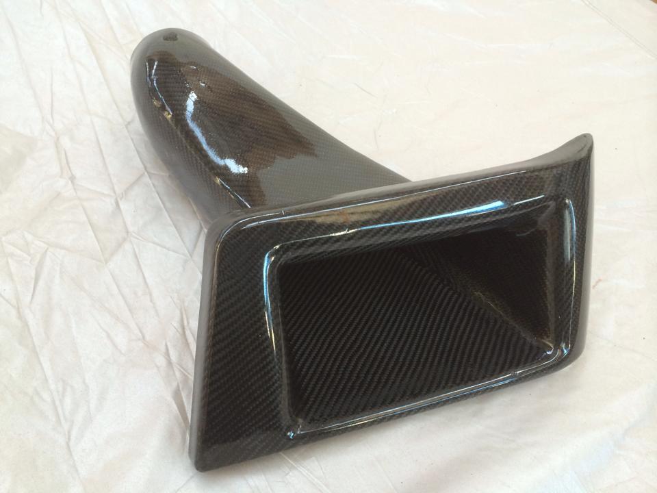

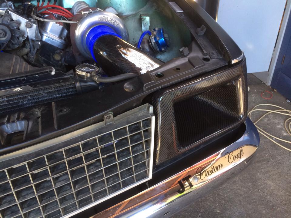

couple pics of the carbon fibre goodness the vb got a couple of months back
