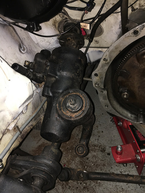

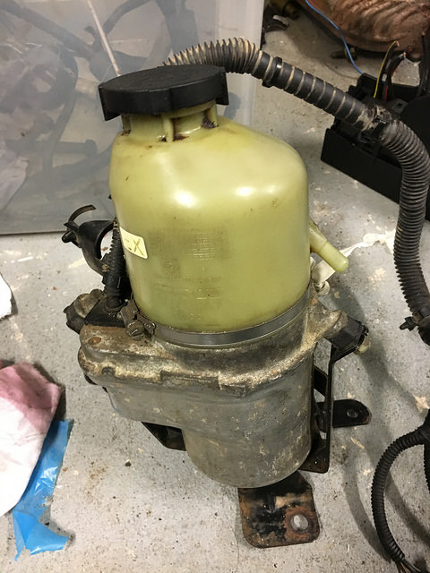

The manual steering has been pissing me off and is the worst part of the car. Its heavy slow and sloppy and so while the motors out I am installing power steering with an Astra electric steering pump. The inner guard and length of column shaft is different for the power steering models so a little panel massaging was required to fit the larger Chrysler power steering box. I swapped the column shift column for a blank column with the shorter p/s shaft and the rag joint was also a pain in the arse but the box is now in. I also bought a 120 Amp alternator which is the same size as the Astra unit.

Re: 265 Hemi to efi
Post by Mechcano »
Heff0018
The factory cut out the inner on power steering cars, this is a V8 car.
I'll be interested to see how the change to power steering works out for you, because personally
I think that power steering box is one of the worst ever made, it is very light and has virtually no road feel
or feed back.

Post by Charlescrown »
I remember the days as an apprentice when I took out a Valiant for a test drive and having exceptional driving skills (at the time) either coming close to hitting the gutter or spinning out on corners due of course to the wonderful power steering. They need a slightly thicker torsion bar in the steering box control valve but I don't know if anyone ever made one.
