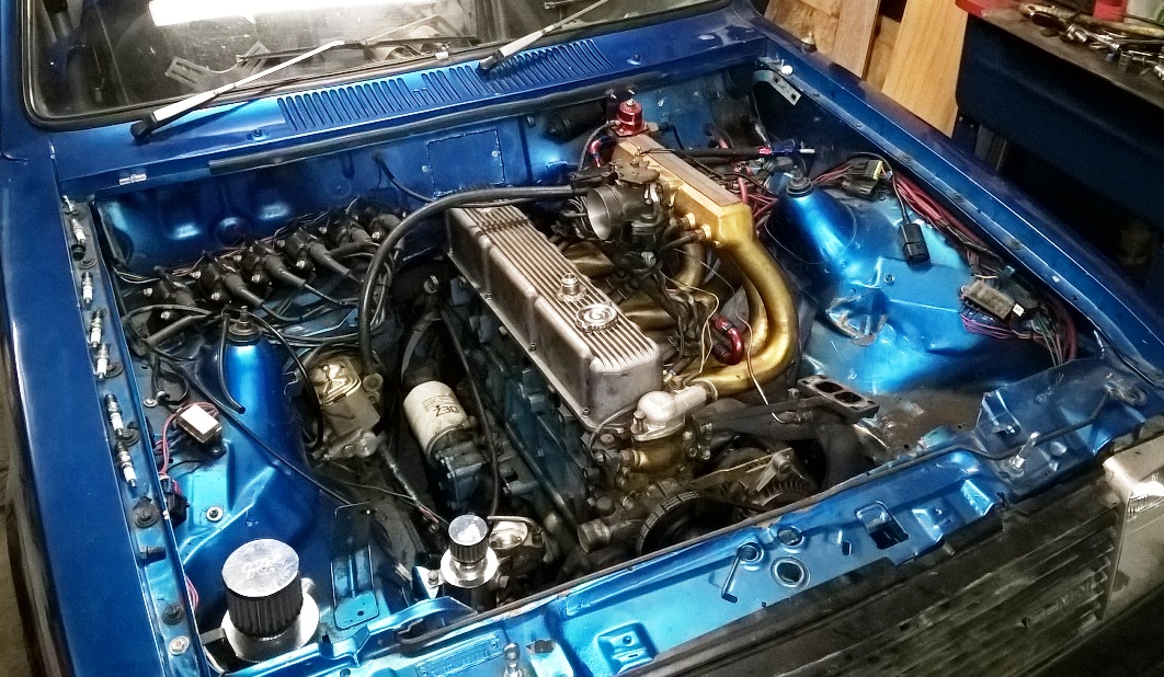

Got that 2 step working very well now, launches way better with some boost in it! Sure did get a little squirrelly.
Re: My Delcoed Rides
yeah it is working awesome now!!
things getting back to normal ;)
bog stock 202 putting in there to allow the car to be complete and movable..... who knows might see how much boost a stock 202 can take he he he :)

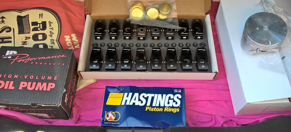

And so begins another motor build :punk:
kinda on a limited budget so getting bits and pieces month to month as I need them....
next step is get the block bored and then I can throw it together for dummy assembly of one cylinder to see the deck heights, once I have that i'll know if I need to machine the tops of pistons to lower the comp or deck of block to increase it!

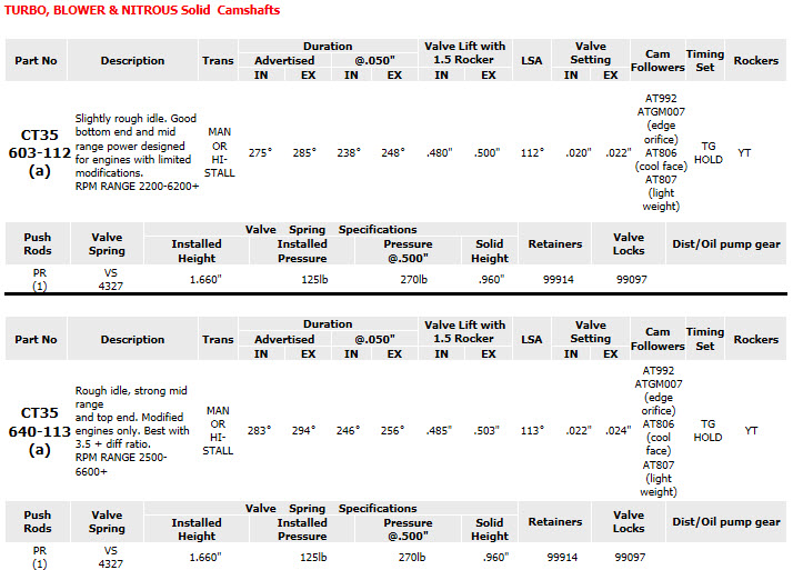

also thinking about cams, the one at the top is what was in my N/A motor, now in my brothers car, its got good rpm range, but thinking the bottom one might be better :twisted:
