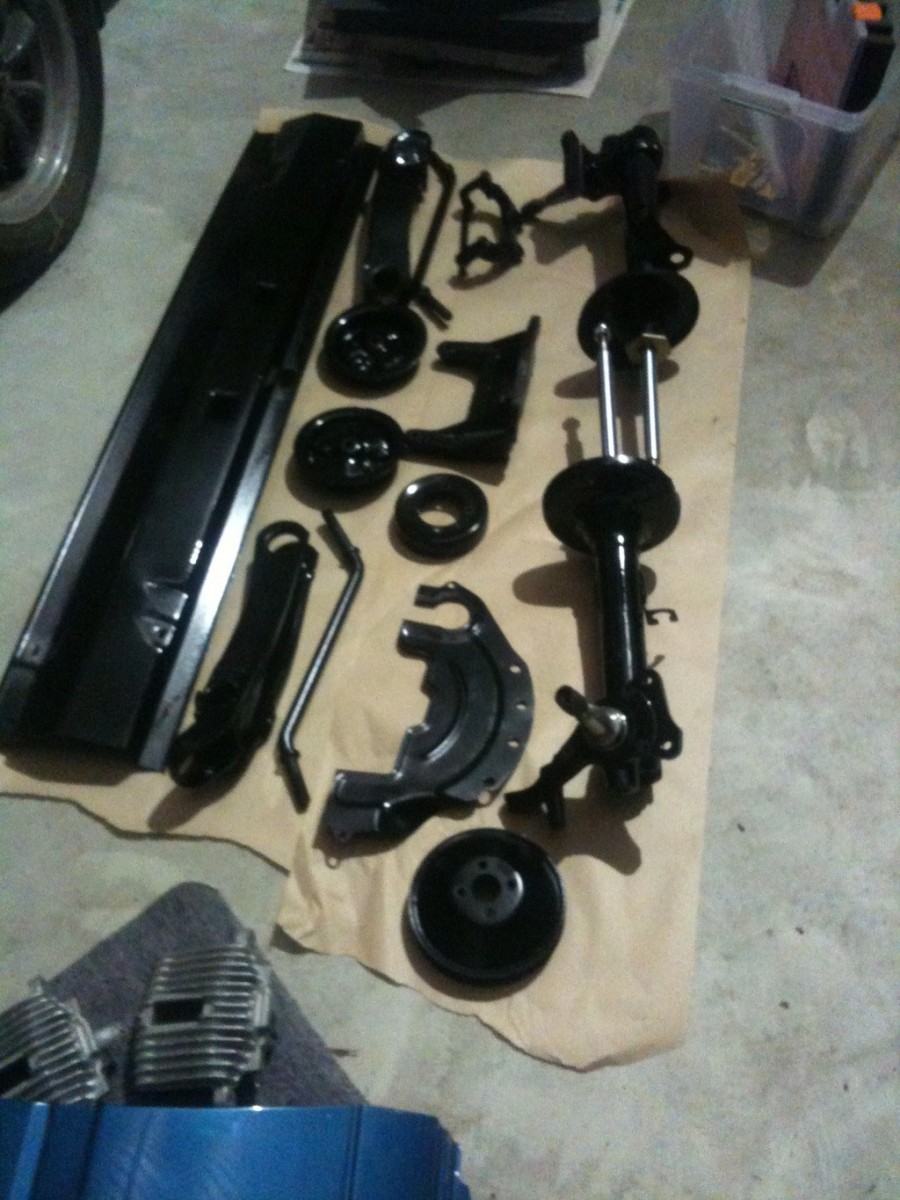

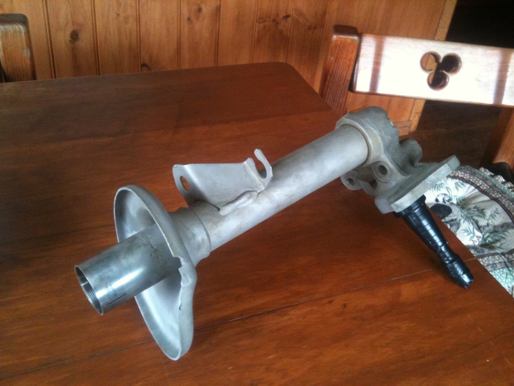

I just hate leaving things bare metal unless they are plated or 2 surfaces are being mated. It was clean as a whistle in there already from when I picked up the block so was not real effort to give it a few coats.Holden202T wrote:geez now your getting fancy!

few days ago, ready to paint.
bit later, my collection of bits.
