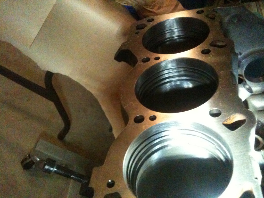

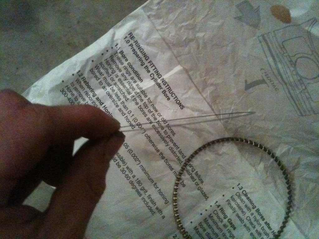

Just checking over stuff atm. Did all my rings. Duggan's did check and mark the rings that were critical, the top ones and said all unmarked rings checked ok in any bore.
So I went and double checked. What they marked was really good and consistent. I went and applied the same ring to bore mix/match to get the largest gap and best consistency. So my gaps were all bang in the middle of the tolerance range for the minimum gaps measured, all other rings were a tad more but still in the middle range.
These oil rings are supper thin. I had trouble measuring them as the slightest touch with the feeler gauge moved them out of place. Breathing on them almost moved them lol.
So my biggest minimums achieved is this. Pretty happy with that.

also with the buick oil rings, your not wrong they are wafer thin hey!
