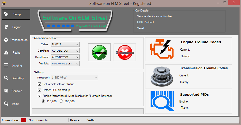

After some long.. painful.. programming sessions, Iv done some massive changes to routines and how things are handled. ECU and Trans are checked on startup. If trans does not respond to the "Are you there?" message, it is assumed car is manual and all transmission data is disabled.
Ill be doing some major testing over the next few days and hopefully all functionality has been maintained.
- Posts: 3627
- cars: VE SS Ute
- Location: WA
Re: Software On ELM Street - OBD2 Software Development
Due to the large changes, the next update may not have AVT support enabled. The MX 'may' be supported.
Primarily I am ensuring that all previously working function are still working.
Mainly the engine data reading has been restructured, engine data is to selected before reading and that data can be chosen to be displayed on any of the gauges. And all data can be viewed at once in the listview. And my new favorite graphing feature has also been implemented.
A 'beta' save/open should be hopefully finished soon to replay live data back.
