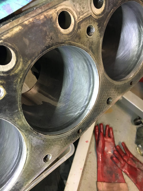

I honed the cylinders for the new Endurotech pistons and moly rings that should show up during the week. I wish they were forged but budget restrictions have taken over. I am just going to slap this one back together with some new ARP bolts and press on.
I think I have got a 45 degree cross pattern. I ended up slowing down the drill speed and speeding up the in and out action.

traditionally I was trained that cross hatch should be approx 30* to the horizontal. Having stated this by the look of your photo this has been achieved
Have you measured the cylinder bores to make sure they are not hourglassed? If they do change thickness then the rings will change as they move up and down the cylinder which is not the best thing. What tool did you use for the hone? Generally I like the dunny brush type over the three jaw variety as it will not bell the top if you dont have a torque plate bolted on.
Make sure before you assemble you grab two rags and some ATF. Place some ATF on the first rag and wipe all cylinders down. You will find that the rag goes black. Then do this again with the second rag. The idea is to make sure all contaminants are removed and there is no grinding stone sand or metal floating around. I will generally then wipe down with metho BUT ATF will not hurt anything in the motor and the first 1000klm's will have a oil dump anyway.
Remember to clean out your head bolt holes. DO NOT use a tap, Best results are grab an old bolt (that is not stretched) your cutting disc on the grinder and cut a slot in the threads and chase the holes with it. Follow with compressed air and do again. A tap can damage threads and I have seen it all too often. My VQ motor is a prime example as I found that one bolt was not right in the head at the motor and it came down to the monkey whom worked on the motor before me chased with a tap. I noticed the small bolts also had issues. One head now has 2 helicoils in it to make the threads work.
One other thing to keep in the back of your mind. Always check your torque wrench before use. If it is not calibrated or a mate has borrowed it then you might be over tightening the bolts. Dont ask, but I know that when you break a head bolt it is a pill to get out.
looking good though.
cheers
Oldn64

Thanks for the advice. The bores are really good, there is pretty much no change in the bore width measuring at different points and there was hardly any lip as such, I reckon this motor hasn't had a great deal of use since it was rebuilt by the previous owner.
I used the three jaw variety but of course no torque plate.
So you don't wash the cylinders with hot soapy water, just ATF? I would certainly prefer an oil based product over water.
That's a great tip regarding chasing the head bolt holes. I am using studs not bolts is this still relevant?
Might be time to get my torque wrench calibrated. .
Cheers
Cheers

When using head studs the thread chase is not so critical as the torque is at the nut end not the block end. But because of my engineering side I would do it as a matter of course, both from cleanliness and state of process.heff0018 wrote:Thanks for the advice. The bores are really good, there is pretty much no change in the bore width measuring at different points and there was hardly any lip as such, I reckon this motor hasn't had a great deal of use since it was rebuilt by the previous owner.
Cheers
Yes use ATF it is a natural cleaning agent and will remove any contaminants. This will remove any protective coating as well if you ever have this done at a machinist. Then the metho will make sure all is removed, and clean. Next valuable tip. Do a complete job, do not stop halfway through a process. For example, if fitting pistons to the block, fit all pistons and torque all big ends. Dont fit half of them and then go for a coffee, this will introduce potential to forget to check something and thus reduce your build to a lesser professional one. The major tip....TRUE all your electriconic devices off so you do not have distraction. I will put "elevator music" on in the background just so I am not working in silence. AD/DC or Metalica dont help concentration
You can do a sudo calibration to make sure your torque wrench is within 1 lbs with maths and weight. I will detail the procedure. From this you can the decide whether you need to re-calibrate from there.
