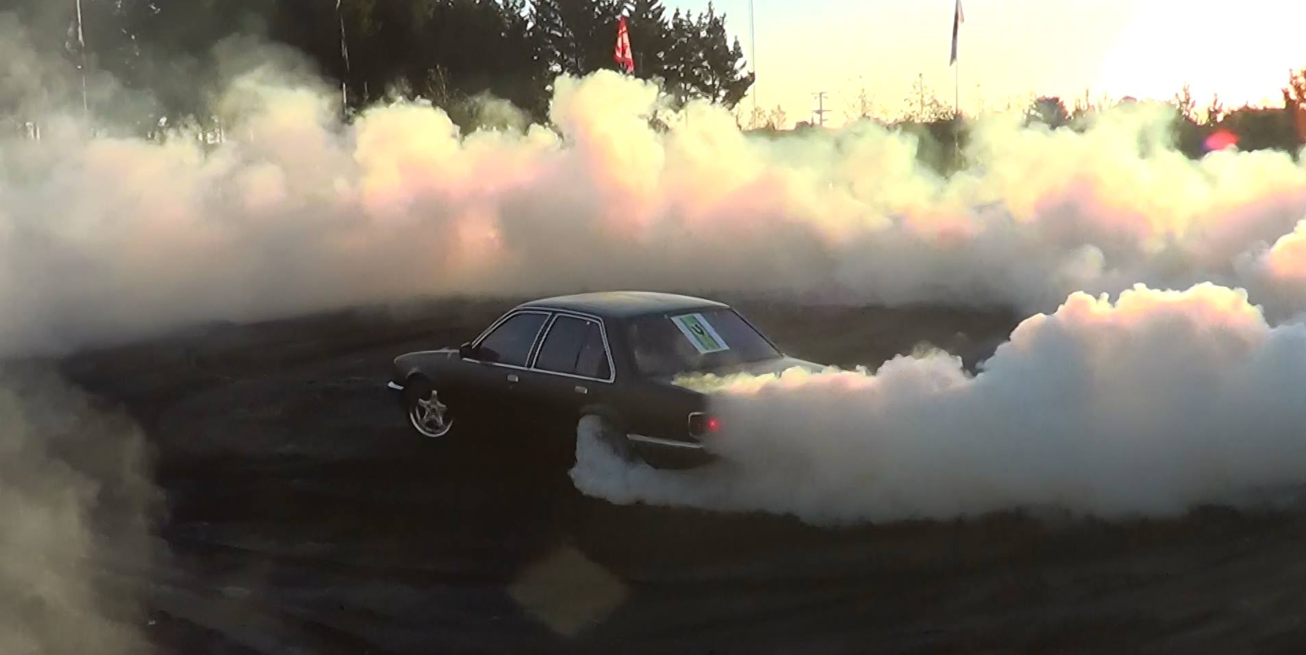

cool pic from the weekend
Re: DELCOS NEW RIDE
a clear pic before the fog set in hehe
Re: DELCOS NEW RIDE
That v6 still sounds so strong, nice skid as always
