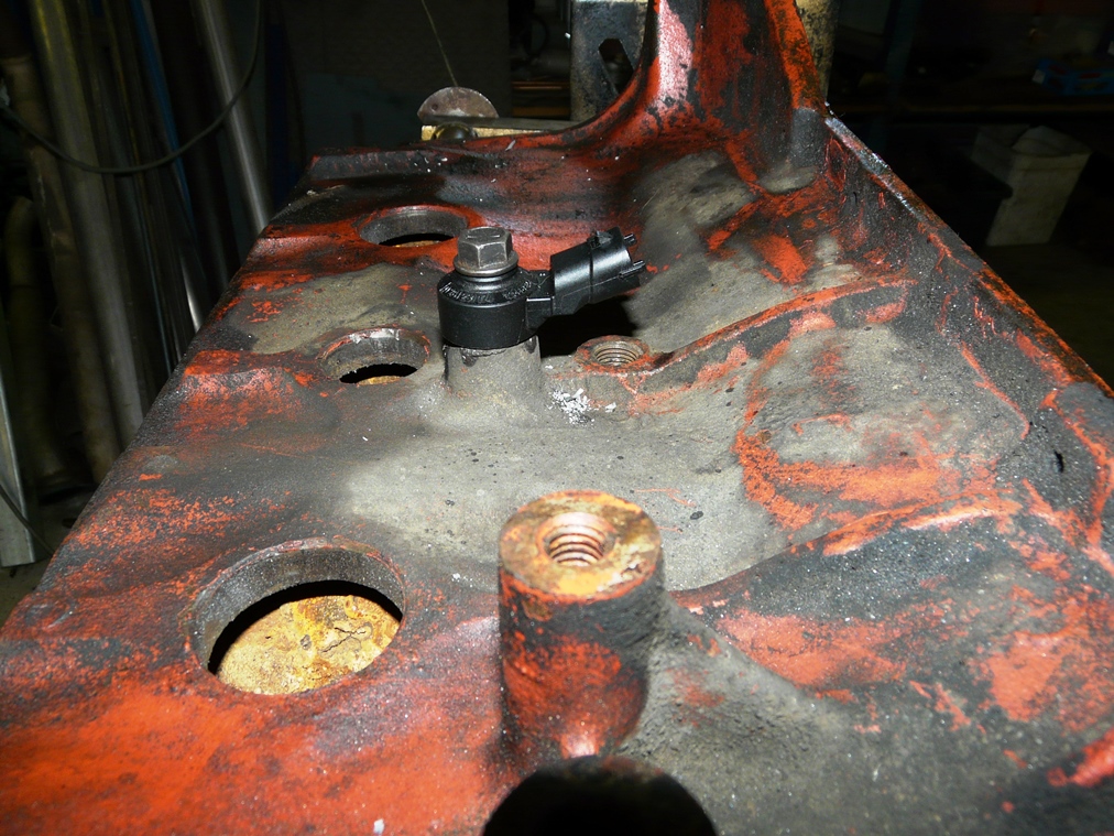

been doing a few things that don't really have much to show for it, like running taps through head bolts holes and such....

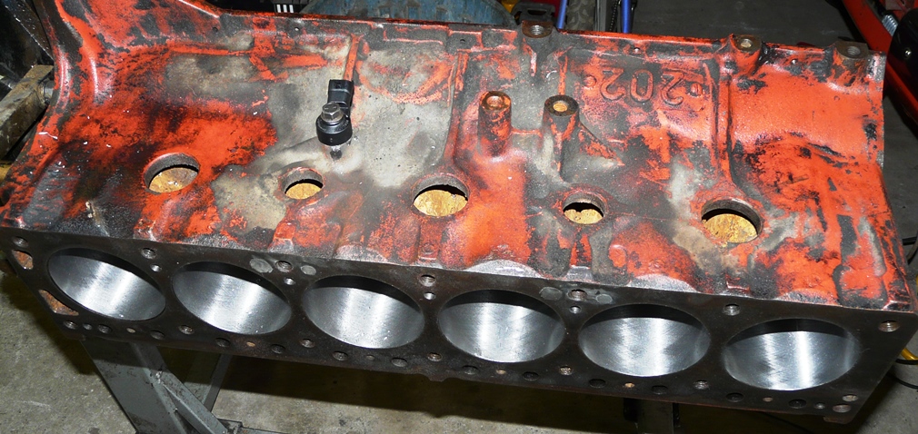

but I also got a few other things done, first off was putting a bolt into a hole in the block, then cutting it off and drilling/tapping it out to suit a smaller hole so I can mount the knock sensor in a spot I believe should be the best option.
it should be far enough away from the exhaust to not cause any issues, and its almost in the middle of the block front to rear, so best I can do really.

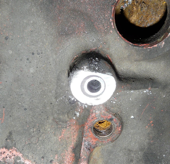

also did some smoothing of the oil pump ports, more so the pressure side (left of pic), it was basically a machined section with a big step in it so I smoothed it into a nice funnel and also took the hole out to match the gasket where I could ... not sure it will make too much difference, but it can't hurt.
hopefully Tuesday arvo will take it to get deck machined and pistons if time allows.

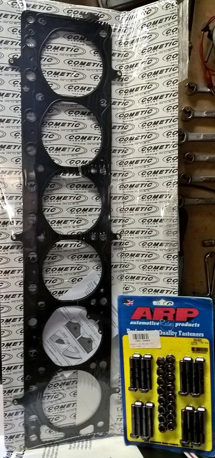

well i've been saying for years that i want to get one of these!! (the head gasket that is)
