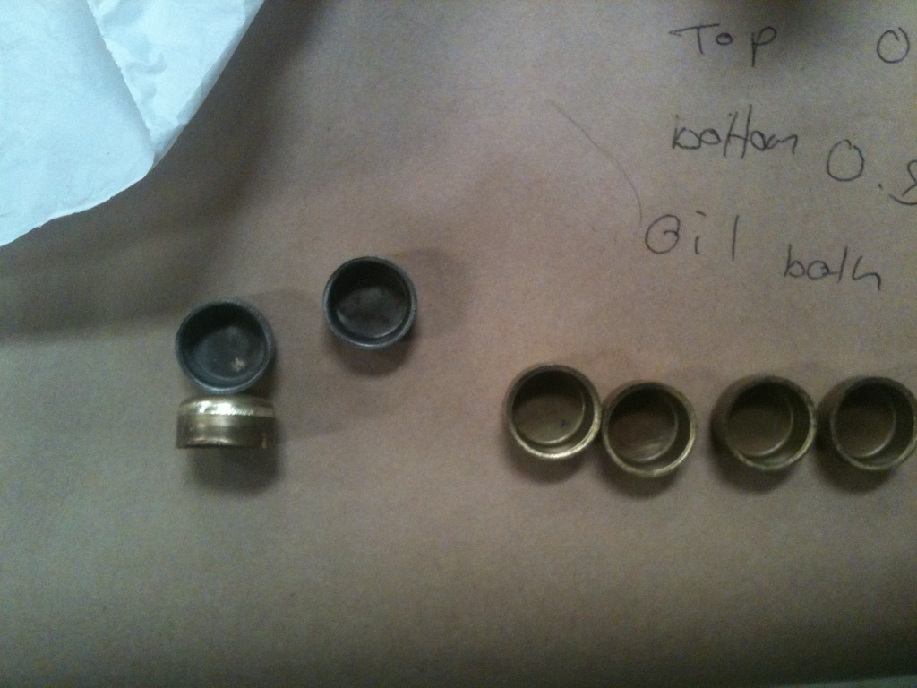

So I got some welsh plugs locally for the oil galleries. They are just standard 15mm plugs, the holes are 14.75mm.
Did a partial test fit and the go in nice and snug without being to hard to get in. Sacrificed one for the test. Got extra for future engines but they are easy to get it seems unlike what Duggan's said. They said to reuse the old ones as they are hard to get lol, being odd size supposedly?
One on the left sideways is the one I tested. Steel ones are the originals.
I've never had an issue getting welsh plugs for the v6's ?
