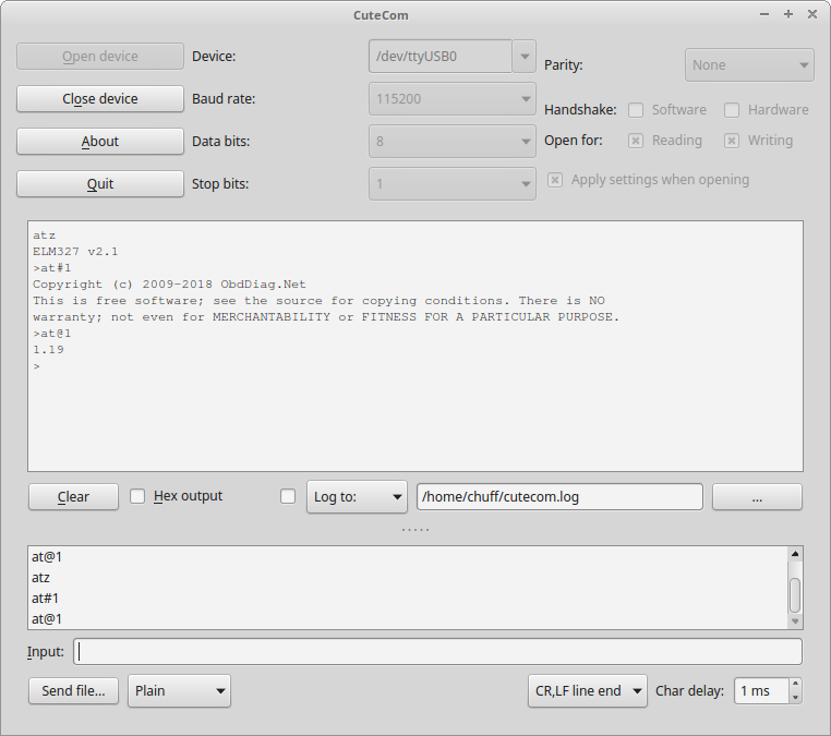

For anyone who might be playing with Linux the commands Antus provided above allowed me to connect & interrogate the Allpro adapter but only after logging in as superuser (su) in the terminal session. Running the commands as a standard user or as sudo produces a "permission denied" error.
Running the commands in "screen" produced the following output which doesn't give me the firmware version:
ATZ
ELM327 v2.1
>AT#1
Copyright (c) 2009-2018 ObdDiag.Net
This is free software; see the source for copying conditions. There is NO
warranty; not even for MERCHANTABILITY or FITNESS FOR A PARTICULAR PURPOSE.
Are there any other commands which would give me the firmware version?

From reading this AT@1 should do it https://github.com/ObdDiag-Net/allpro/b ... atcher.cpp
As for needing root (sudo access) that'll come down to the specifics of your distribution. The udev rules that create the /dev/ttyUSB files probably make them readable and writeable by a group. You can ls -l on the file in /dev/ and see, then you can probably add your user to the right group and then re-login to pickup the change to your profile. Run 'id' to see what groups your in.

Thanks Antus,
AT@1 did it. Firmware version 1.19.

Just a further update.
I've added my Linux user to the appropriate group to access the Allpro device as suggested by Antus and CuteCom is now connecting successfully. Still can't get Putty to connect but not fussed as CuteCom should do everything I need.

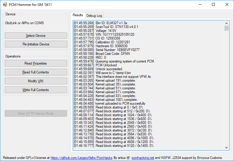

I got a full read in about 20 minutes using a Scantool SX, which I think is close to the best we'll get from that particular device. The next big milestones will be to get the AllPro from ObdDiag.net working, initially at the same 1x speed that the Scantool uses (should still be a little faster because it can transfer more data per request) and then at 4x speed (should be 4x faster of course).
Those are going to require changes to the firmware in the AllPro adapter, which Antus has already done some work on. In addition, redheadedod aims to get the Macchina M2 interface going. It kind of blows my mind that there is inexpensive hardware already in production with open-source firmware just waiting for some apps to come along. What a great time to be alive! With 4x speed and larger transfers, a full read should be under 5 minutes. And writes should be well under a minute since we'll typically only be writing to the segment that has the actual tuning data on it.
In the meantime I'm going to work on making the Windows app's communication more reliable, so that this will work with a PCM that's actually in a car just as well as it works with the one that's on my desk. My first attempt at reading the PCM in my Corvette ended with the dashboard lit up like a Chrismas tree and the engine not starting. :) It's all good now though, just had to cut power to the PCM to force it to reboot.
