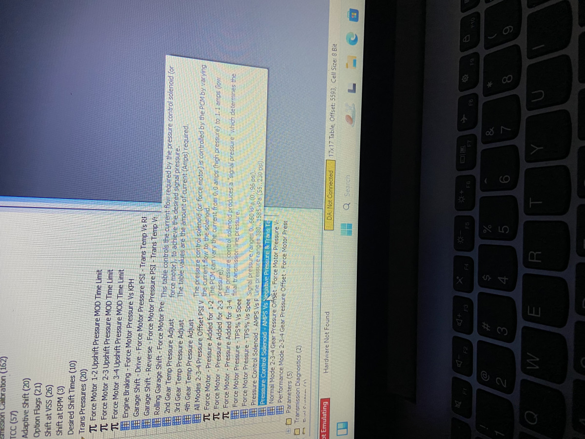

Looking at some of those new tables in the XDF, The one listed "new table trans ? " at offset 5593.
Looks like it maybe the Force motor mA?

What version are you using?
Wade
Posts: 689
Re: VS-VY Enhanced Factory Bins
Post by Wade »
If your using the latest version that’s all defined now
