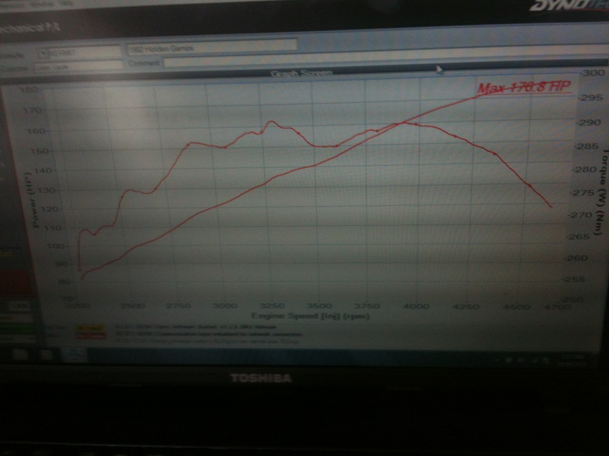

Nothing wrong, another engine in a racing Gemini with similar specs, 10:1 and a stage 3 crow cam also maxed out at 20º, it did the same, peaked power and max torque at 20º and more only resulted in losses. The dyno doesn't lie. The engine wants what it wants not what you think it should have.
There is no reason that the burn can't be sped up with a good combo to the point of needing less than stock timing.

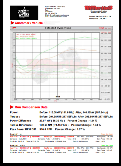

I'm guessing it's got the cam advanced heaps .this charts from a stock engine with slightly higher than stock duraton cam stock lift due to rules multi angle valve job not allowed porting and stock cast manifolds cause can't use aftermarket headers .took 28 degrees up top pulling 2 degrees cost 10kw adding 2 gained nothing .with a decient cam and compression you should be up near 180-200kw

yeah my cam is pretty small its only 212º at 50 thou and 470 lift, 114 intake center line, lsa of 109.5. It was meant to be a really torquey cam with mild improvements up top. Main areas were low to mid range which it certainly doing what it's meant to.
I have compared both stage 3 crow and wade 992a which both are a tad bigger than my cam but very similar and dyno charts for them are at the 140rwKw with the usual bolt ones included so I can't see how any of this is wrong. Even the gemini race car was in margin of error of my engine, torque, power, specs and timing all in spitting distance of what I got.

Actually I ended up making slightly more than the Gem.
I found it's old dyno chart. It has 10:1 comp, crow stage 3 and fully ported heads. Also liked about 20º of total timing. I recall we tried around 30º but it didn't do much, lost a little bit iirc running that much.
I am sure G can chime in about more of its specs.

Yeah wade cam on 8.5:1 will go 140s-150s maybe a bit more with good headers and exhaust a stock vp will go 125 with headers exhaust and cai and a tune
- Posts: 8124
it could be the dyno you use, the absolute best I ever got from a stock engine with all the bolt ones, good exhaust and headers, CAI etc is 108 rwKw on this dyno. Stock car reads at 90kw on this dyno.
