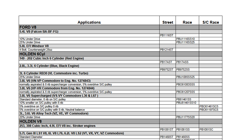

vlad01 wrote:yeah I needed a heavier more robust balancer to deal with the increases RPM and abuse.
Its SFI 18.1 ? race spec and cost a bomb. They could of put better paint on it but of course it was shit and ended up rusting after a few months.
Of course ! What the fuck were they thinking lmfao
They could of done it like the Ross Tuff bond balancers, they are finished nice as, but if their fucking site or catalog would of listed V6 balancers that would of been too easy. Only found out they made one through a single ebay listing and even the part number on the balancer doesn't exist on their listing. So they make ghost invisible balancers apparently. :roll:

Nope, just banged the bastard on and went hard. Powerbond did specific balancers for the various V6 engines back in the day which they no longer do.
Posts: 7804
They still do, that's how I got mine. There was 3 or 4 different ones for the Buick alone. I recall they listed as Buick or Pontiac or similar while the ecotec ones were listed as Holden.

Actually under Holden. I think I was looking at the international catalog last time?
I use the VR one for all Buick as they have a much better CAS design than earlier engines.

Btw this is the only listing of a Ross balancer to suit late Buick in existence. Its not listed anywhere but here and the unique part number supports that it must be for late Buick as its different to the also non listed but somewhat easier to find ecotec one. Ross's website and catalog is complete bs! just like most Australian businesses.
