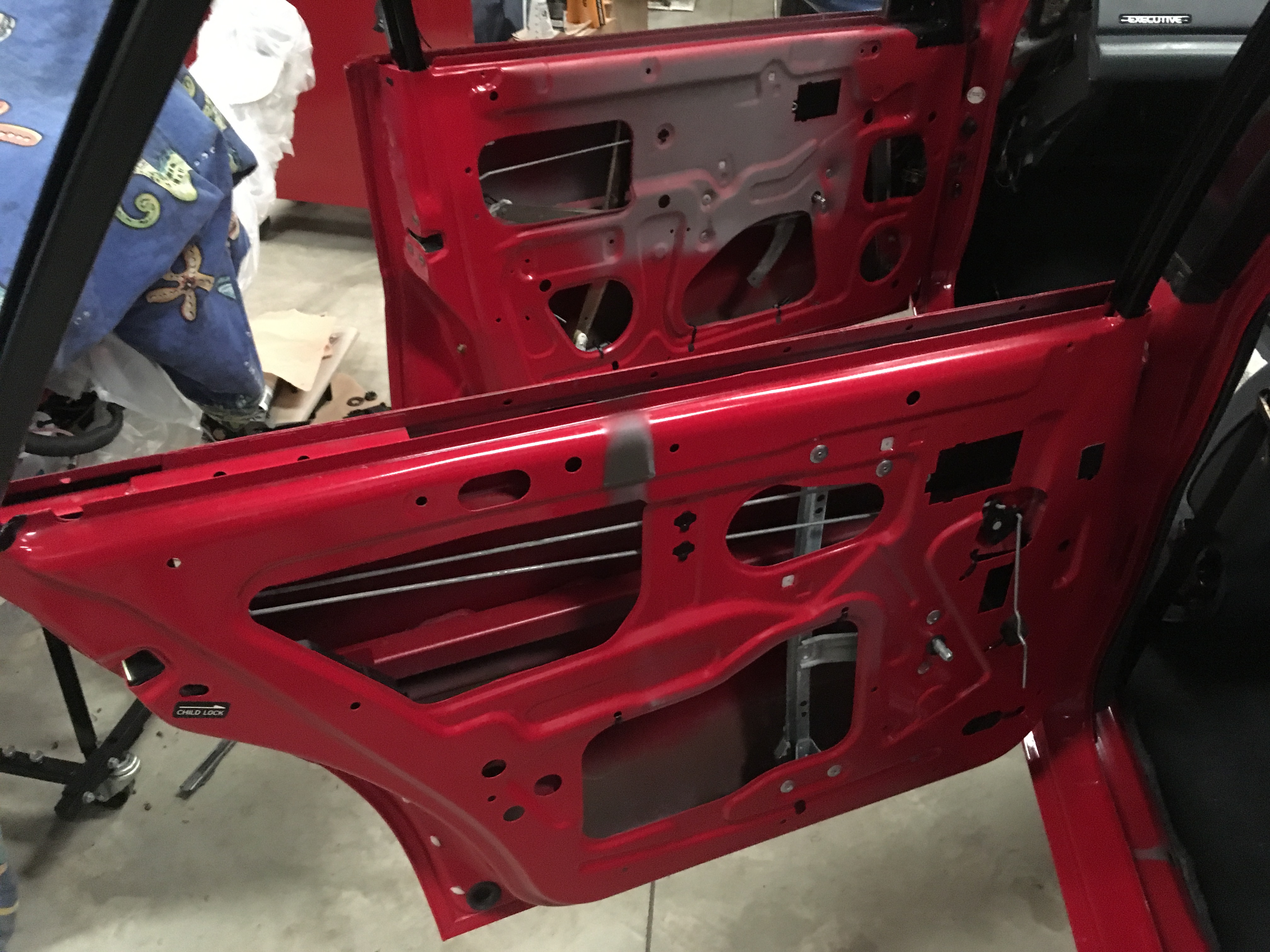

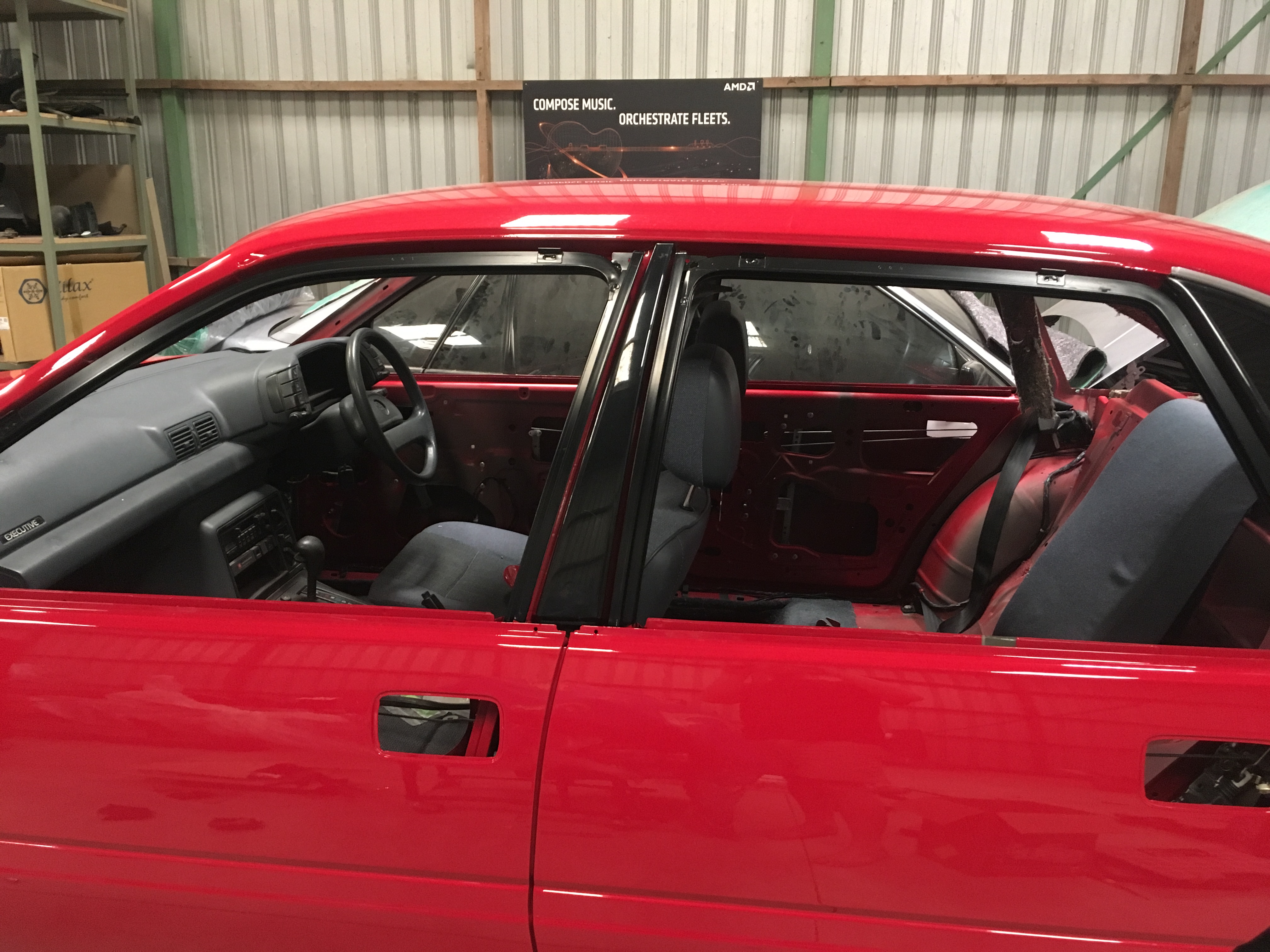

Doors were gutted and car rolled out and everything inside was washed good. Also that yellow goo stuff I spent 3 hours removing from the door. I have new tube of butyl mastic to re do the membranes.

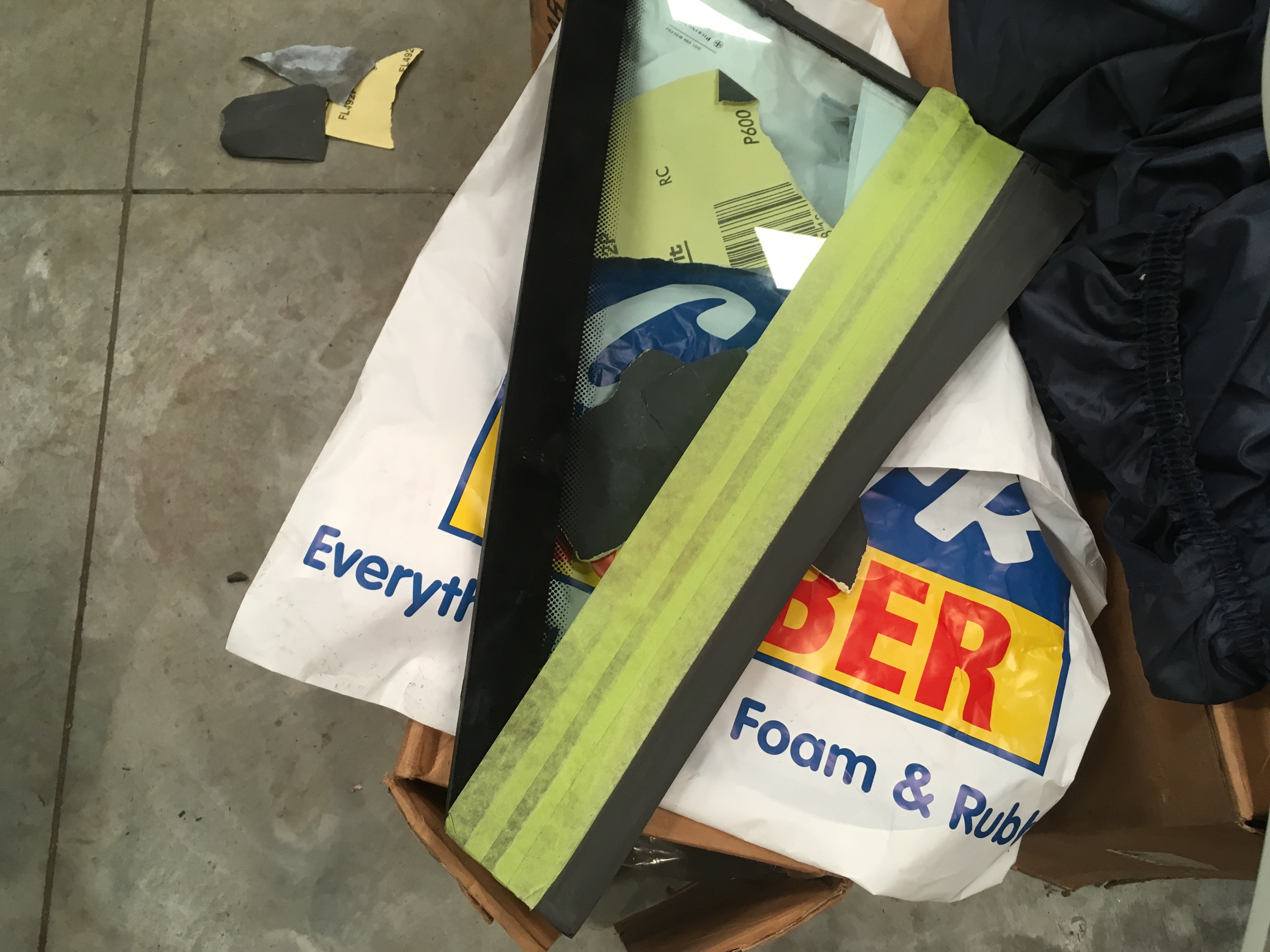

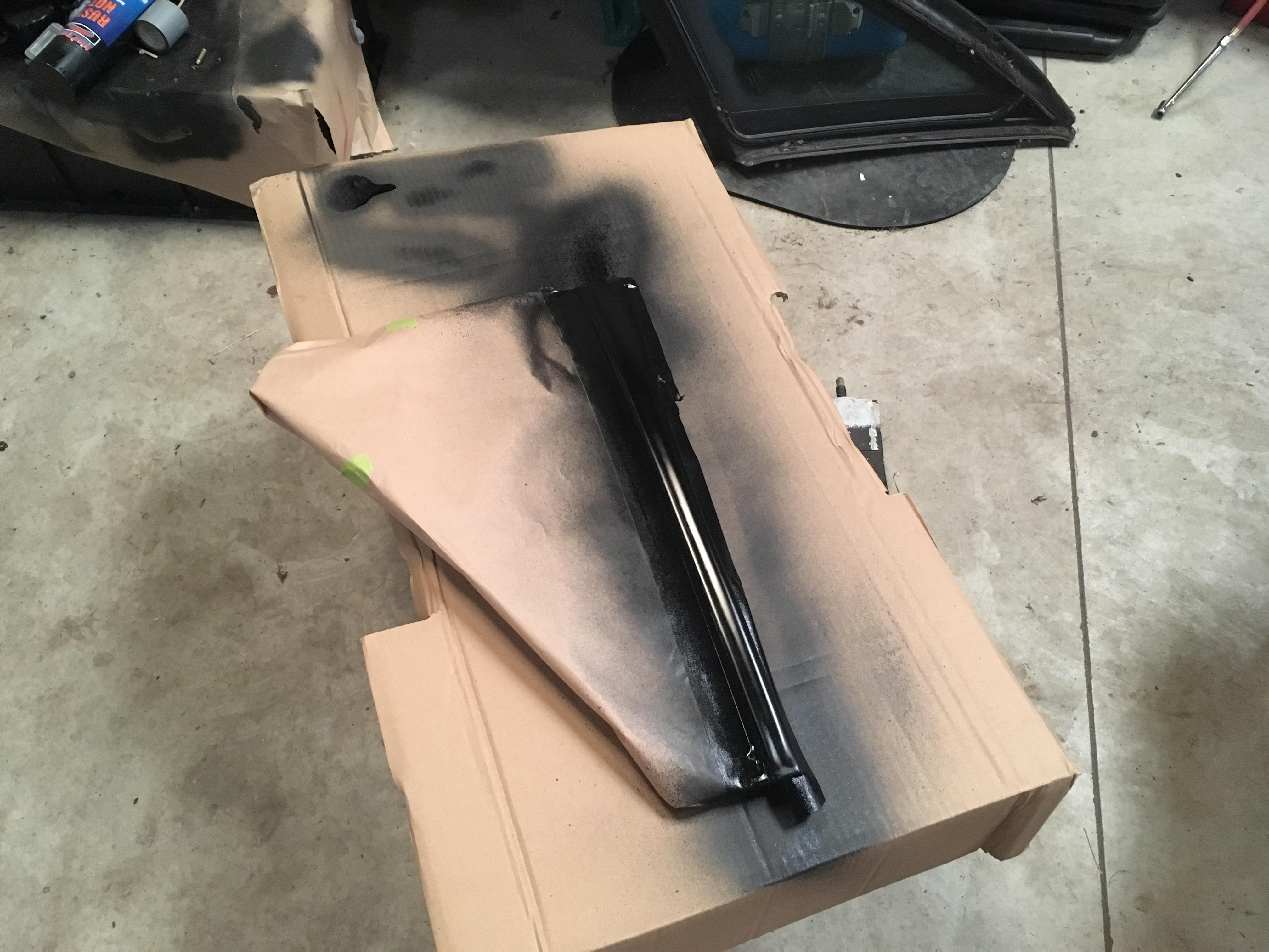

I sanded these for ages and ages but finally got all the roughness I could get out and re-coated them in gloss vinyl dye.
- Posts: 7804

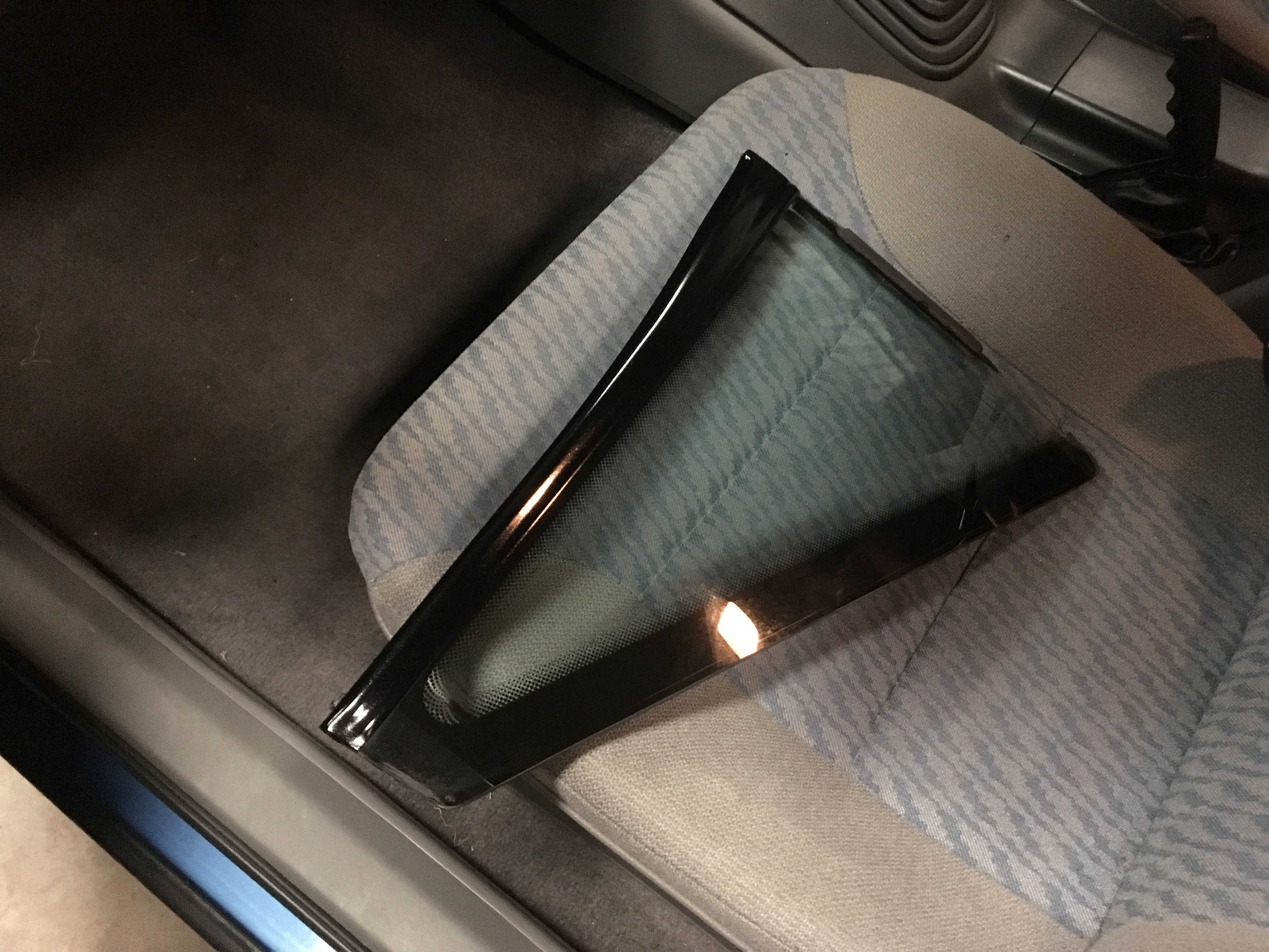

They came up great! like NOS almost.

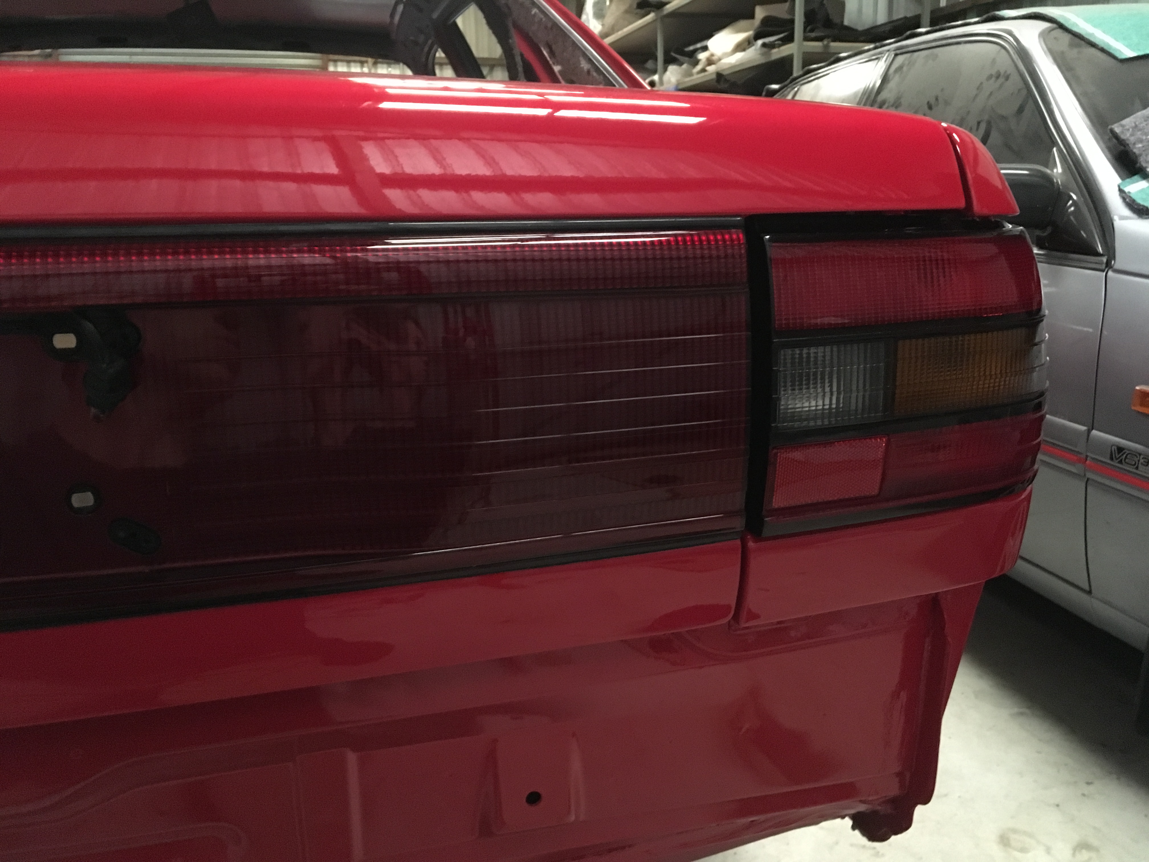

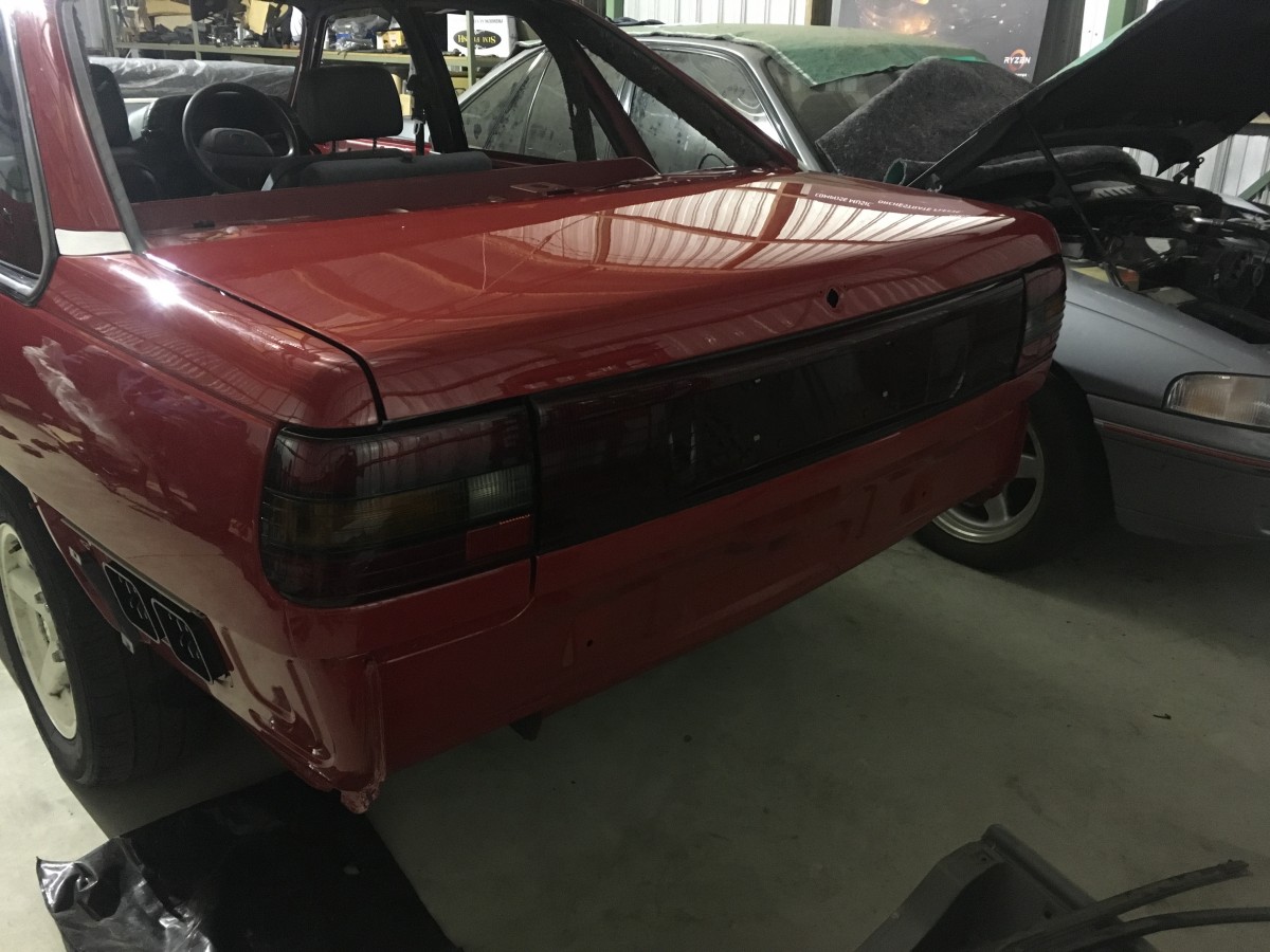

Got the garnish and tail lights roughly installed. Don't ask how much that used garnish cost

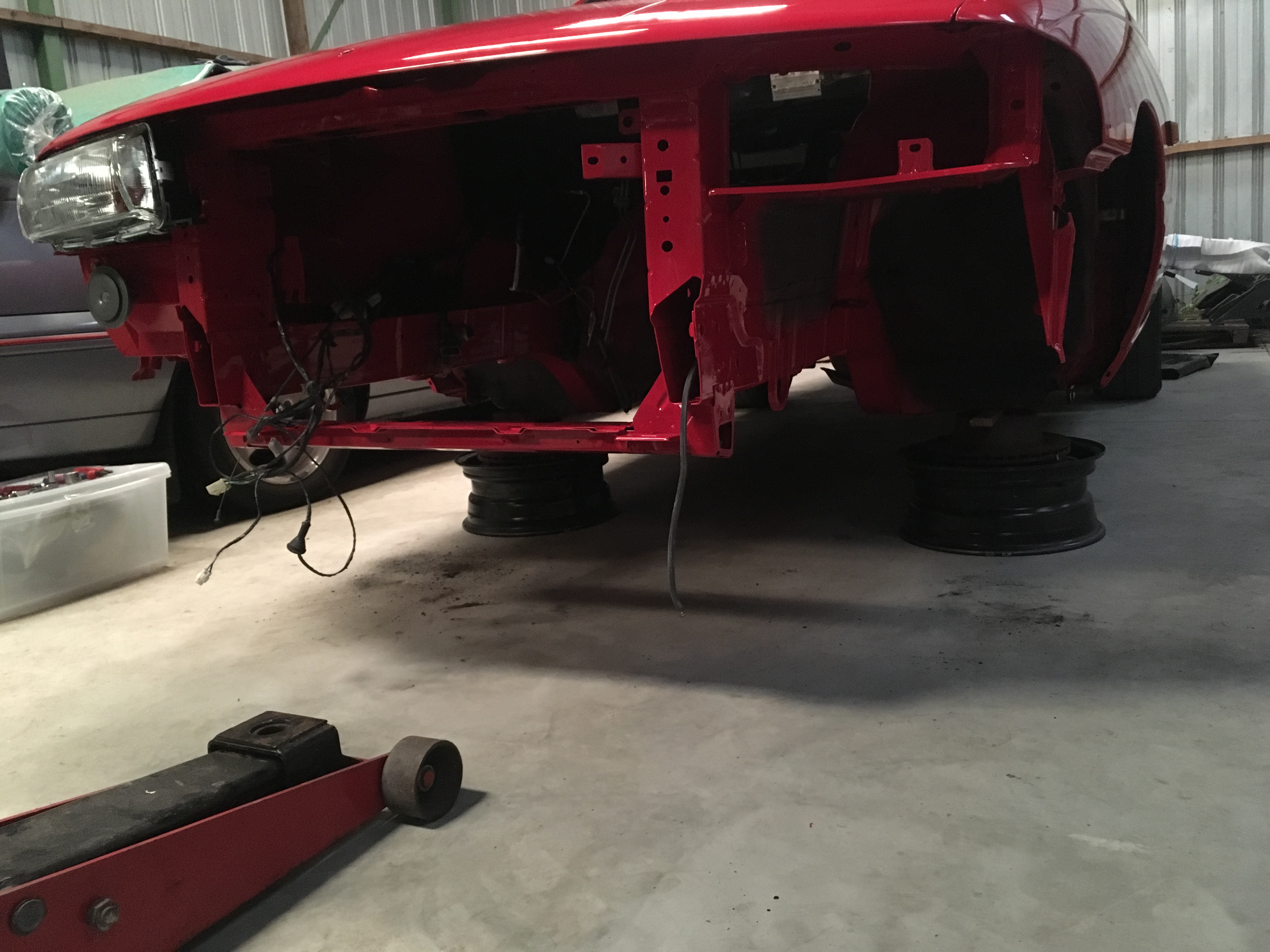

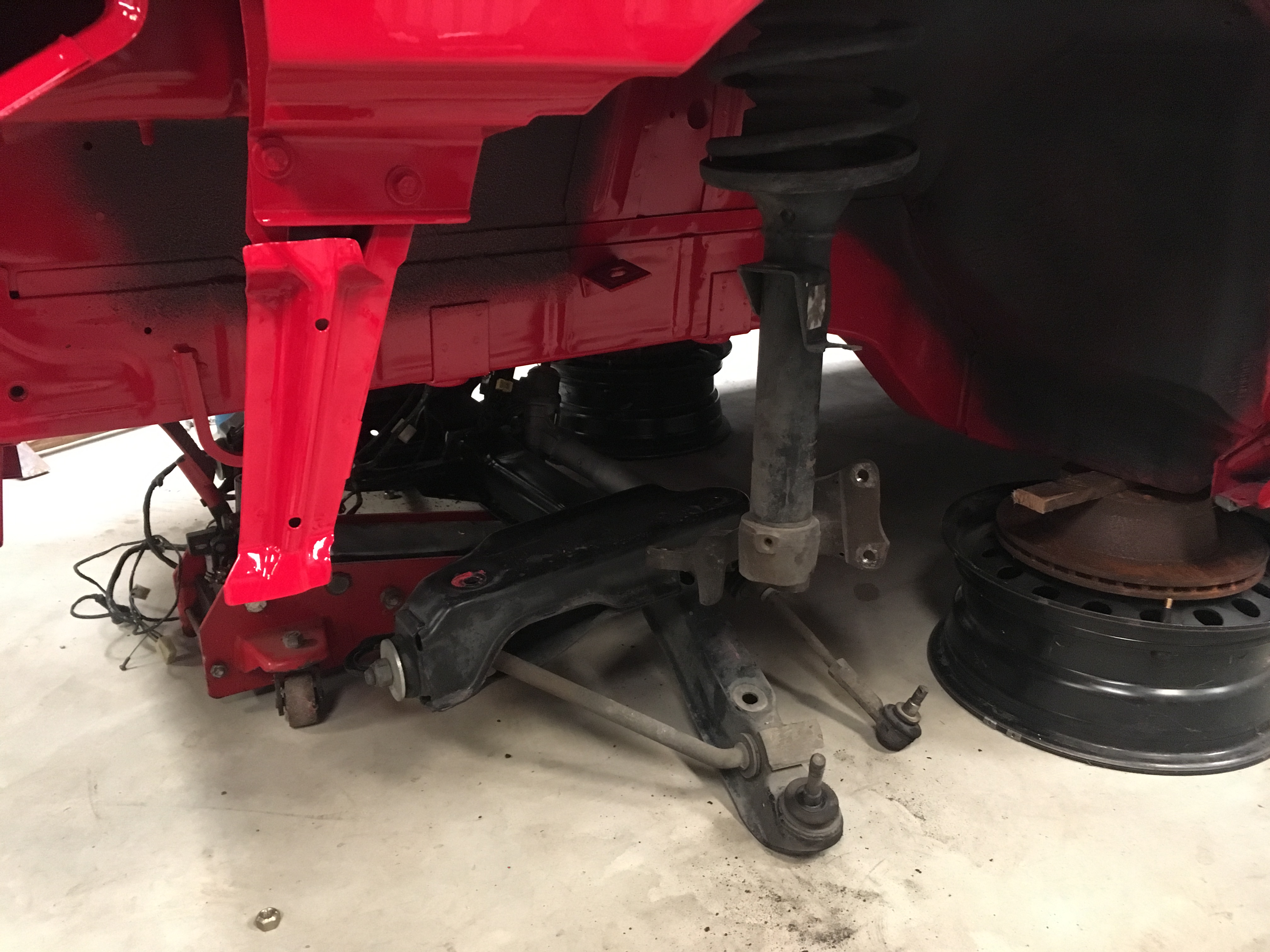

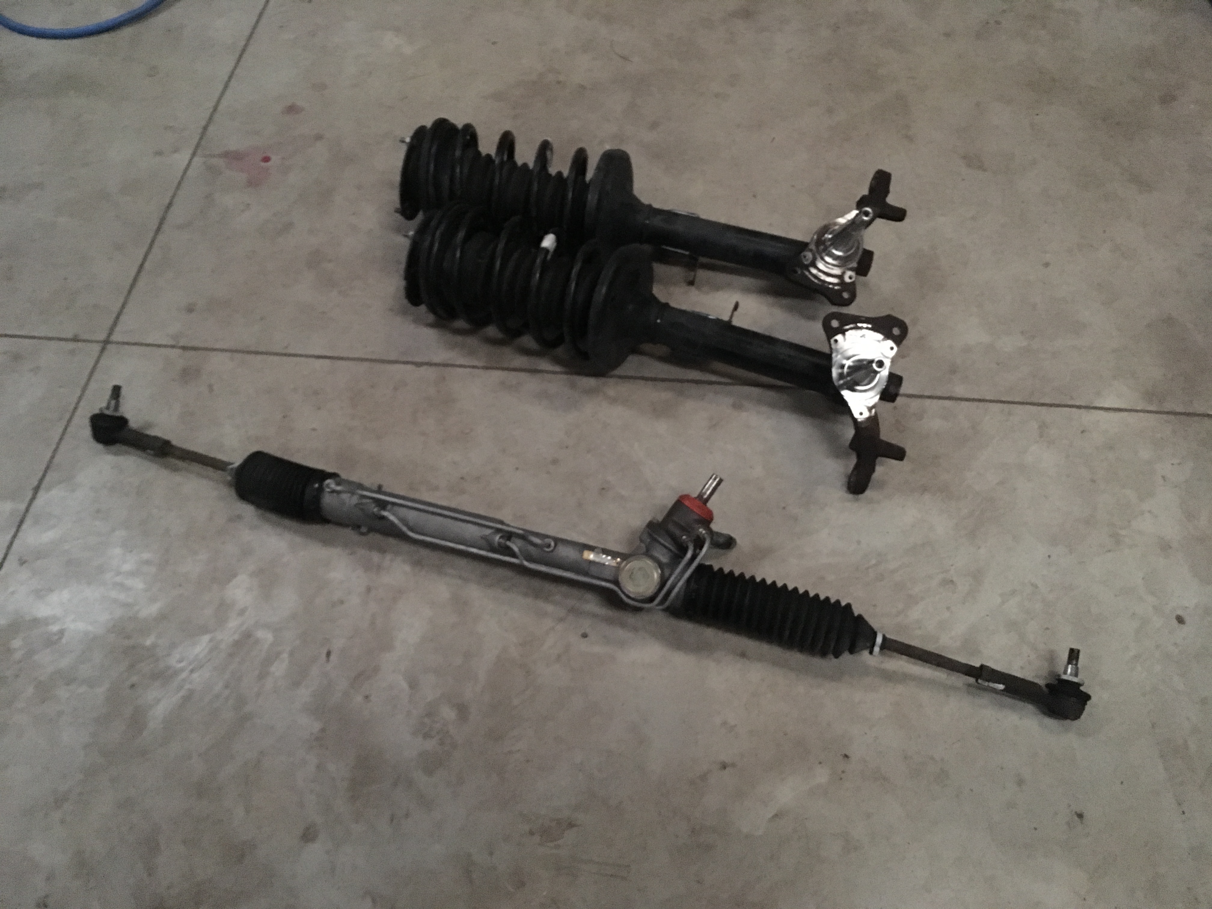

Dropped the front end, going build new struts and have the rack reco'd.
I have a nos K frame and the control arms are already good to go.

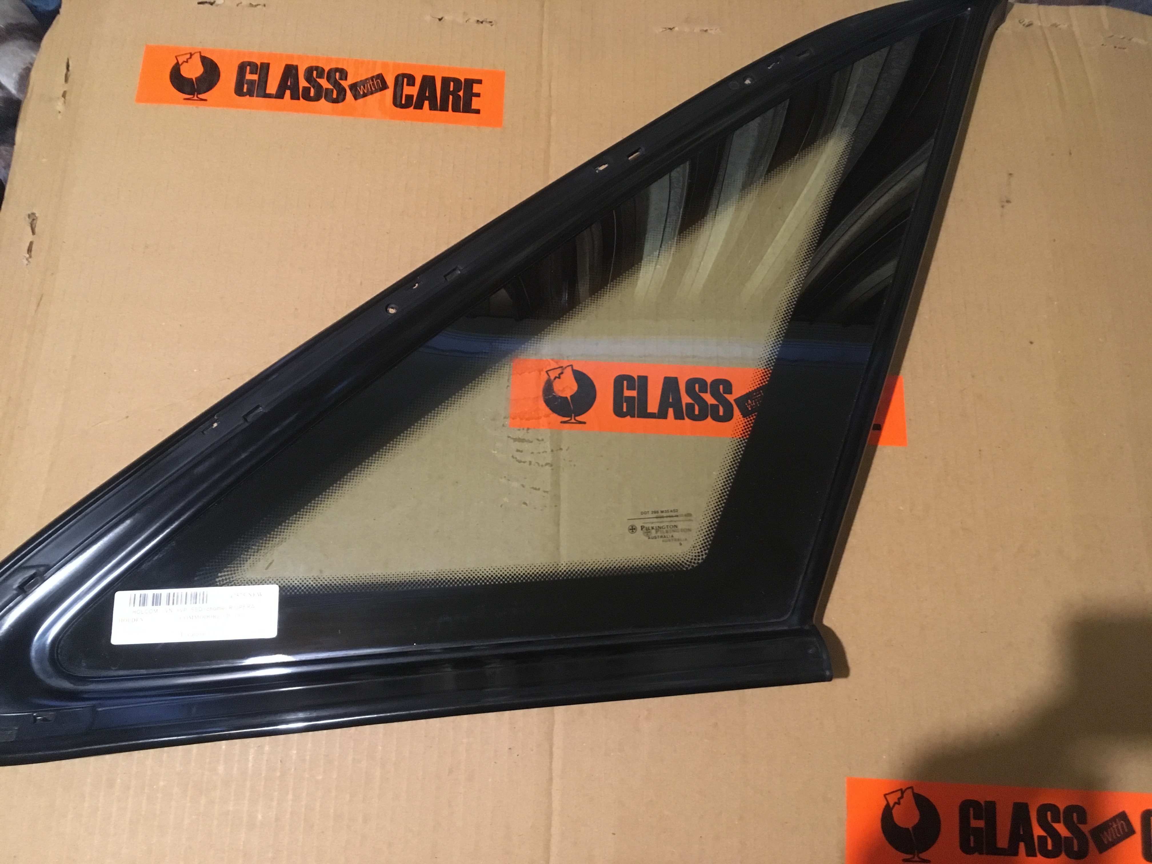

Finally arrived, only took nearly 2 months. NOS RH rear quarter. Got a complete set for the S now.

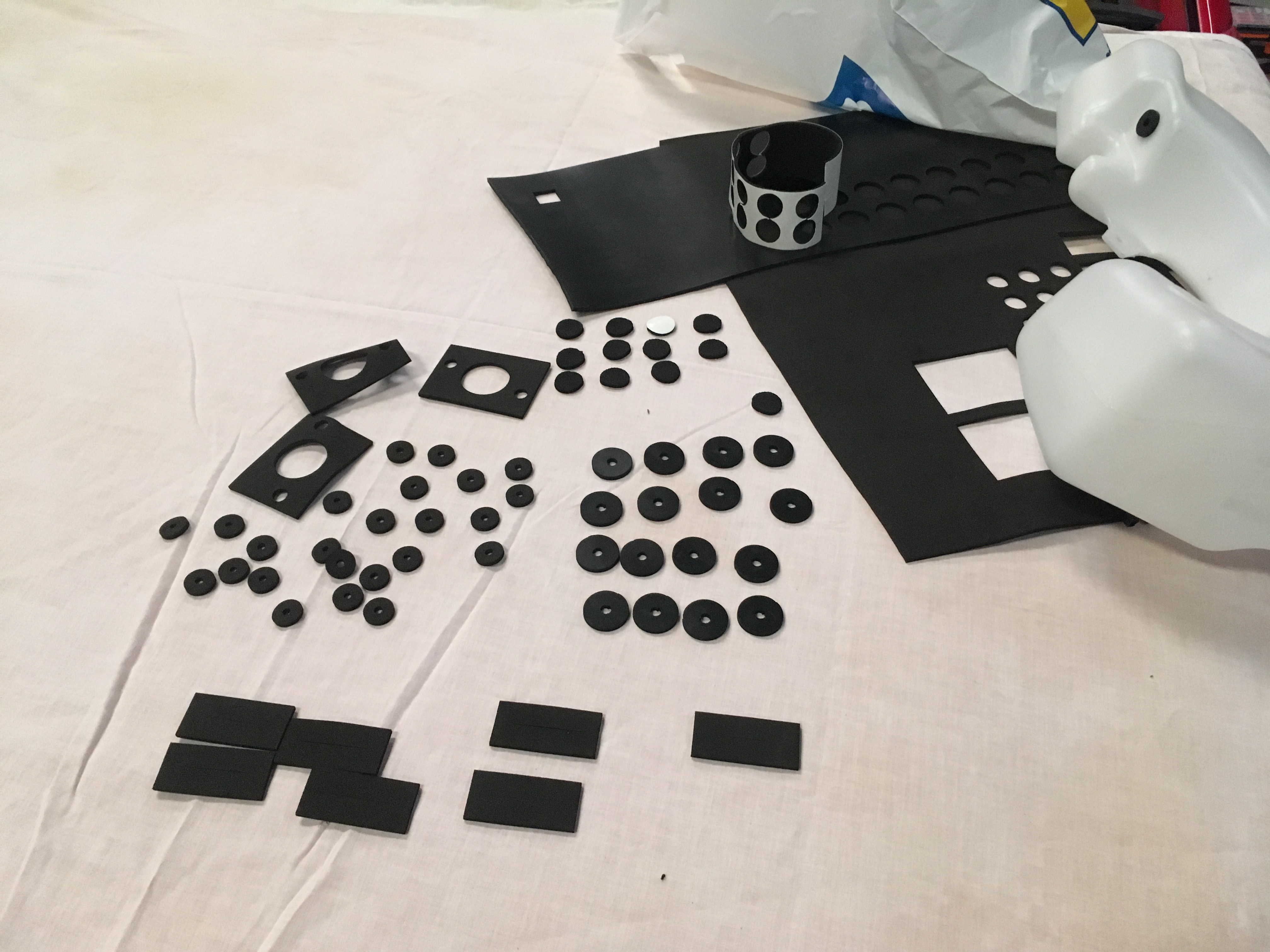

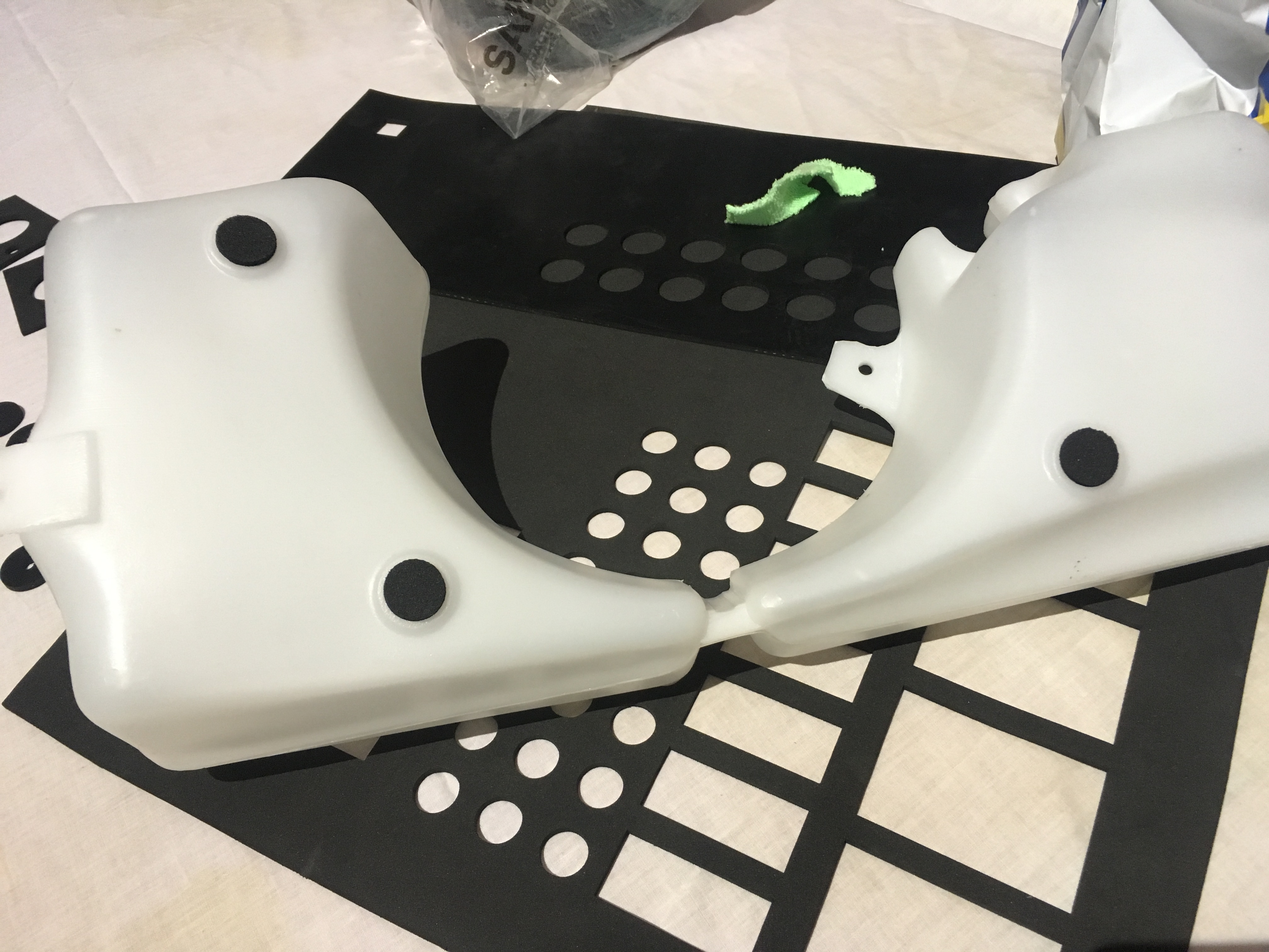

Have brake booster to firewall, Garnish stud seal, some rubber washers, washer bottle contact pads for prevention of paint wear though, rear handbrake lever seals... etc..
Washer bottle pads.

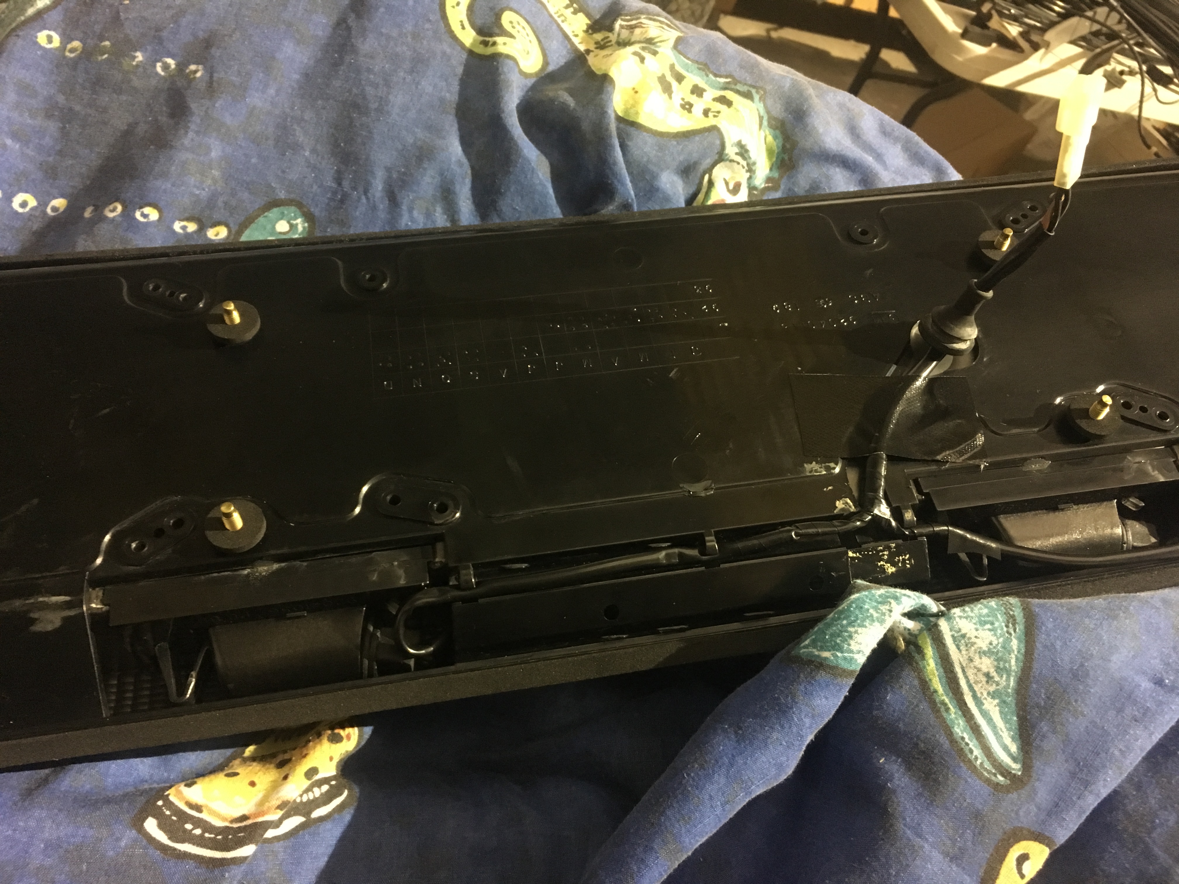

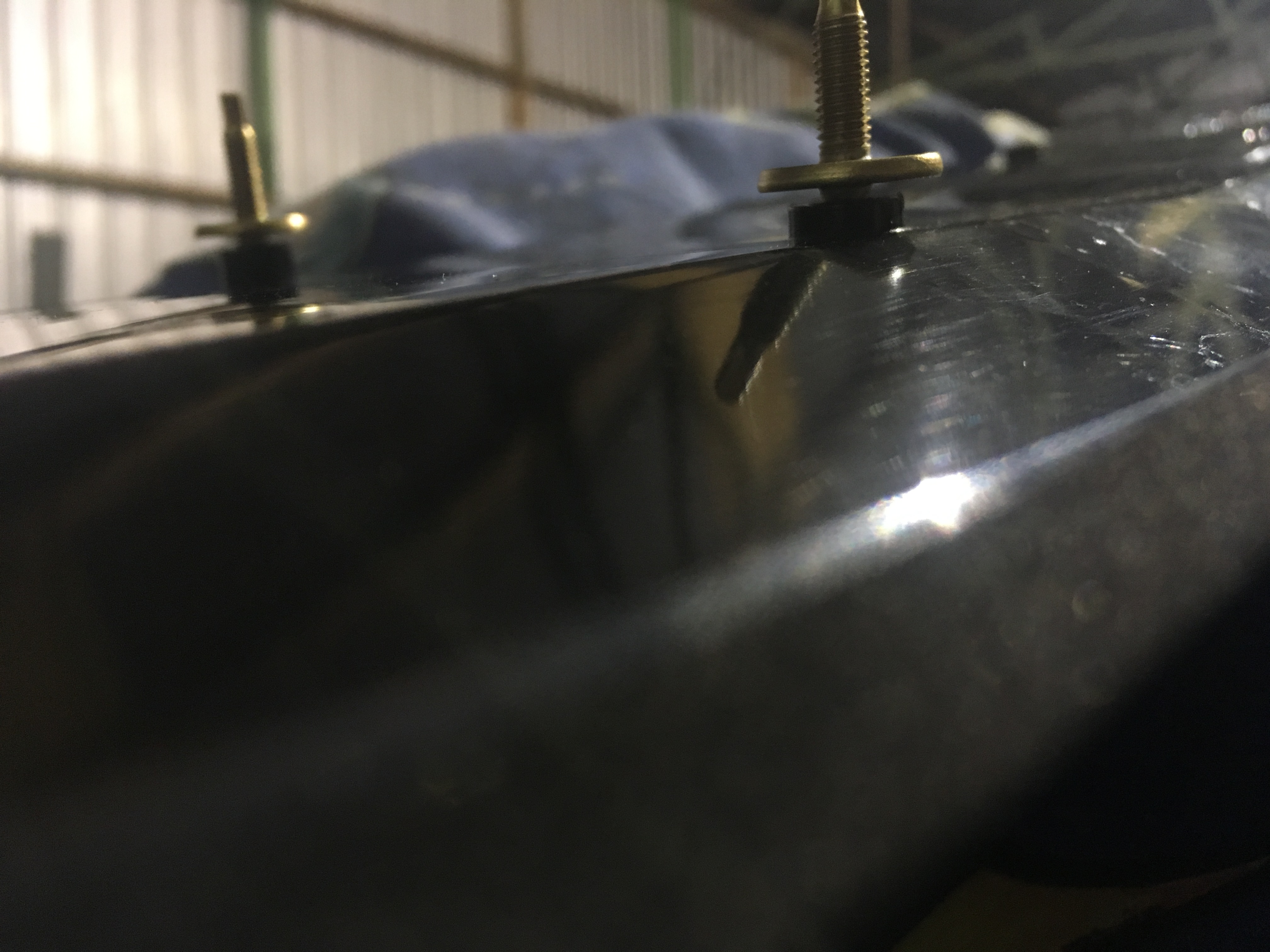

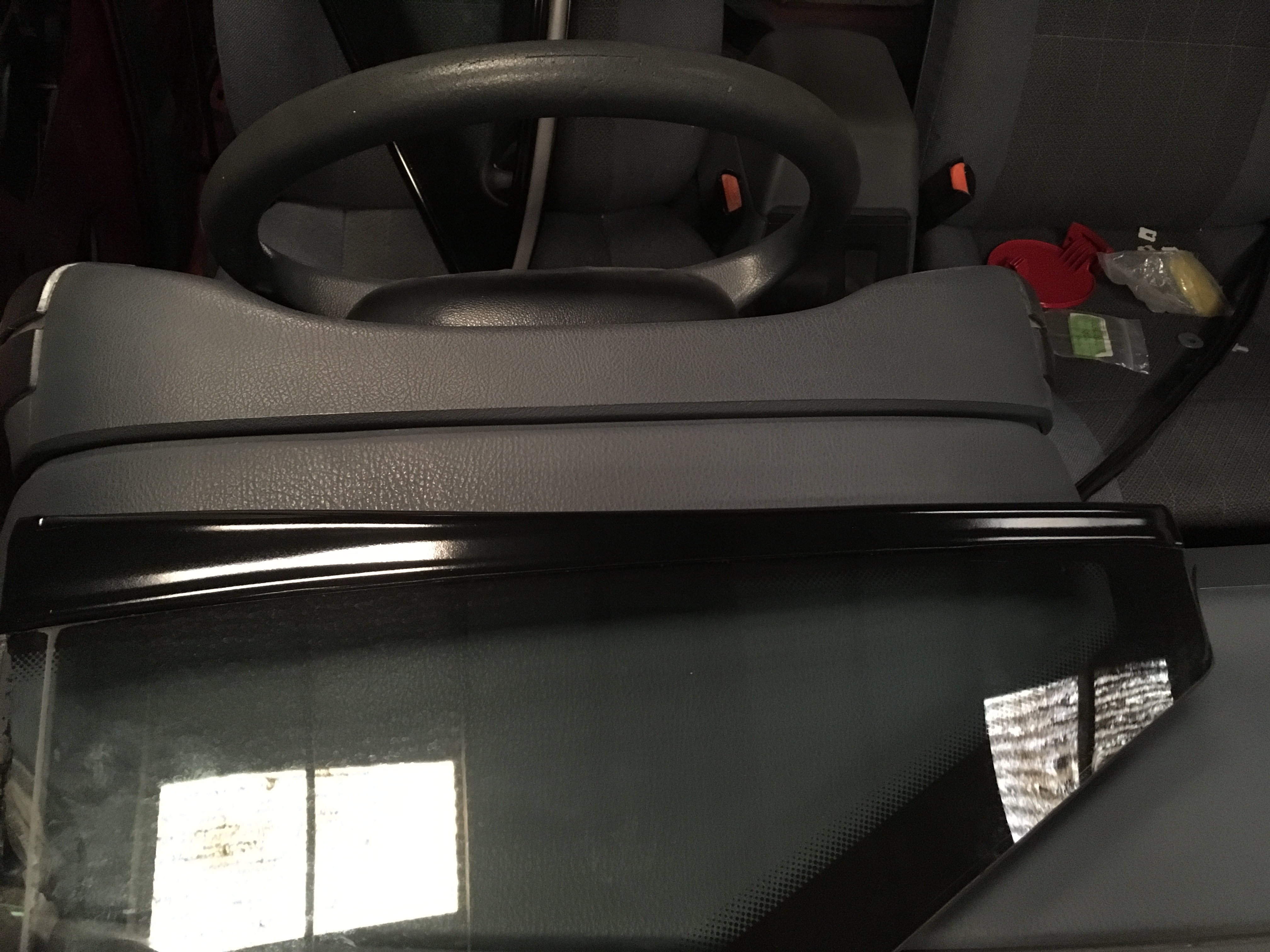

The garnish studs needed a slight adjustment to not bend the garnish over the back of the boot.
Foam washers installed.
Washer bottle pads.

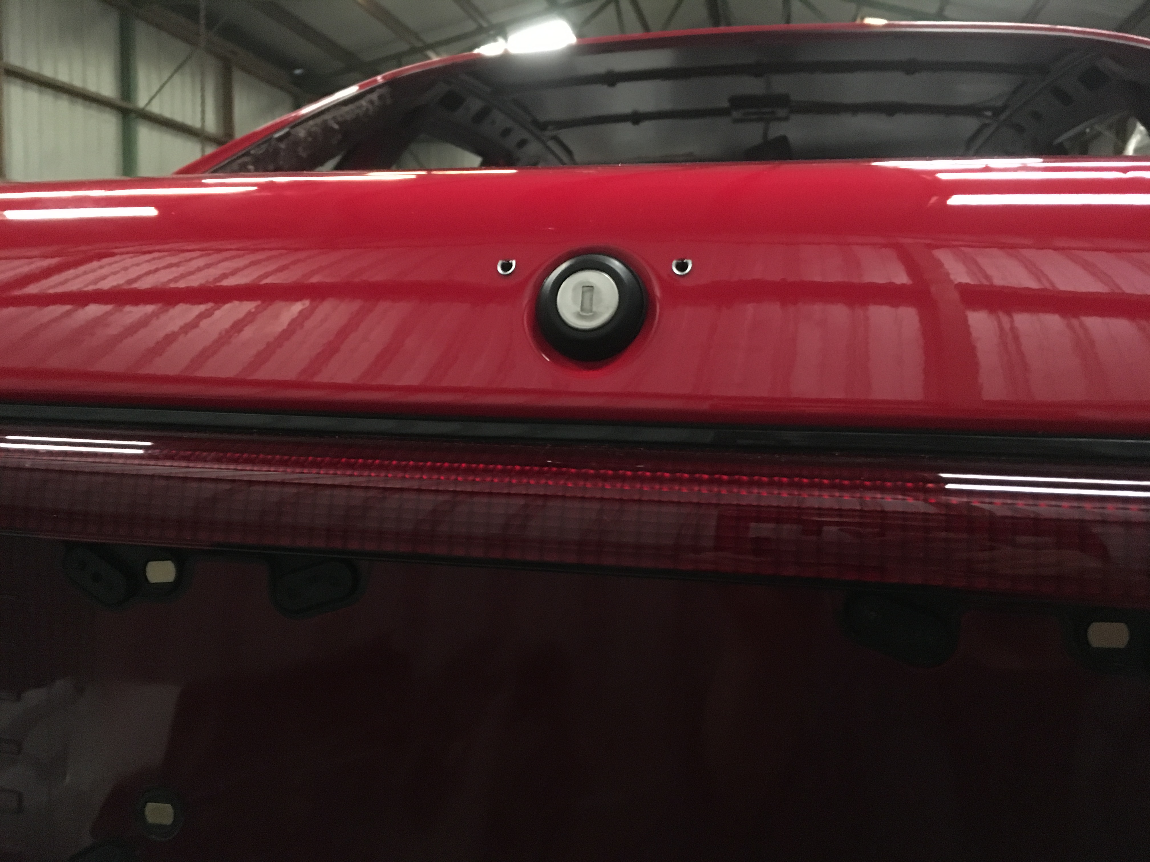

The adjustment turned out perfect. Before only the center ones were contacting with the adjustable outers sitting way off in the air. I suspect this might be the cause of all the garnishes typically cracking on the 1/3 sections due to this stress as they are all screwed in to the max.
Fitment complete. Also note I replaced the lip seal top and bottom lip of the garnish with a better quality EPDM foam rubber instead of the PVC foam the factory used which just stays squished and goes brittle.

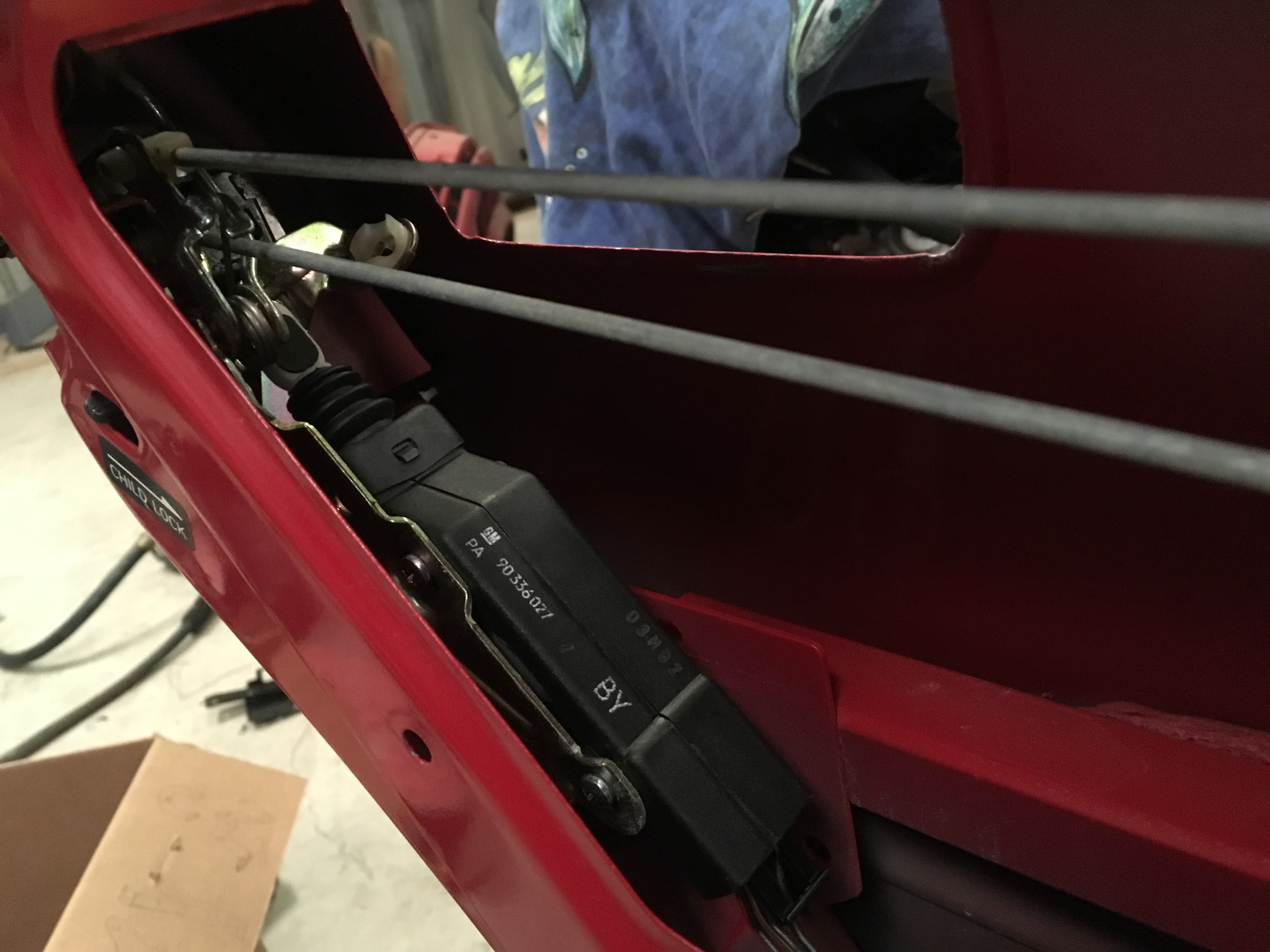

Got all the cables back in and refilled the lock mechanism. Also installed new badge pin retainer thingos. The silver ones from Rares is the ones you want. I bought both sizes from them not really knowing which it was, there is black ones and silver. Silver is right for VP

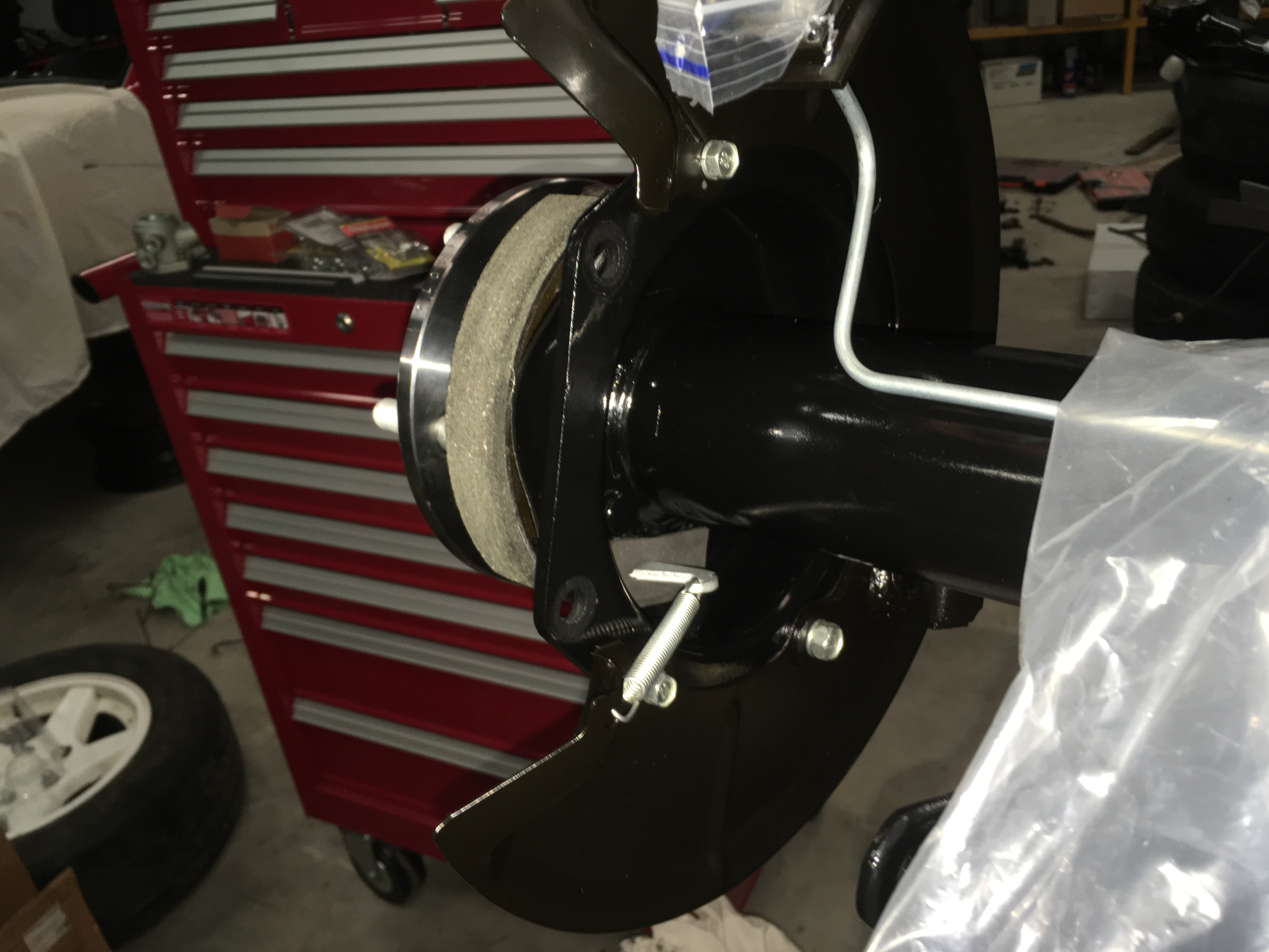

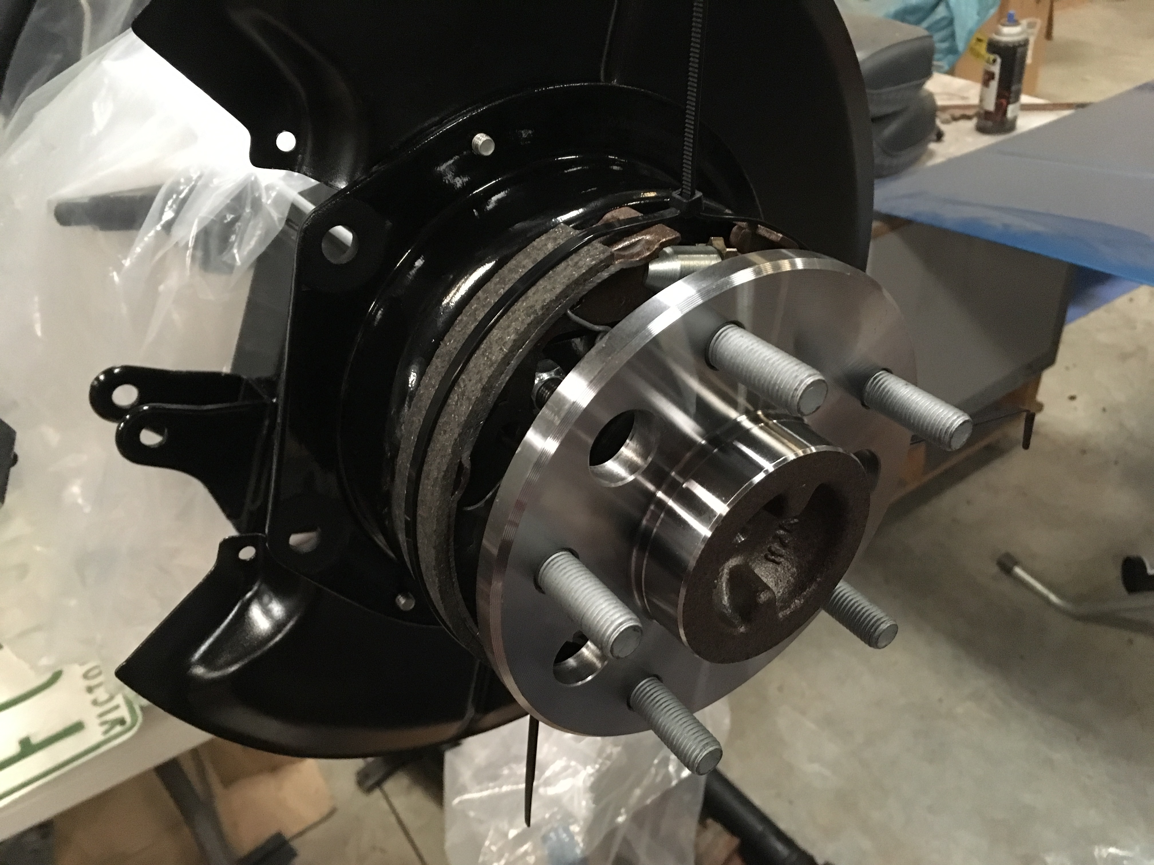

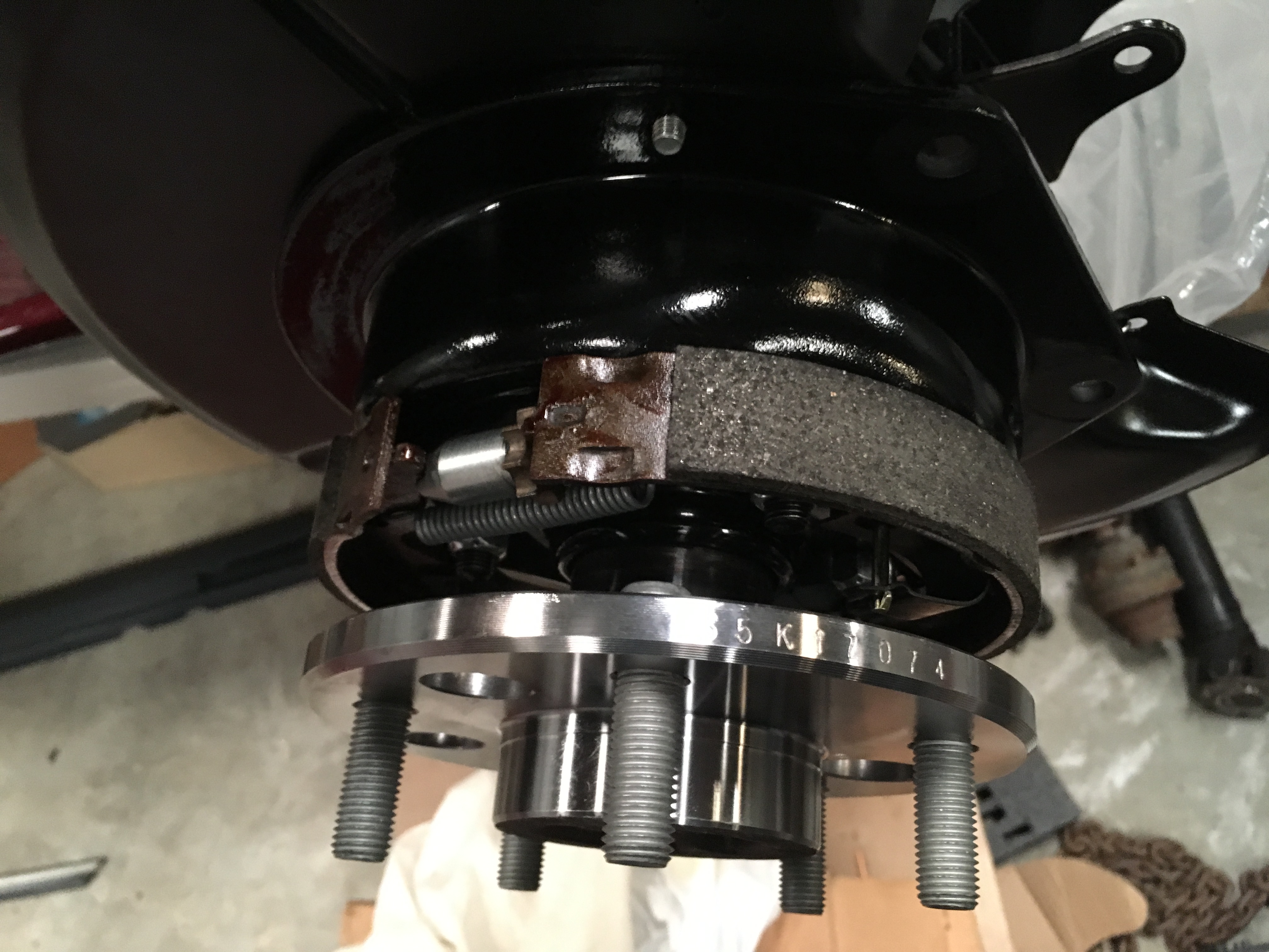

Job for today was getting the handbrake stuff sorted how that I had the foam seal for the lever. I glued that on with contact 205.
A trick I worked out for stopping everything for jumping out while installing the return springs was cable tying the shoes together. Worked great!

darn good idea with the cable tie for the brake shoes

yeah I got sick of the shoes, adjuster and retainers falling on the floor while trying to put it together, so fuck it......cable ties it is.
