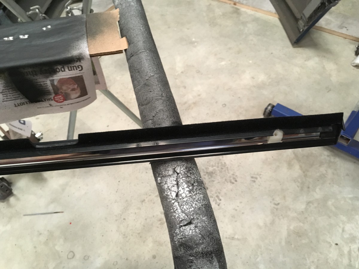

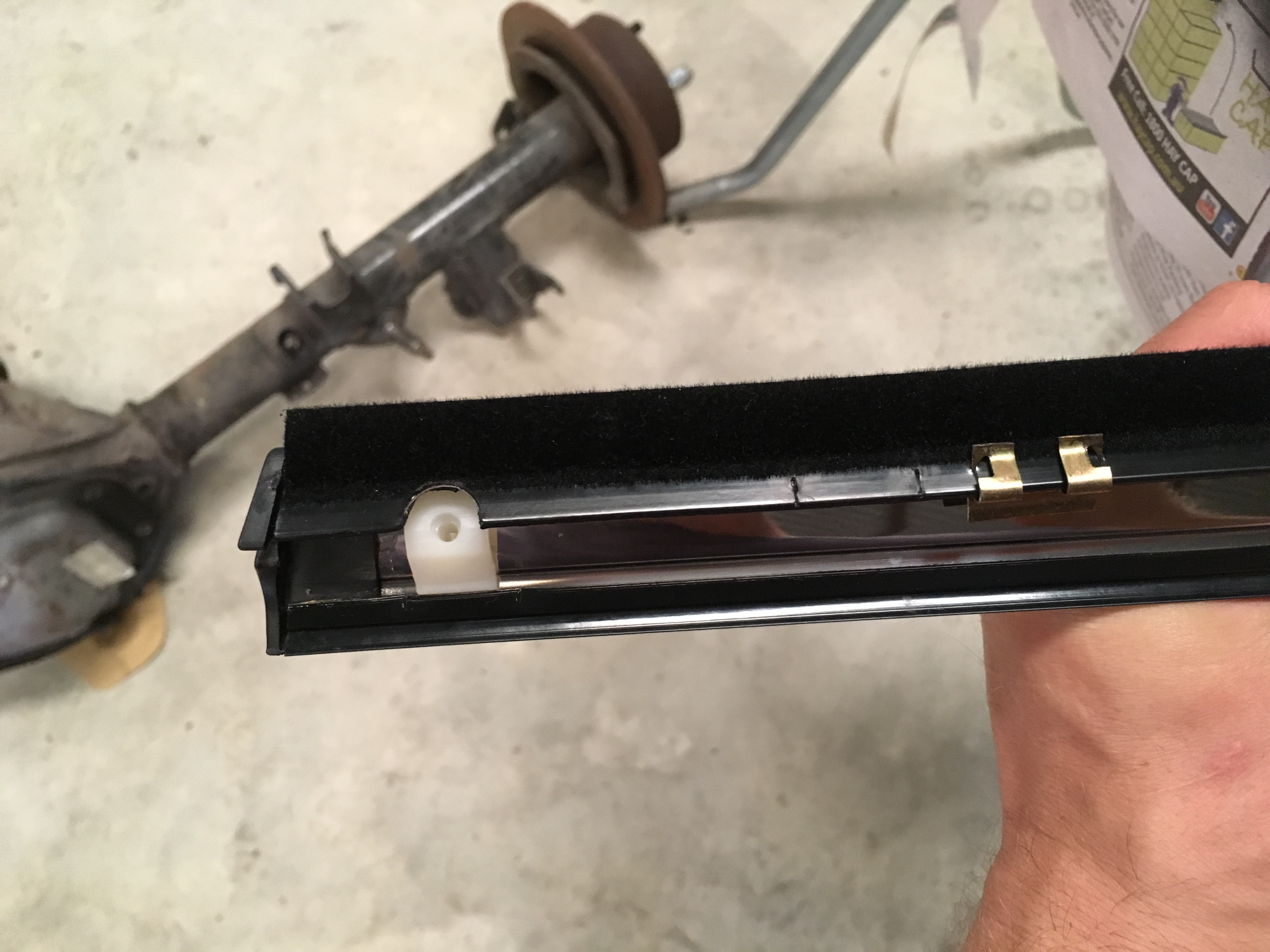

Finished the rear belts.
Still need to install the right side after I get the quarter glass sorted. Left side is done though.
I used a die grinder and a large burr to make the semi circle cut outs for the screw mounts. Glued in the used end caps I had. Came out great

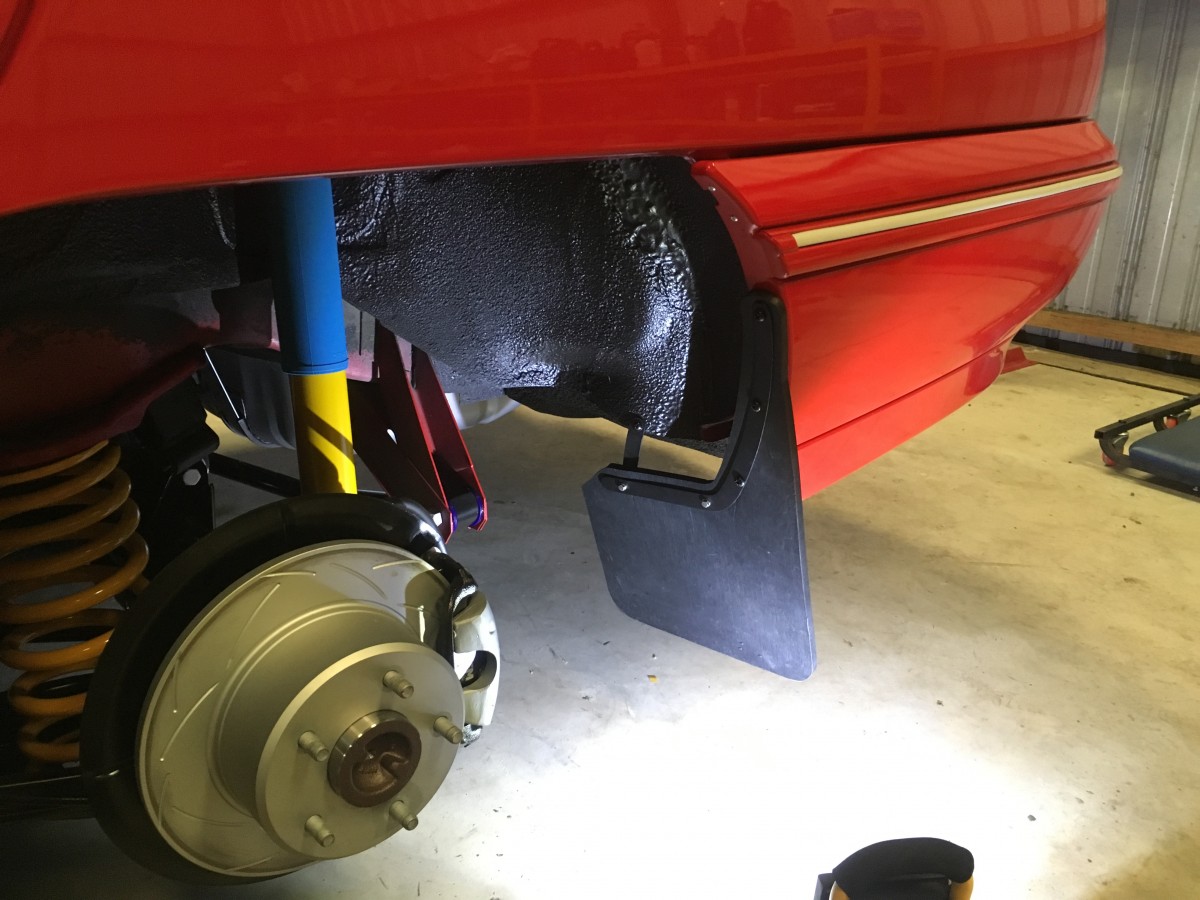

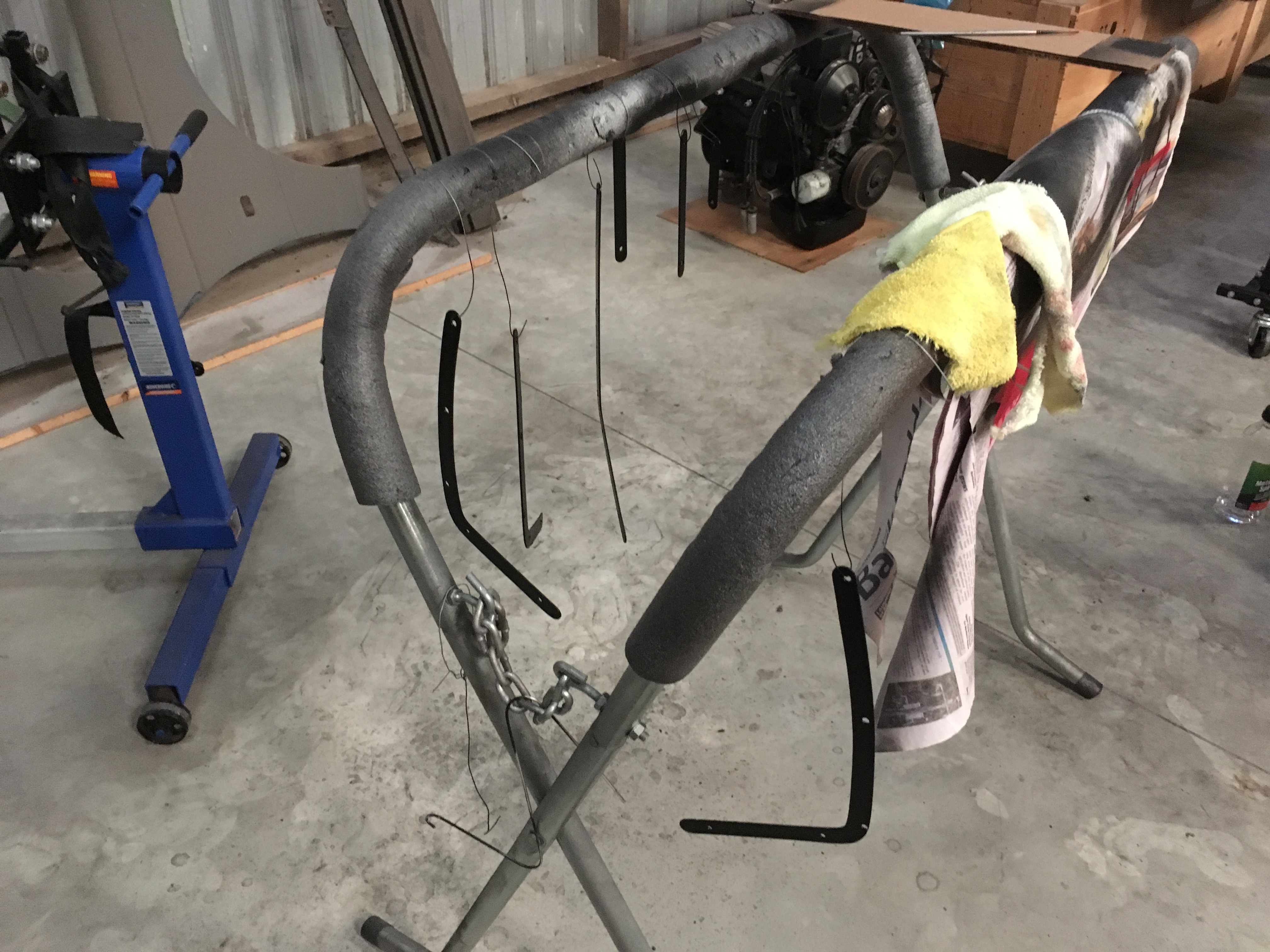

Got the NOS and used mud flap brackets blasted, primed and painted. I have bent them to shape of the guards too but not in this photo.

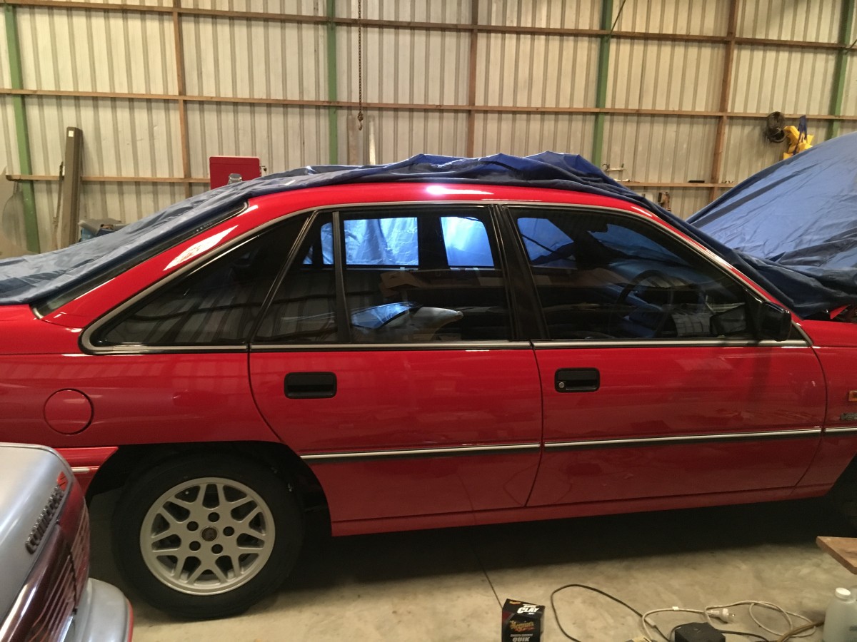

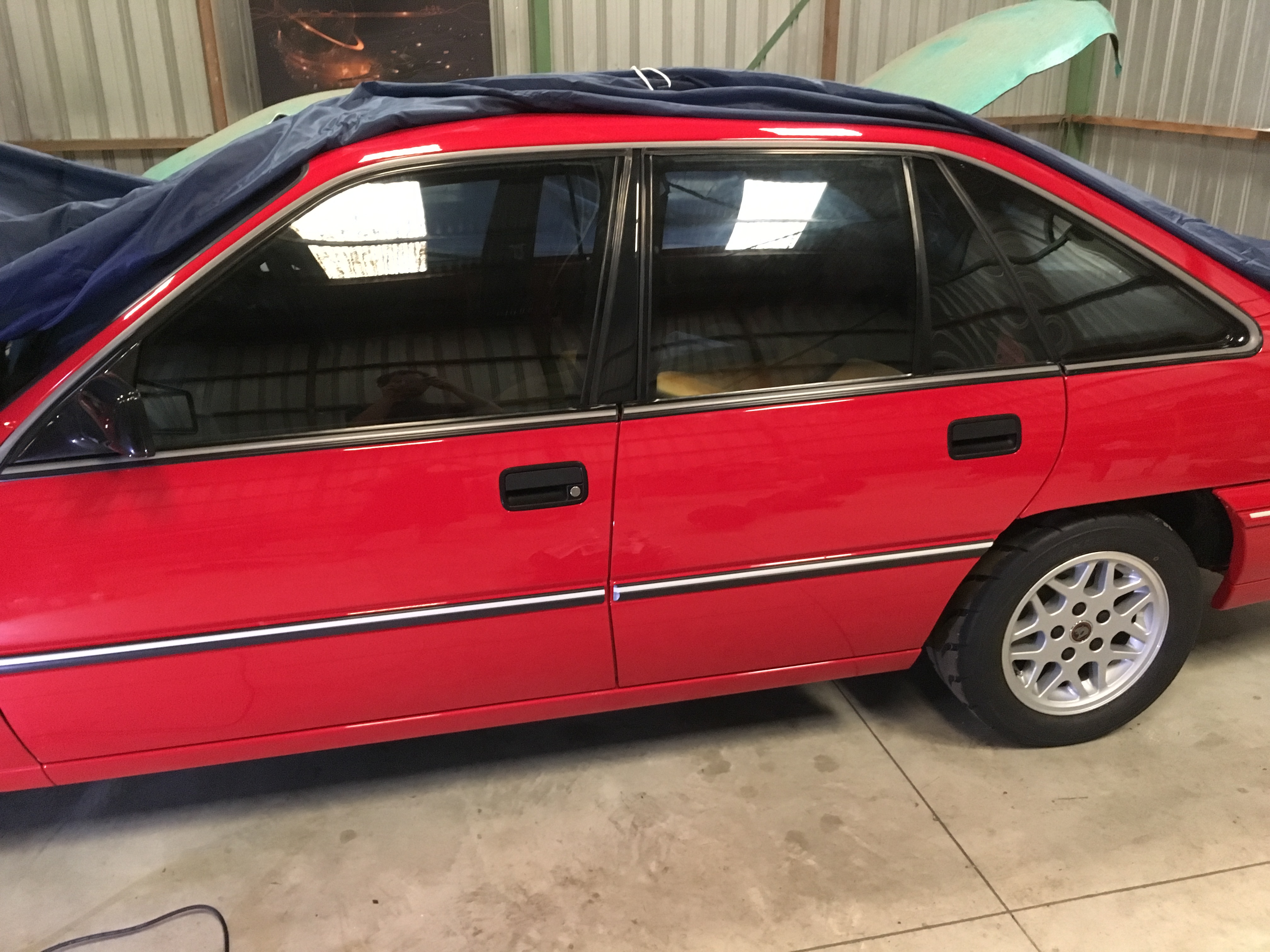

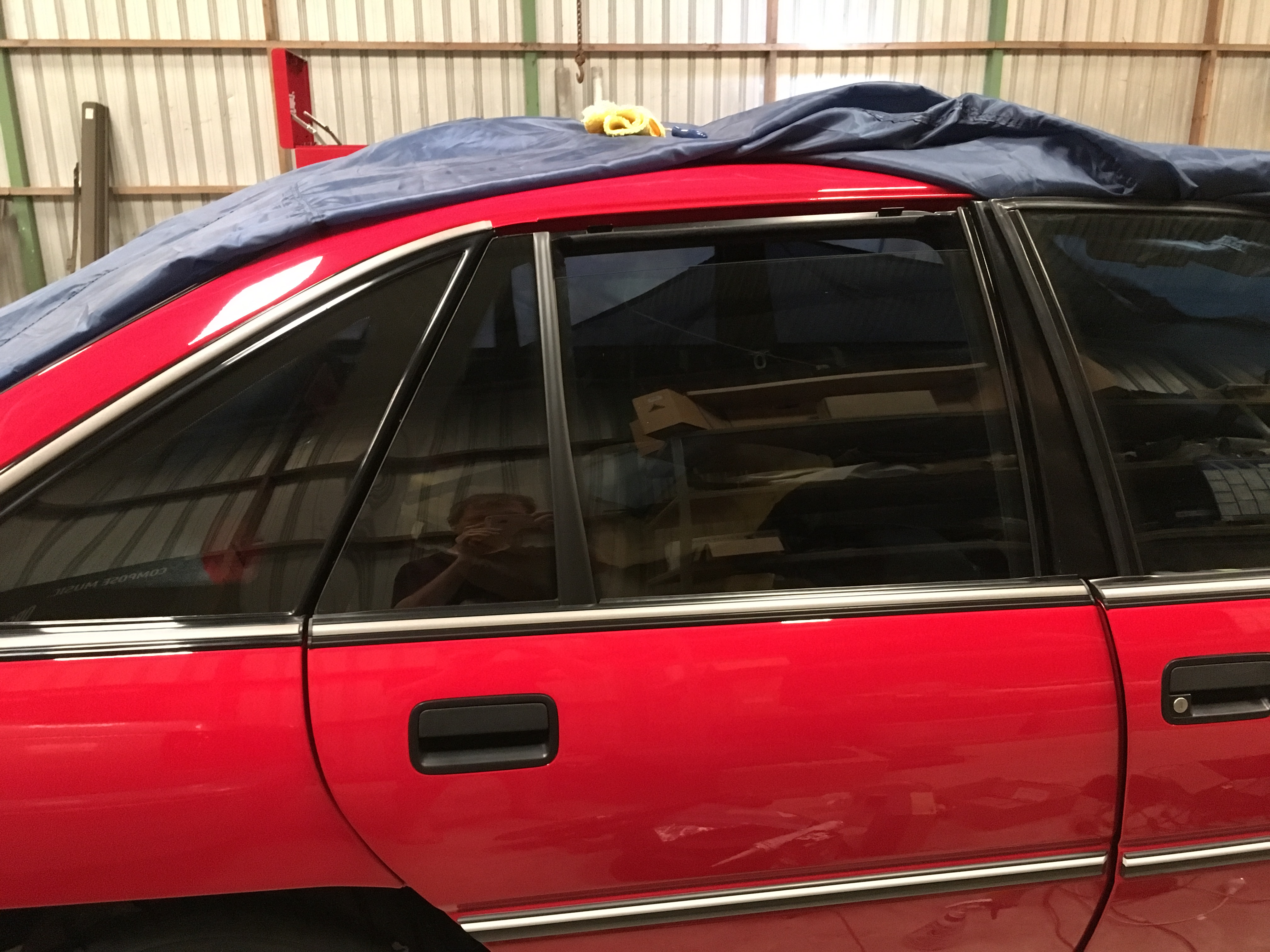

Finished the driver side gutter. For some reason it was out of alignment with the screw holes by 3mm. The opera window trim was as far back as it could go and no dice so I ended up modding the gutter trim by filling the end until it was shot enough to fit with hole lining up and pushed back as far as I could. Just dabbed some grey paint on the end and you wouldn't even know. So that side looks complete now and outer rubber is also done on the rear door.
Will get a pic tomorrow when there is enough light.

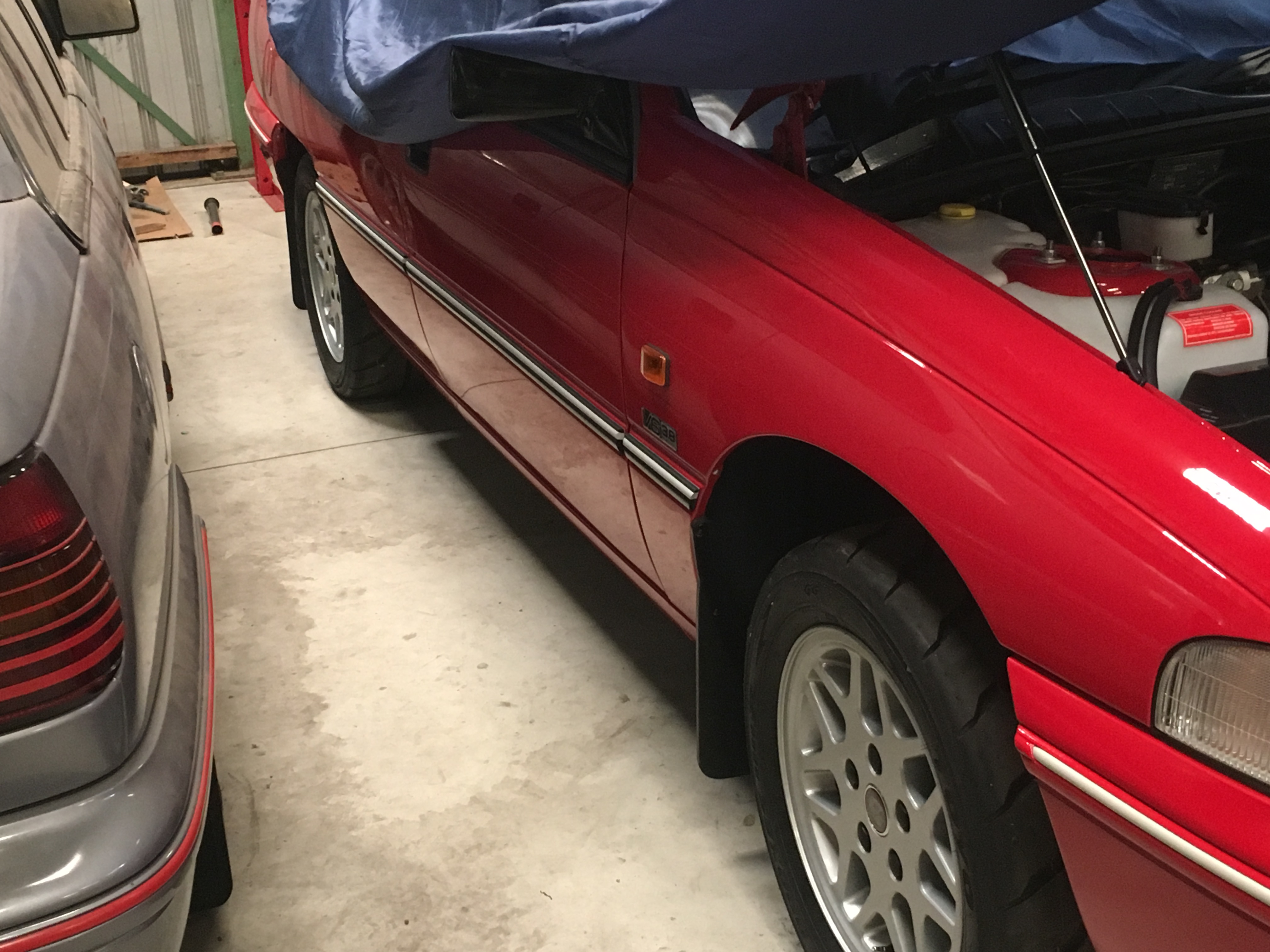

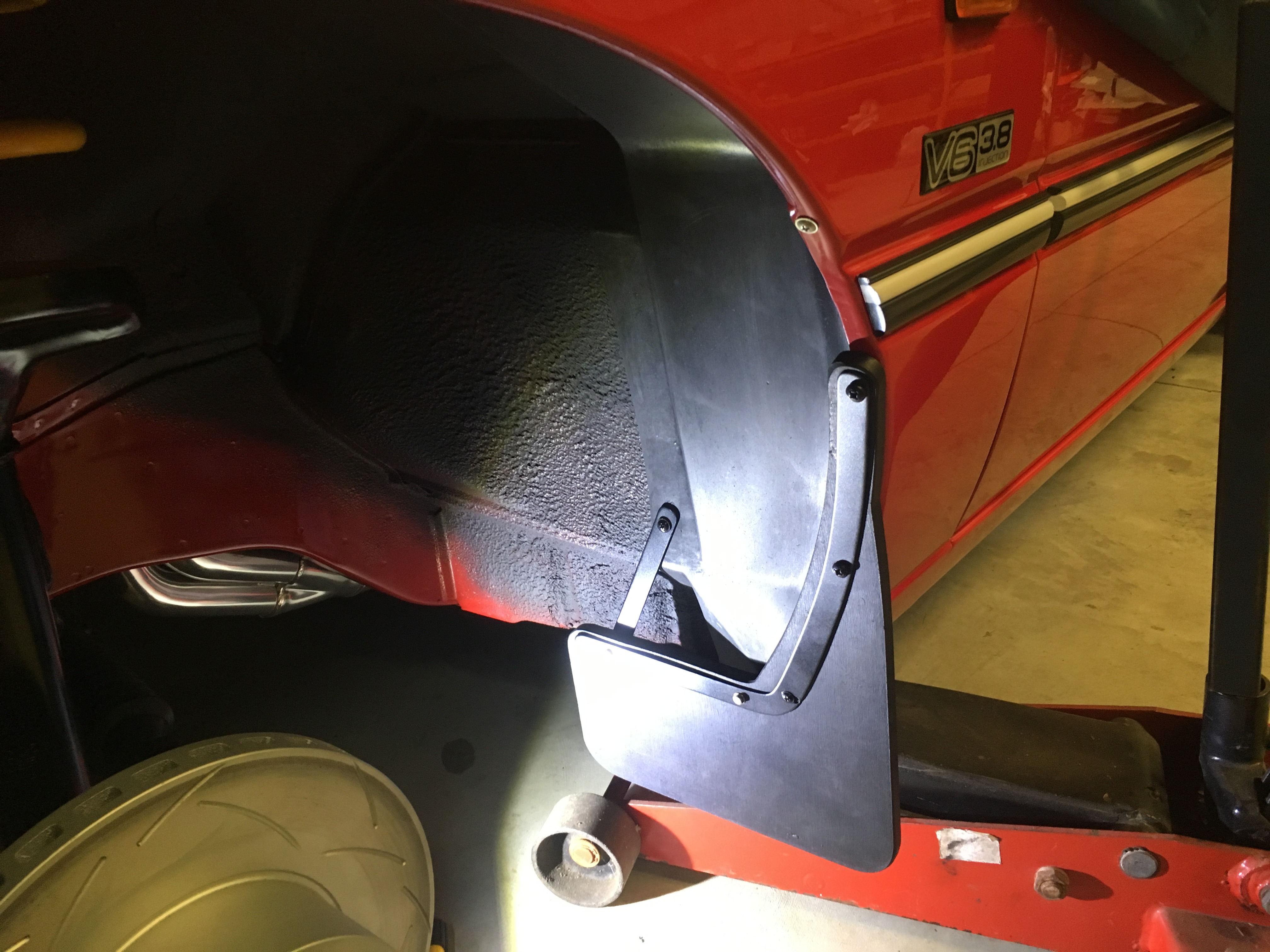

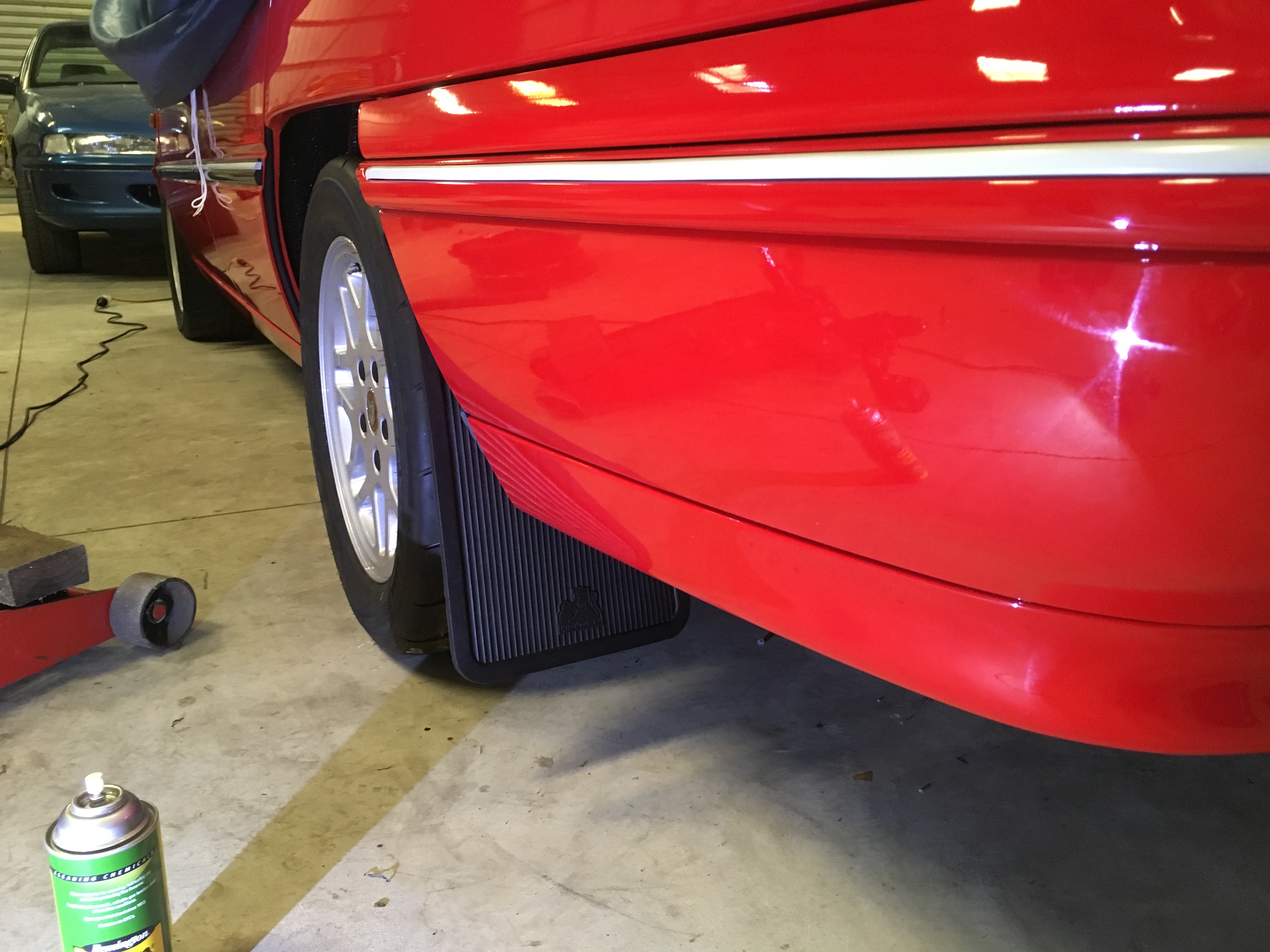

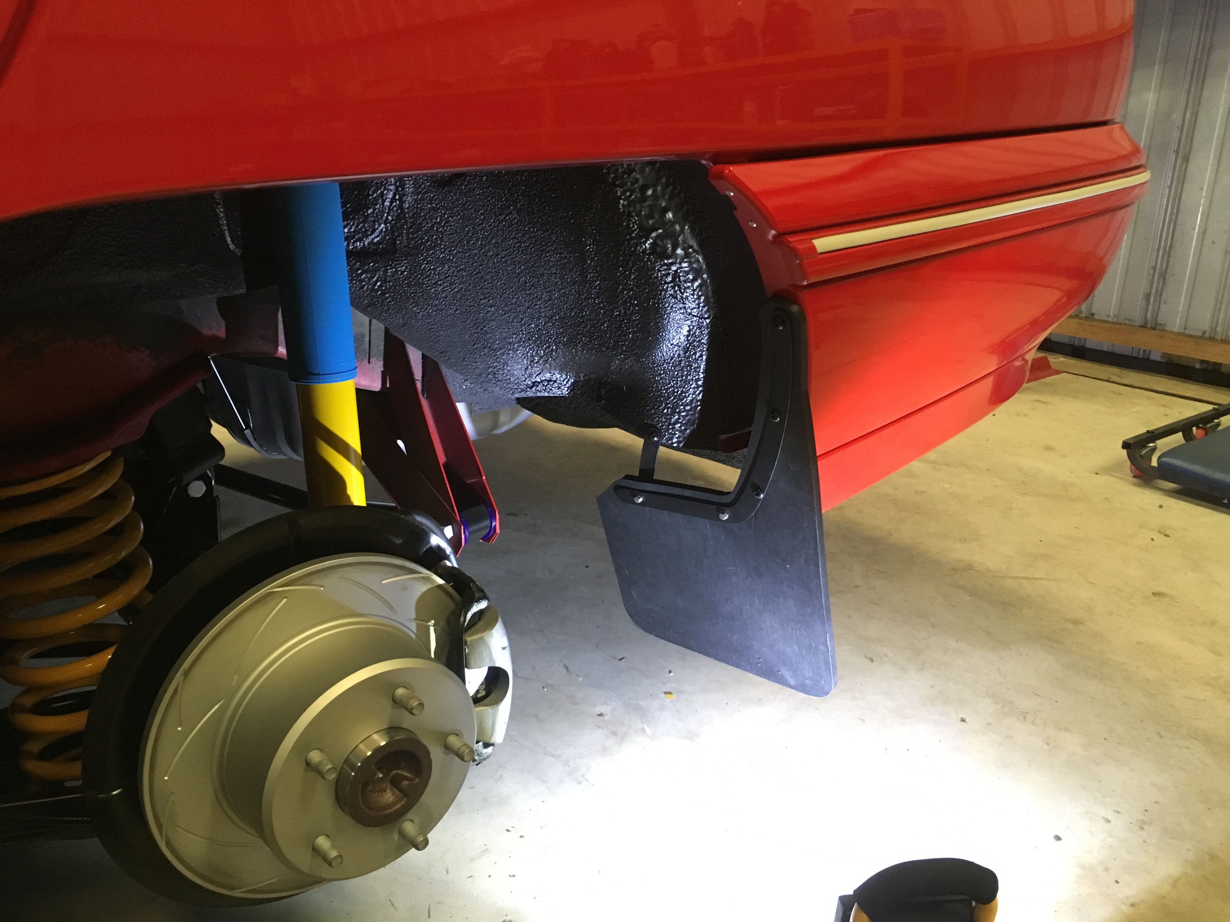

Mud flaps done.

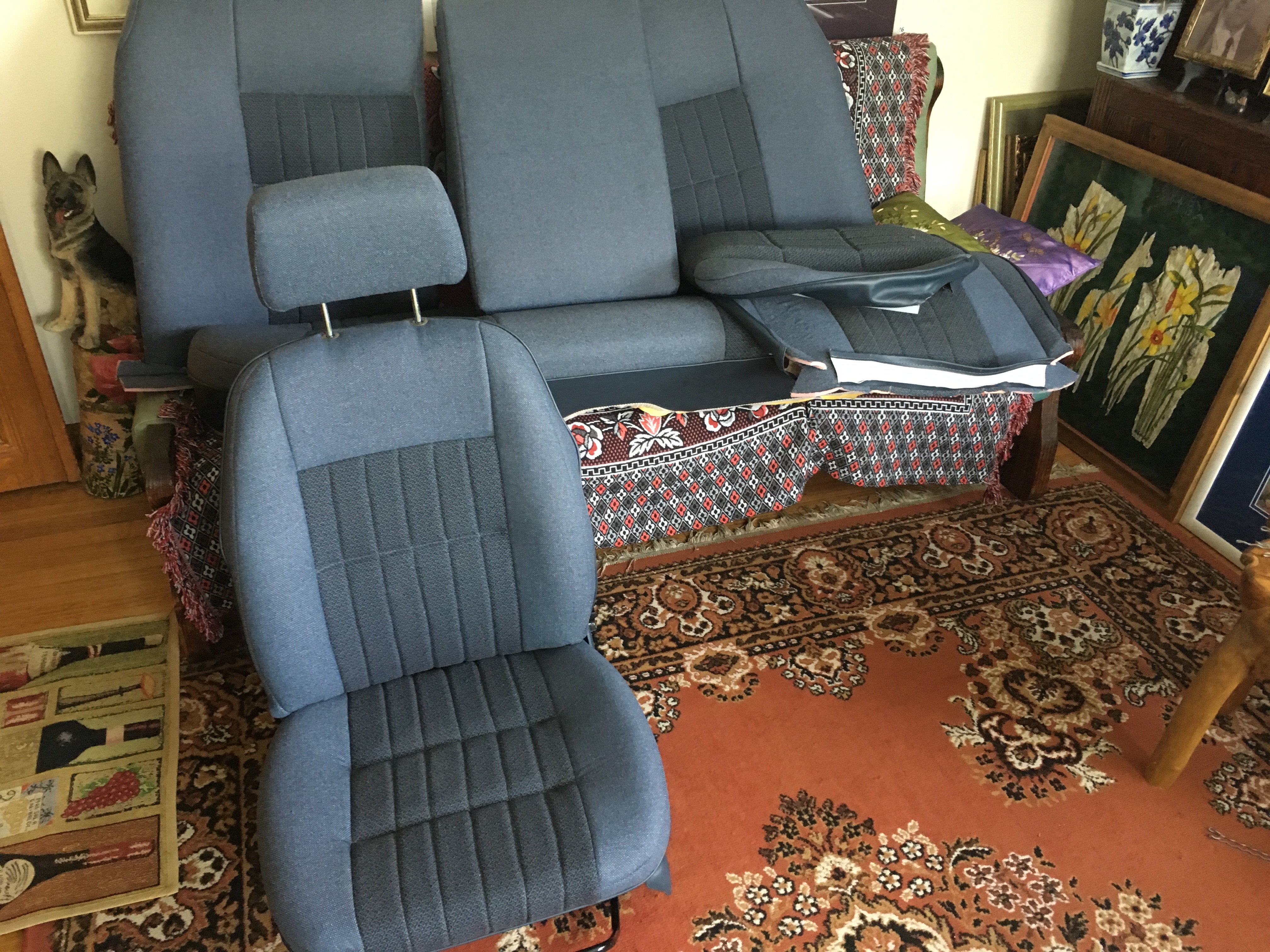

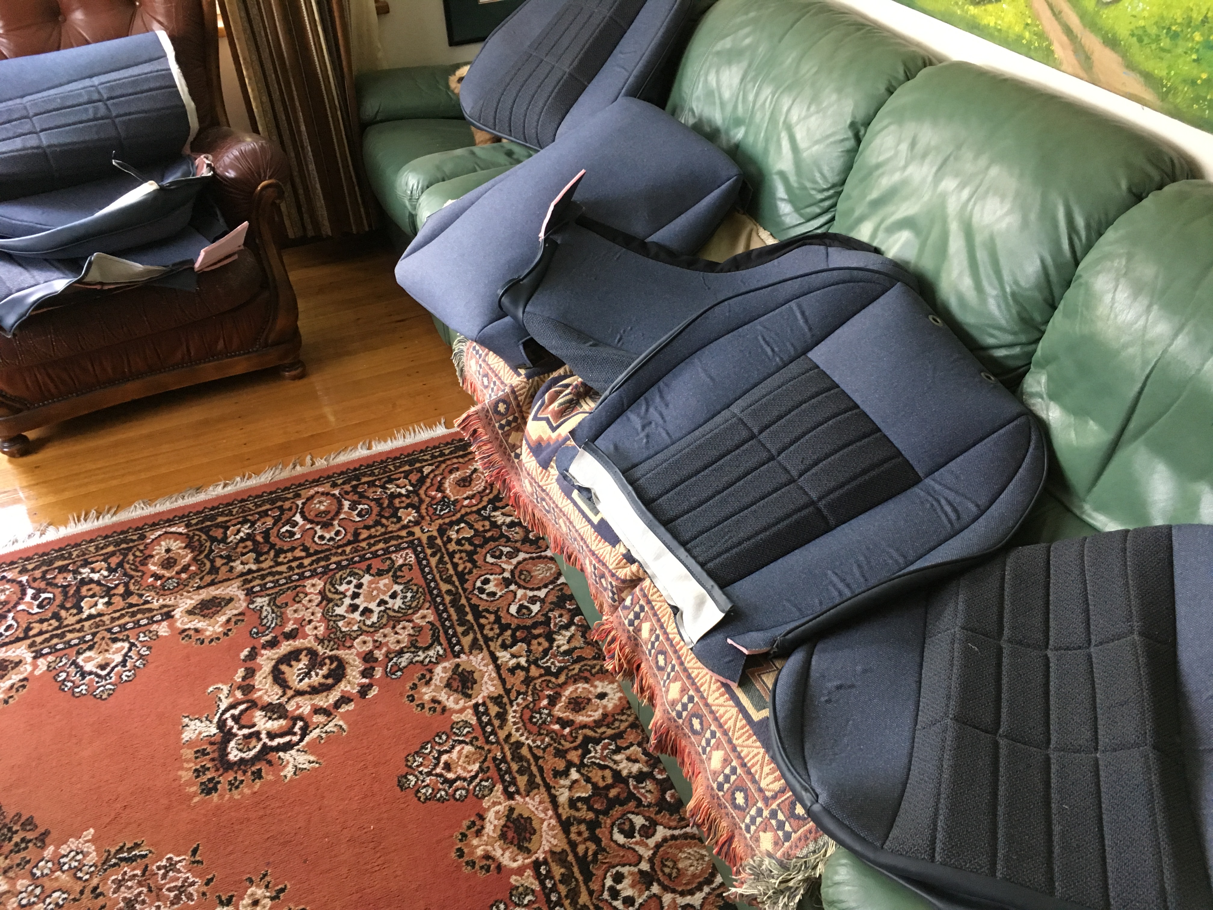

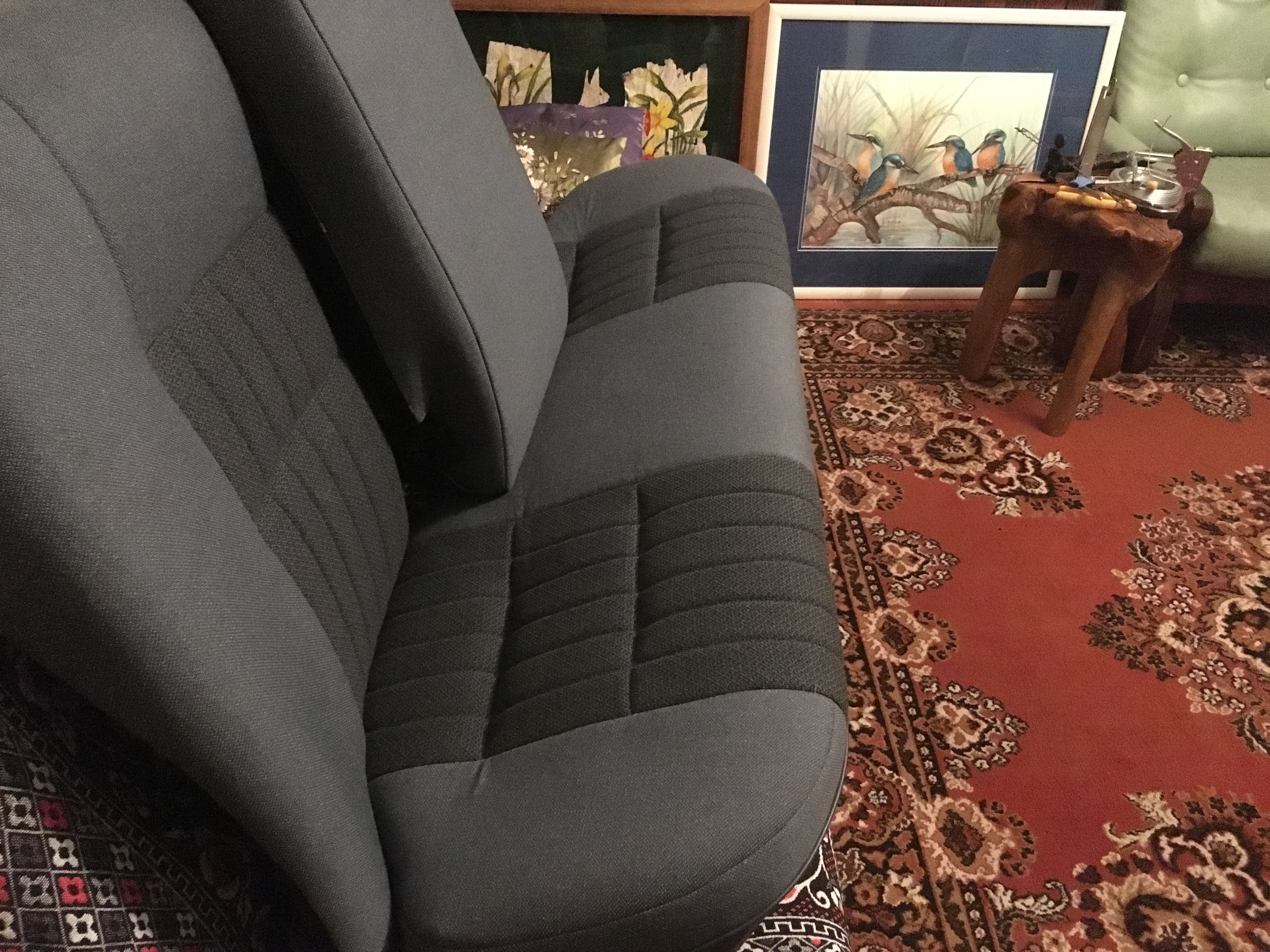

Seat covers are done. Got most of them on now but the rear center arm rest bit had a mistake so the guy is going to correct it for me when I drop it back. The insert plastic strips were in the wrong place so I couldn't insert them into the channel.
Can't do the driver seat yet, my lumbar adjuster mods still not finished yet lol, nearly 7 months for a 2-3 hour job engineering shops for ya. At least they are mostly done so should be finished this week? I'll ring them to give them another (347th) push on Monday. I got a driver seat in the car as a temp so I can drive it which is my best one so I will pull that one when I'm finished with it and install the new covers and new lumbar adjuster.

What are they doing for the seat?
Hard to find any without that annoying freeplay/movement.
- Posts: 7806
The lumbar adjuster? The one I mean is the lever on the side of the driver seat, not the wheel one. They always break off inside the seat so the lever does nothing. I am having the mechanism hinge replaced with a much more solid replacement so it works again and doesn't break off.
