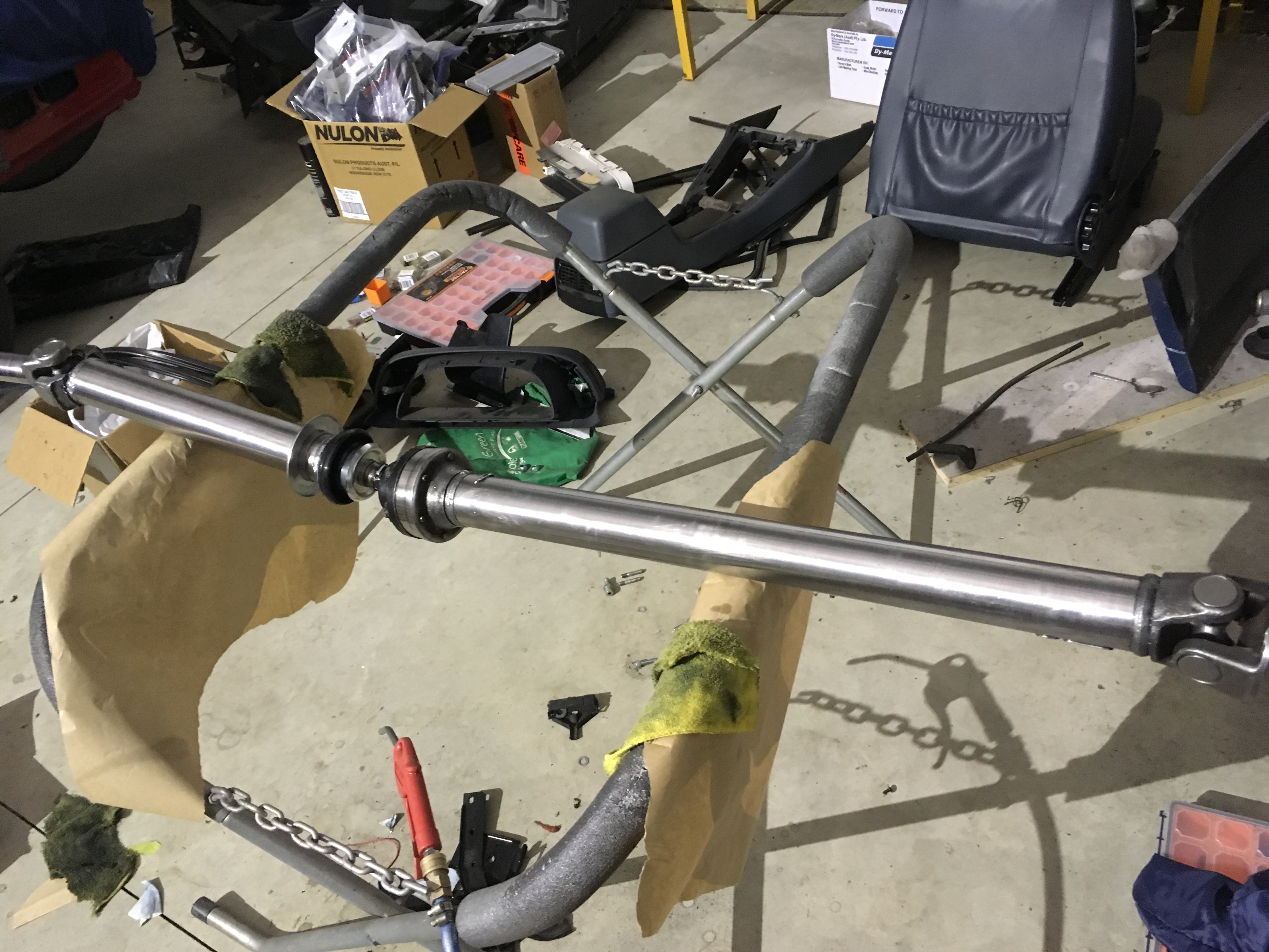

Time for the tail shaft.
Stripped of the shit grey paint from when I had the shaft done. Cleaned up any spots of rust missed. They did a very good job actually considering what I gave them.
Only few pits here and there with bit of rust so not much effort to clean those up.
I used thinners and couple of cloths to wash off the the grey paint.

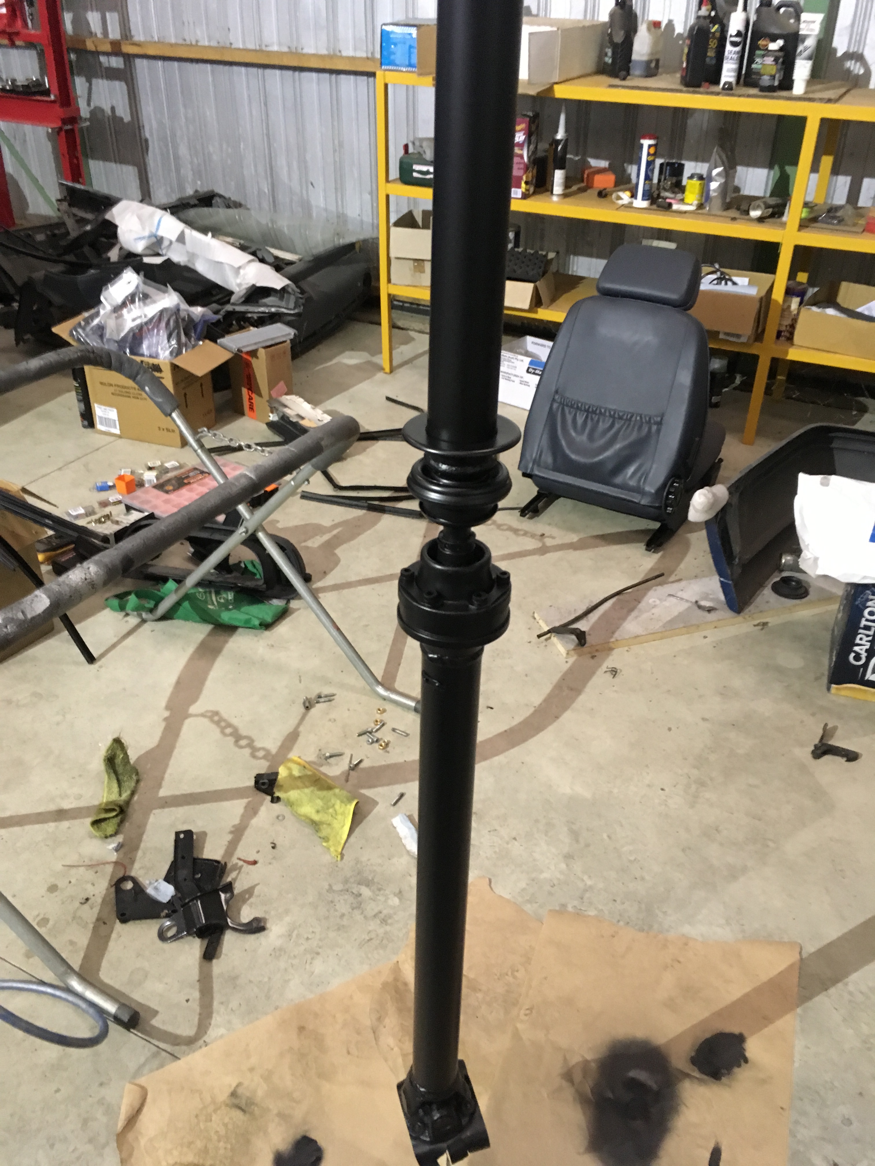

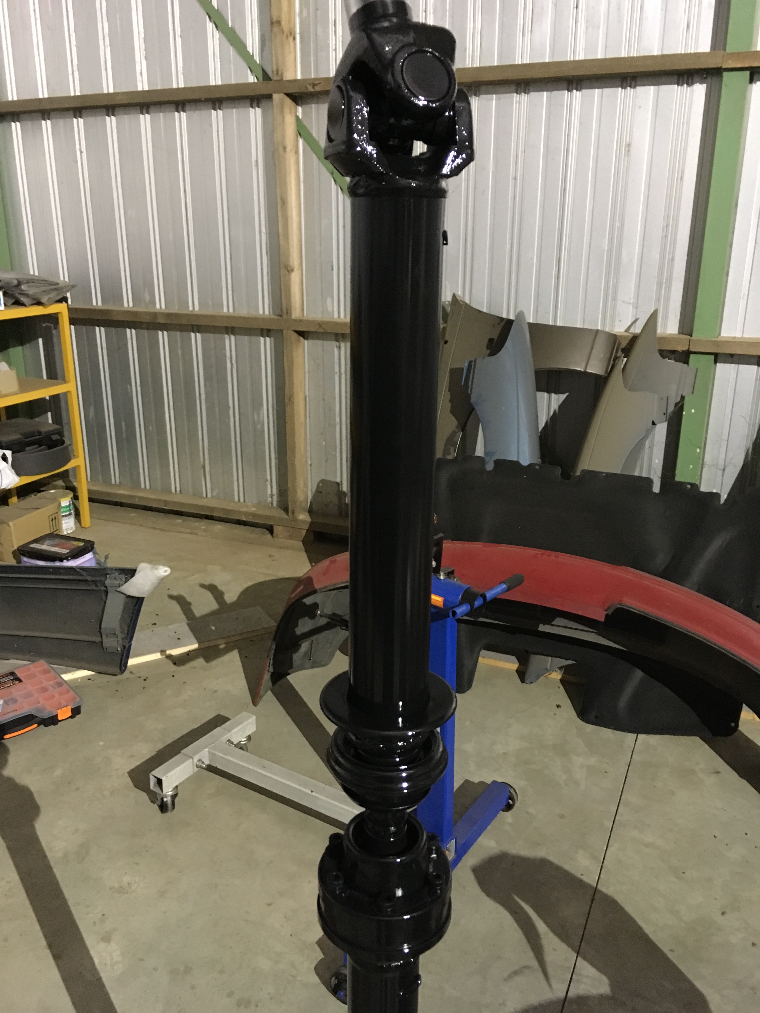

Etch primer.
Finally was able to find someone who stocked the U-POL gloss black. Holy shit this is good paint. Together with wattlyl super etch its super durable and sticks like dog shit.
I did my BMX bits and handles back in 2010 in this combo and its still not worn off or rusted or any sort of adhesion/chipping issues.
The spray nozzles are by far the best I have ever used. Paint comes out like fog and gives an awesome finish and can get into any tight spot, around corners etc..

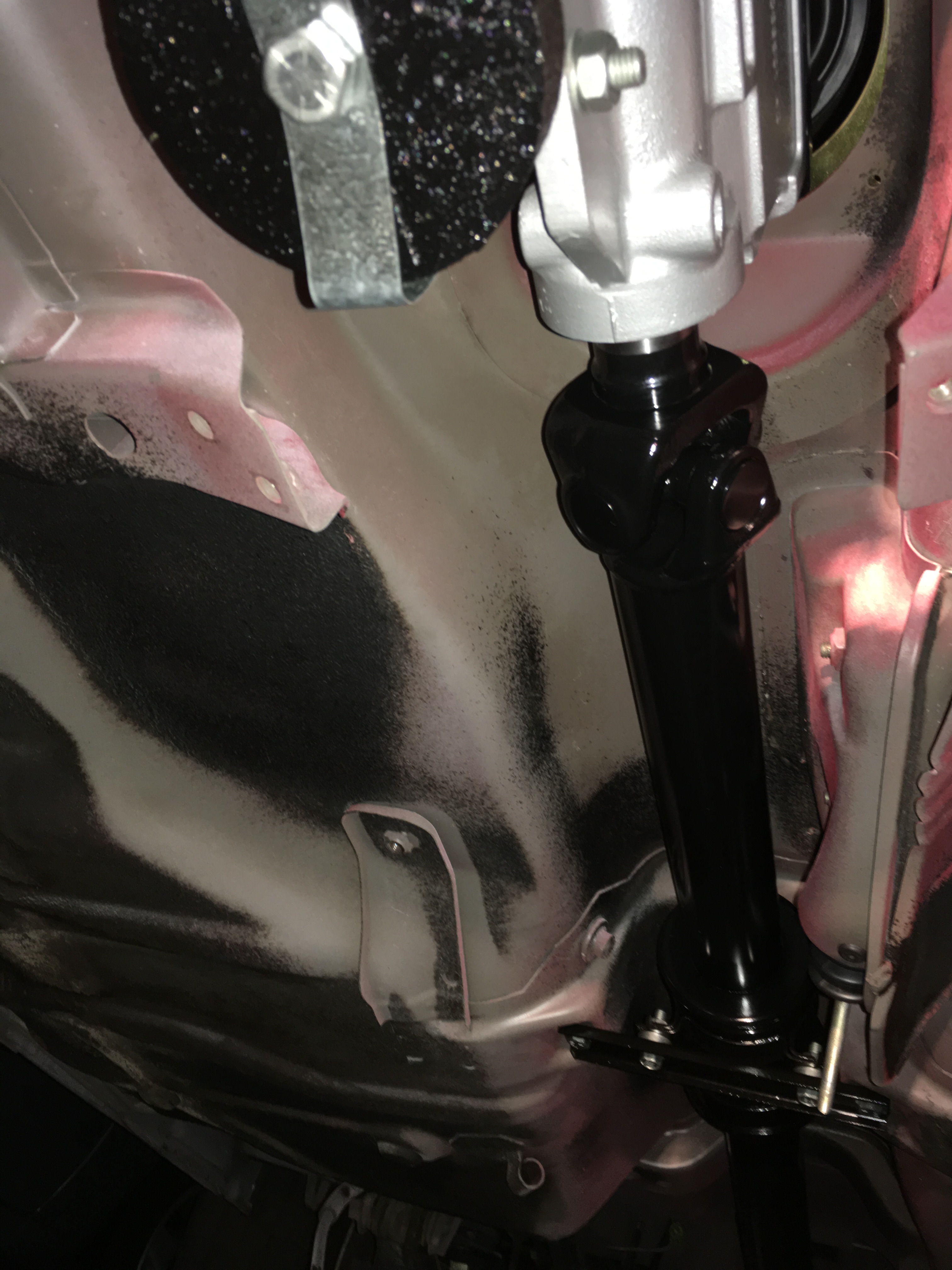

Installed.

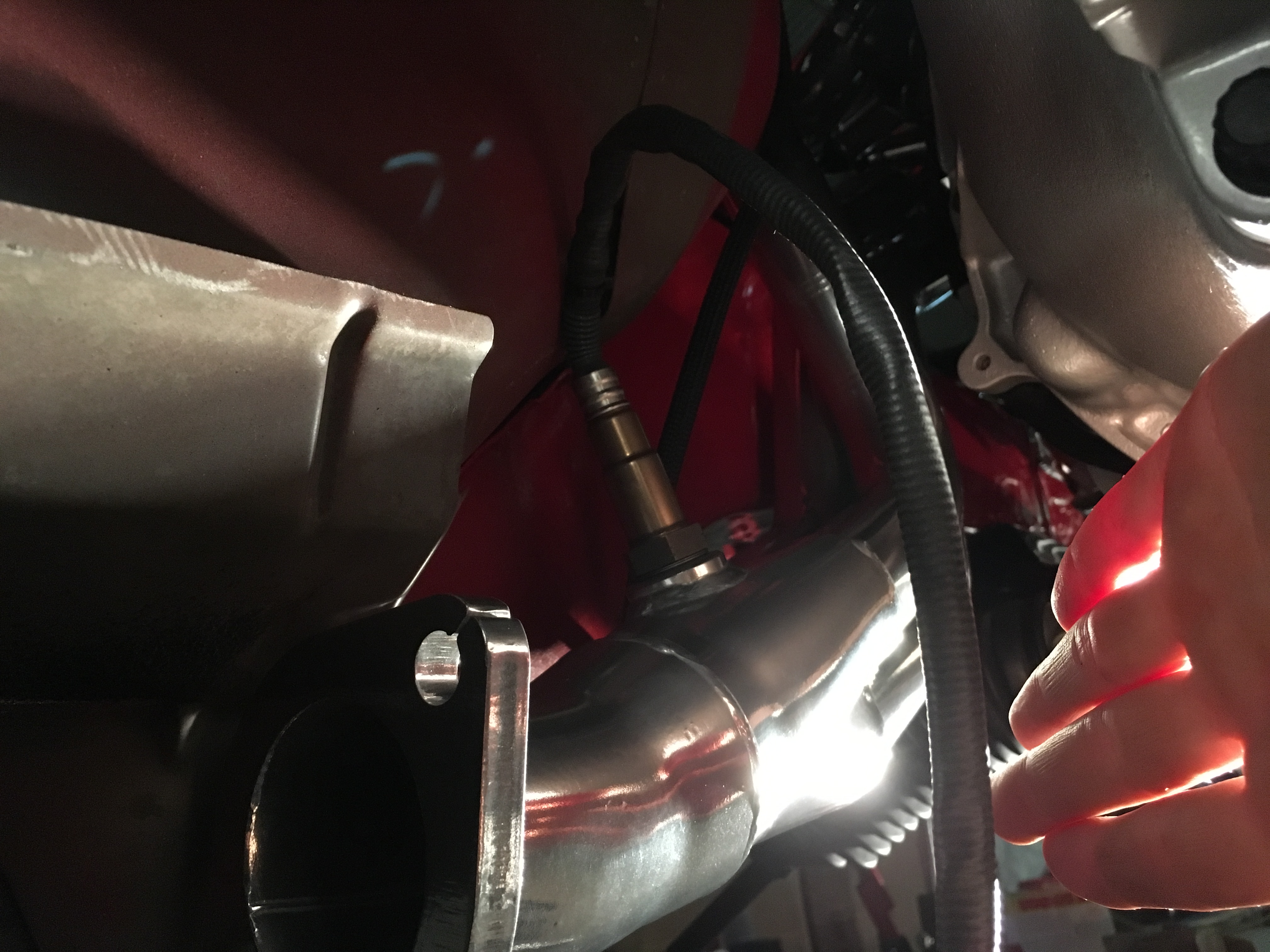

Got a new Delkor battery and genuine 4.9 bosch WB from G.
Bit of an issue here but I will be adding a bung further back on a 45º after the flange as there is a tone of space and the gearbox happens to have lugs with holes right next to the spot so I can clip either a NB or WB sensor/controller sockets straight on the box and the pigtail is the perfect length to reach the proposed bung without cables hanging loose. Win win! oh and be a shit ton easier to install.
As it is now its not good at all. Hard up against the floor. Took me ages to get the thread started because of that, Thought if I screwed it in all the way there would be enough room but nope, still against the floor. damn it!

looking great under there vsh. pity about the os2 sensor.
- Posts: 7804
Yeah no big deal, custom exhaust is needed so it's nothing to add a extra bung in the process.
