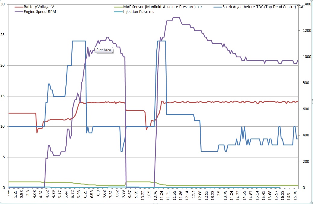

Re: Hot starting issues
Managed to capture a hard start this afternoon. Sorry for the crappy graph but best I could do in excel. I have attached the datalog as well.
Interested in your thoughts
Simon
