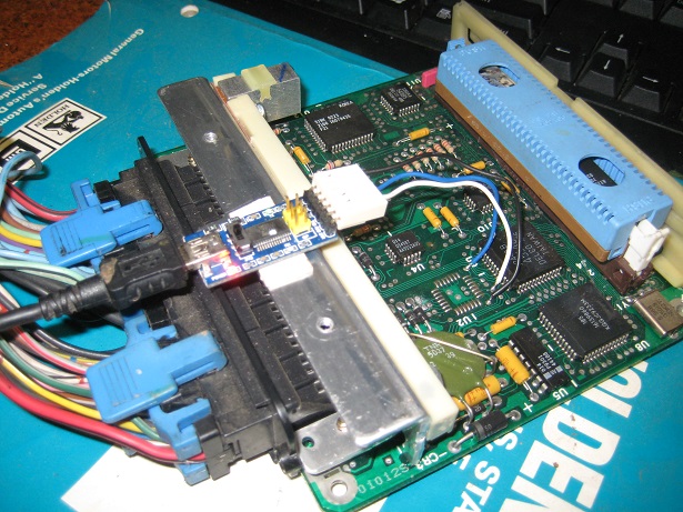

So that went well. USB mod to a spare '808. FDTI chip.

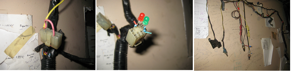

Loaded some 12P v112 goodness onto the flash chip, put some terminals on the power wires, bridged the pink, added some leds
So now I have a delco powered weather station showing room temperature and kpa in TunerPro
Can sitz and watch the blinkin' lights It works perfectly.

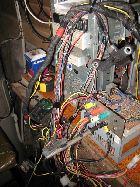

The trusty atx based bench power supplied in service again, loom draped loosely with a zip tie so every can reach. Naturally none of my android devices want to talk to it.... but again,none of mine seem to fully support host mode correctly.

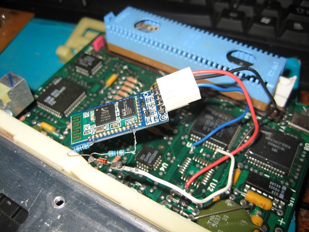

Next is to try is the bluetooth.... that has already been tried without much success though on the ALDL port in the car. A USB 5v charger wired in, and both Rx/Tx on the modual to Pin 9 on the plug.. ground to Pin5. (Initially I had a 220r inline on pin 9 for safety)
ADLDLdroid finds it, and connects to something.. but its not showing anything on the screens. I'm tempted to wire it into the '808 to see what happens.
(Given I want to install an NVRAM into the '808, and if the bluetooth write cal/bin function works... thats a winner for the kawasaki project)
I made a debug log, I'll post it ... something about packet length too short. Looks like somethings corrupted. Cheers.

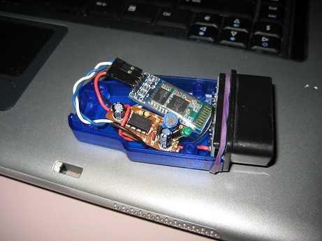

I forgot about that... While planning for this mod, I found a HC06 BT-TTL device which is close to the HC05 used in the 1320Electronics adapter. Hopefully the app will work without further changes. I don't know what other logic is hiding in the black box- but it can't be much.
What I have to play with today, is the levels to the Rx pins... I made a circuit change last night shown on the data sheet for a voltage divider, but I haven't properly tested it. And it didn't connect to tunerpro yet.. that milestone will be key I think.
Others have done it.. my muppet brain has overlooked something the datasheet is trying to tell me.
Or the input is already blown from 5v.

So, I've been mucking with the Bluetooth module... this thing does seem to work, but for now I need one of these I think.
The HC-06 isn't 5v tolerant apparently on the Rx pin, and something like this will correct both levels to the '808.
I expected to simply replace the FTDI mod with a HC-06. Not going to be quite that easy. Stupid CRO isn't working, so I'm working blind.. ironic given I had to get some grit removed by the GP yesterday from my eye from grinding.
