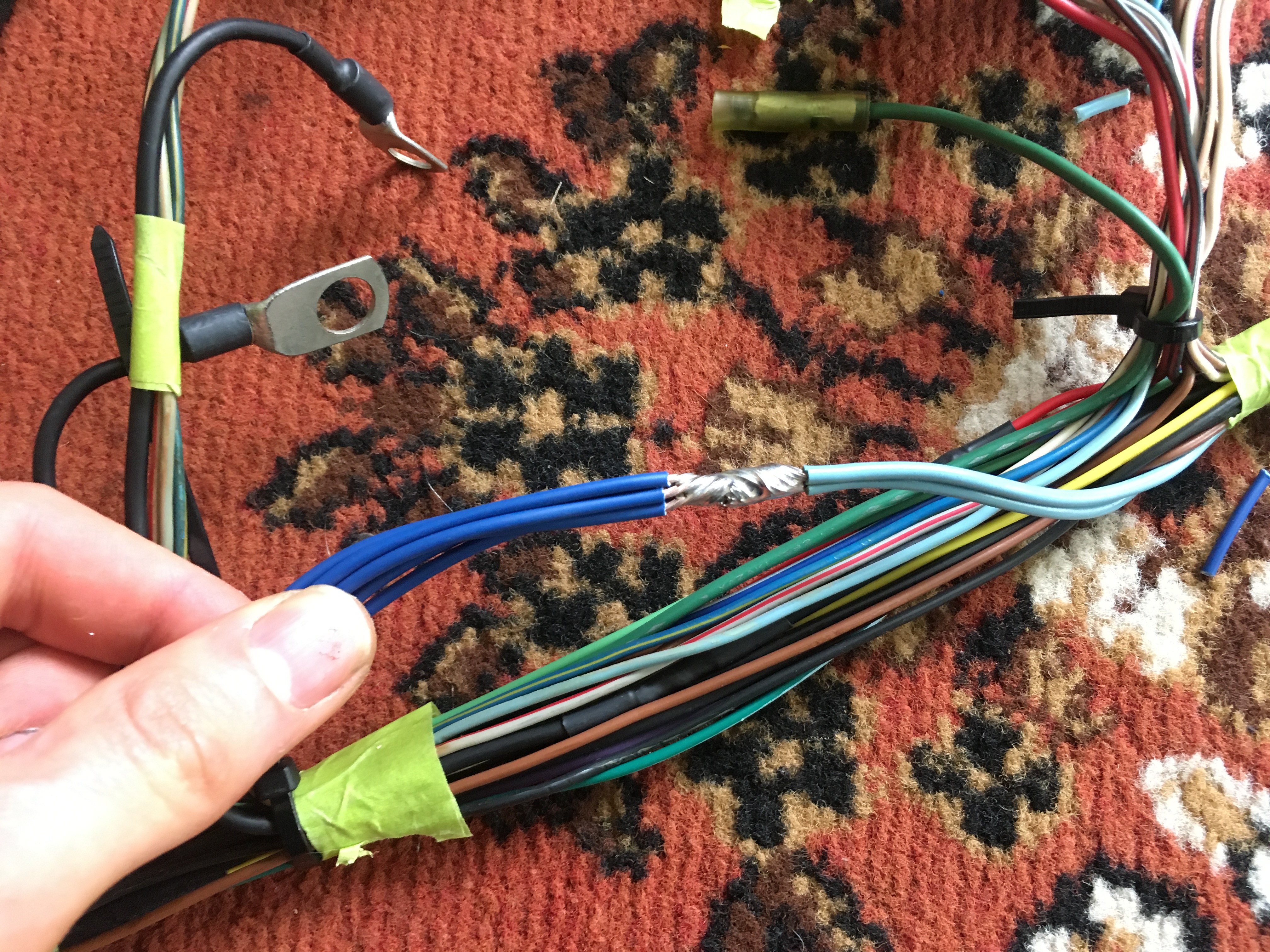

Gday all, does the VN v6 run similar under head bolt ground wires like the CAmira? I was torquing up the head bolts and broke one of the earths, it was already cracked and finally gave up. There are no JE camiras at upullit at the moment but lots of VNs of course.

Posts: 7806
Re: 265 Hemi to efi
Are you talking about the eyelet terminal? if so just get some narva ones from an auto shop and use a propane torch and solder it on the wire.
heff0018
Posts: 888
Re: 265 Hemi to efi
Post by heff0018 »
Yes, Thanks wasnt sure you could get them that big.
Posts: 7806
Re: 265 Hemi to efi
You can get them as bit as you want.
See this pic of how I did it.
The crimp for the wire is a bit too big and is why I soldered it and then put heat shrink. I filled the entire crimp with solder. I recommend to strip the wire twice as long as the crimp and fold it over so it pushes in tight enough not to fall off, then solder it by heating the end with a torch.
Make sure if you use heat shrink to place it on the wire first and push it way up the wire as the heat of the wire will shrink it before you want to if its closer than about 100mm.
By the way, good idea to use star washer with these type. Wurth is where I got mine but I am sure Jaycar or similar should have them.
