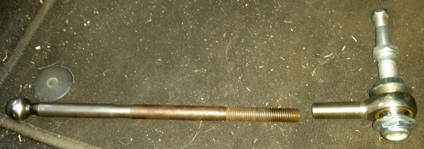

Thanks to Biggvl for the hot tip, i purchased these, they go in place of the tie rod end, and then you fit a hyme joint to the end of the rack end, and then you can adjust bump steer, i am also hoping i can use this option to fit a hex threaded bar to the rack end, then a male hyme joint so i can get the 1-2 inches longer i needed for the rack ends plus fix the bump steer at the same time.
- Posts: 10311
another step closer, got the rose joints today, now need to get a machinist to make me up some metric to imperial hex adaptor shafts then I should be all sorted for the steering!

Adjustable tierod very cool!!!
Ages ago some dude on pf posted you could buy those things...he was building a vc drift-wagon with sr20det
