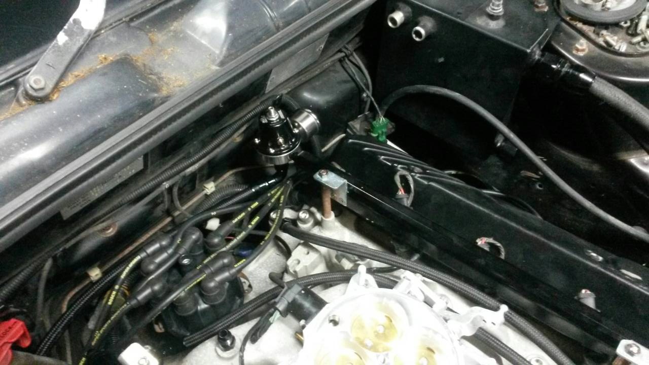

Solved the FPR problem today with clearance to spare. I'll probably rotate the FPR so the gauge faces the dizzy as it's a bit hard to read in it's current position but that's no biggy.

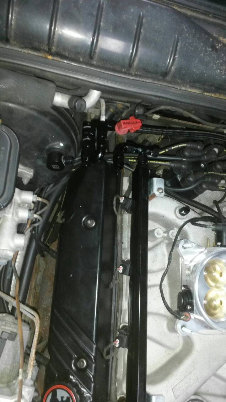

I think I have solved the fuel line fitting space issue. Just need to make up a flexible line between the fitting on the fuel rail and the hard line.
The only thing I'm not sure about is the tight radius on the flex hose.

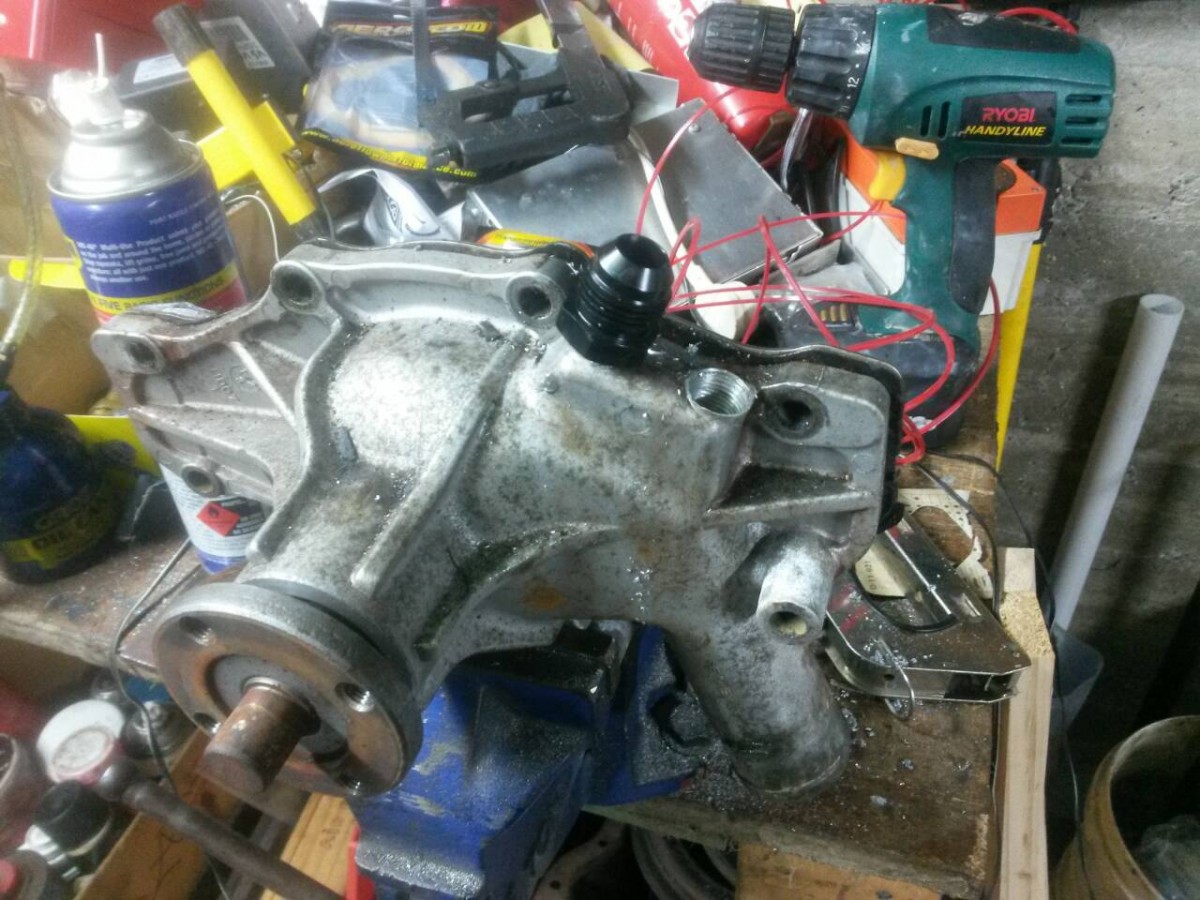

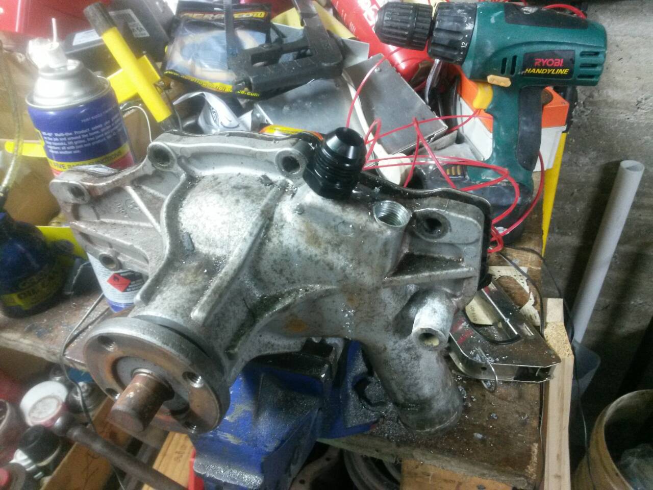

Did a test fit for an AN fitting on the WP this afternoon. Used an old WP to experiment with, need to move the holes a little to get into the meat of the body but it's not a problem drilling and tapping to suit 3/8" NPT.
