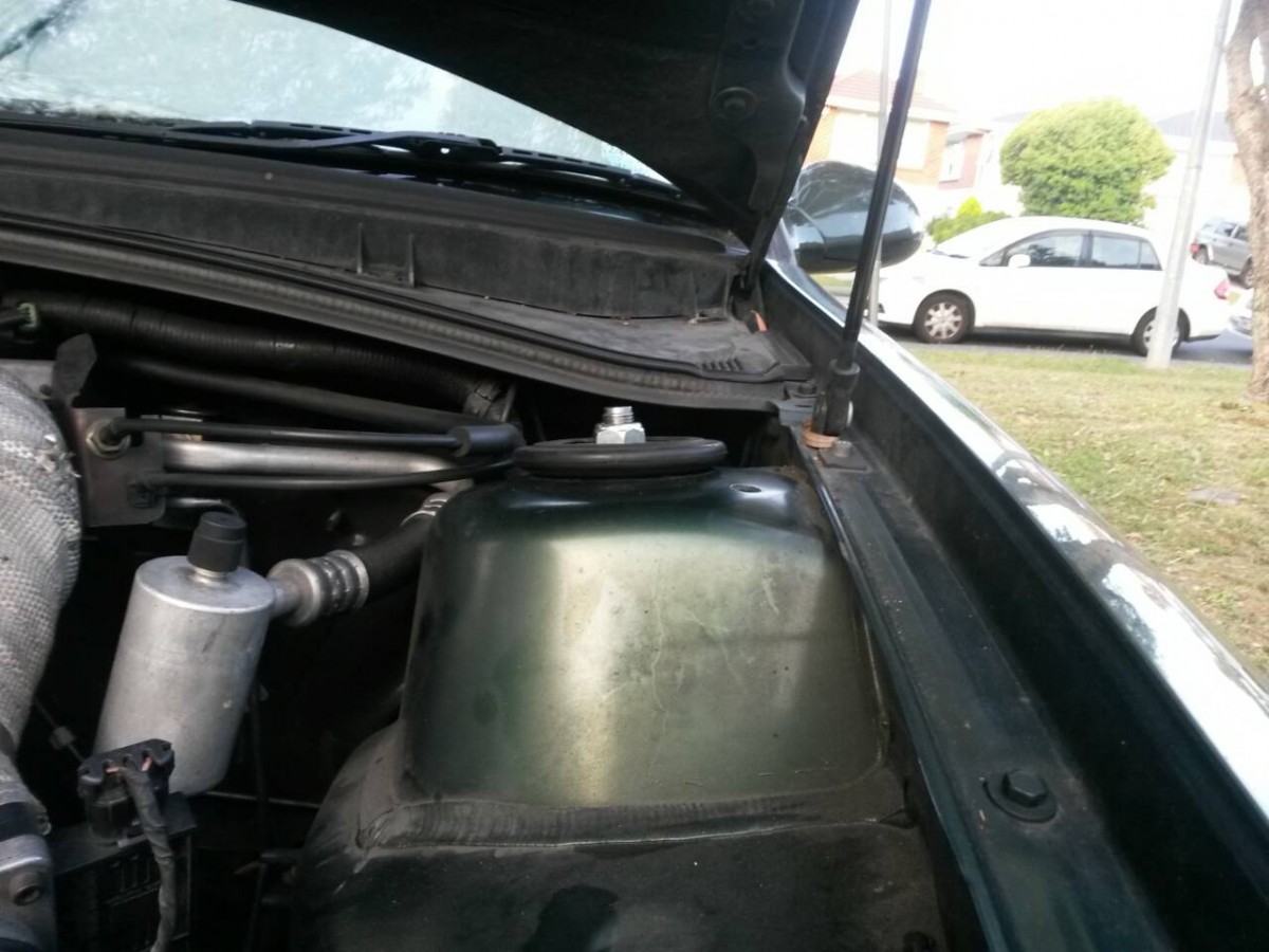

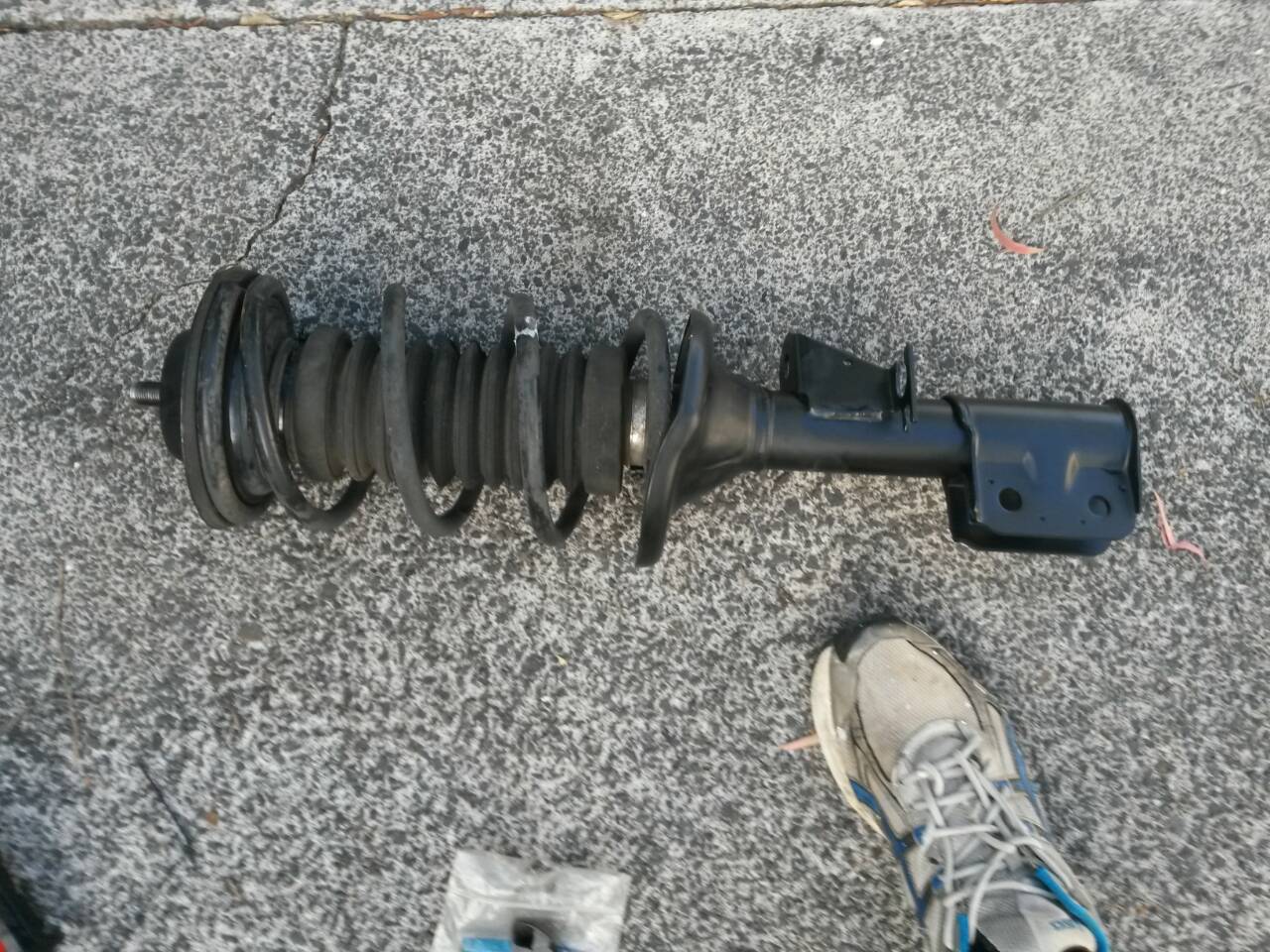

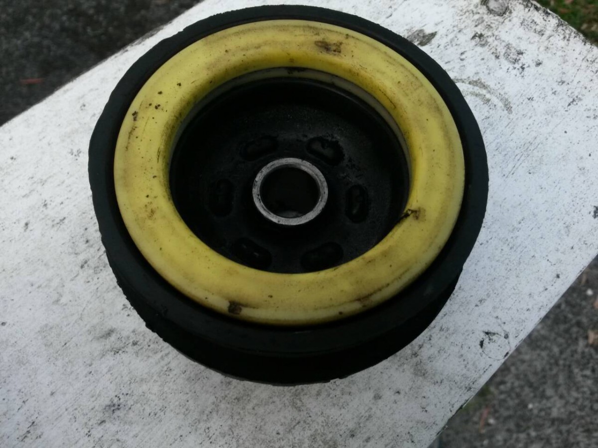

Car got a good run on this week, ended up doing just under 600km for the day and the engine ran really well, the suspension was a different story....
Just fitted new front struts, strut bushes and bearings which has definitely got rid of one knock but now it has developed another although I think it's a sway bar bush as it only happens when steering is near full lock going in/out of a driveway etc.
The passenger side top strut bush was totally shagged, the steel inner was floating in the rubber. The bearing on the other side fell apart to when I took the tension of the spring.
New KYB strut. Old top strut bush Nice even strut top gap (was about 10mm with stuffed bush)

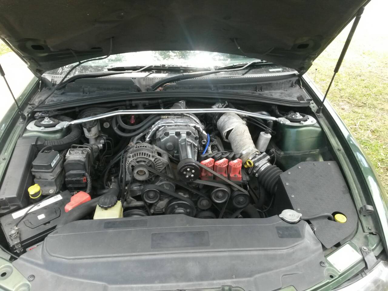

So I finally got around to a job that should have been done 18 months ago , never mind, it's done now.
Can anybody see what is fitted incorrectly?
With these most recent maintenance items checked off the car is feeling much nicer to drive again.
With the 25mm blower spacer fitted there just over 5mm clearance between the bottom of the strut brace and the fuel rail bracket on top of the blower.Can anybody see what is fitted incorrectly?

Isn't that a V8 top panel over radiator?
- Posts: 3426
- cars: VH, VN, VS, VX
We work so hard and they don't even notice the improvements....psyolent wrote:ah. the knock. yes catherines VX has that knock as well.
i replaced the Z bar bushes on the front as they were completely flogged out and fell apart on me when i removed them.
all the BJs and other bushes in it appear OK but i've not checked the swaybar chassis bushes or the link pins. might have a look at them. that said i did the tower bearings and struts about 18 months ago.
Yep, I've just trimmed the end off by the MACE cold air intake and radiator cap.L67PSI wrote:Isn't that a V8 top panel over radiator?
