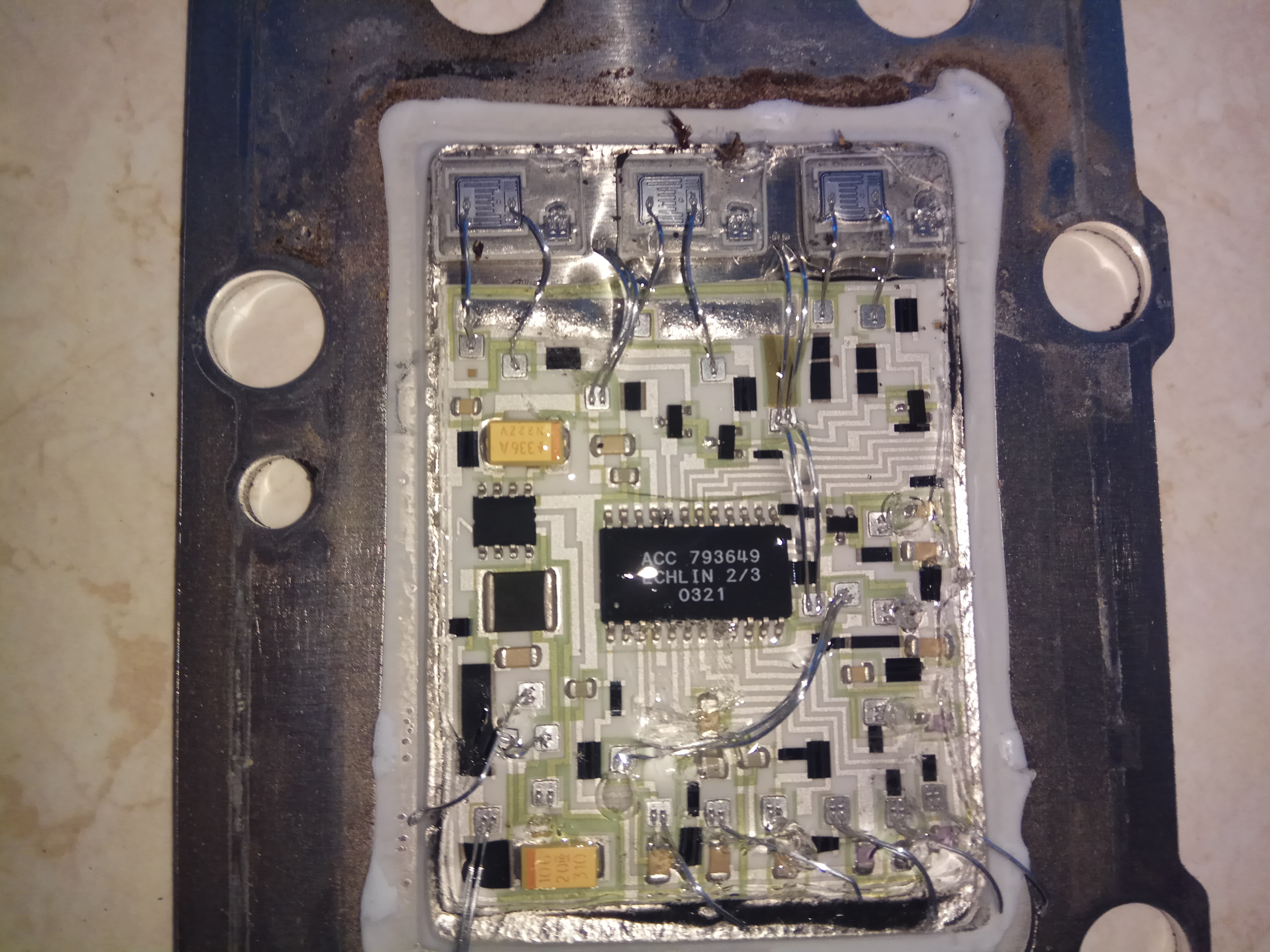

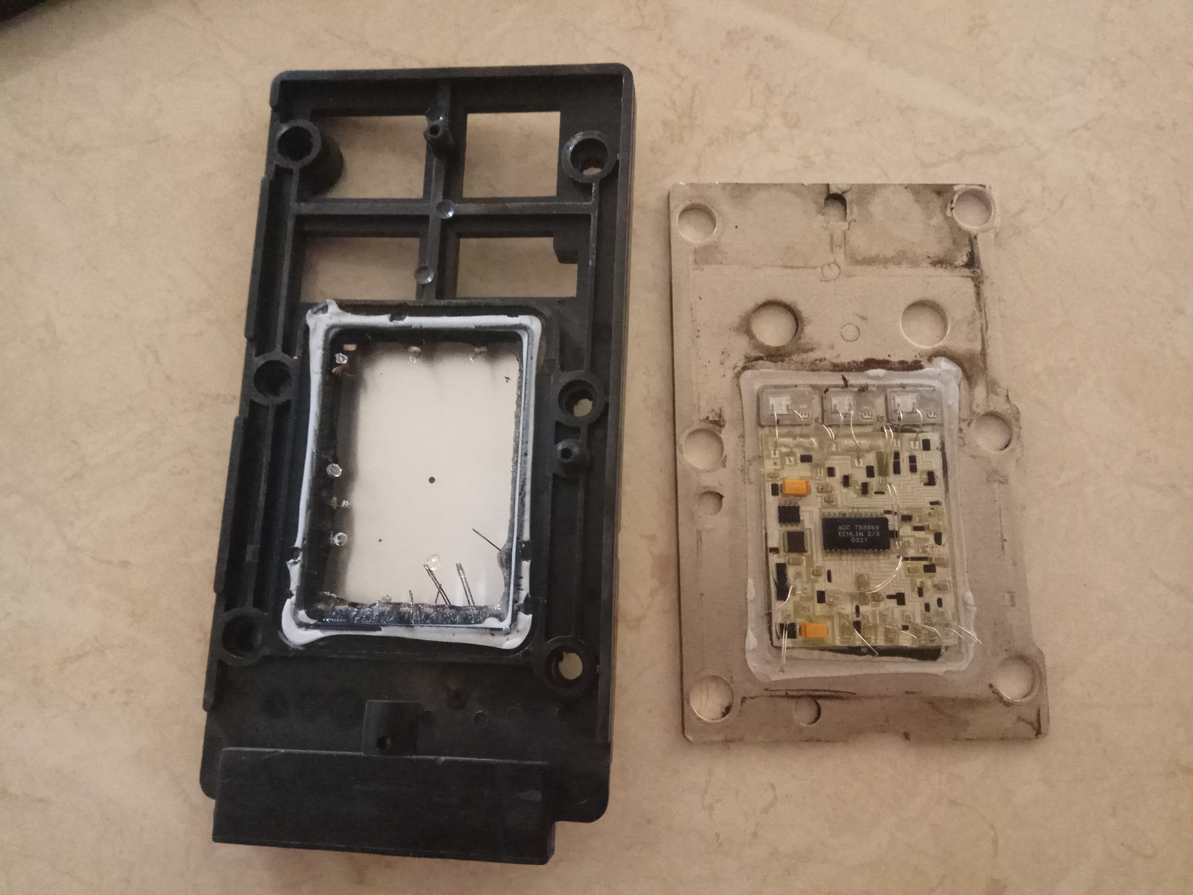

Yeh Vlad beat me to it, not expecting any difference from blues either, I cracked open a faulty dfi for a look
