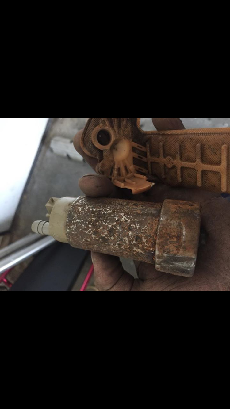

Check that out. That’s the original pump I pulled out of it lol. I honestly haven’t seen a pump that bad before. I’m thinking the previous owner ran it on e10 or something similar

Wade wrote:Check that out. That’s the original pump I pulled out of it lol. I honestly haven’t seen a pump that bad before. I’m thinking the previous owner ran it on e10 or something similar
I ran my first VP for years on E10 and it was absolutely pristine, far cleaner than I got with premium fuels as I ruined that tank and 2 more within 3 years of using premium 95. it wasn't just a servo as I tested exclusively a different servo each time I had to replace a pump and or tank as well as it filled with some corrosive red stuff. I changed to 98 premium and the problem went away, E10 certainly had 0 issues and as mentioned actually left my first tank like brand new. I removed to fix the vapor lines and to replace a noisy pump that otherwise still worked fine, just had an annoying howl.
