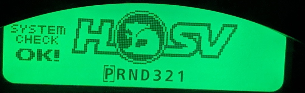

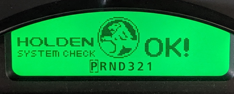

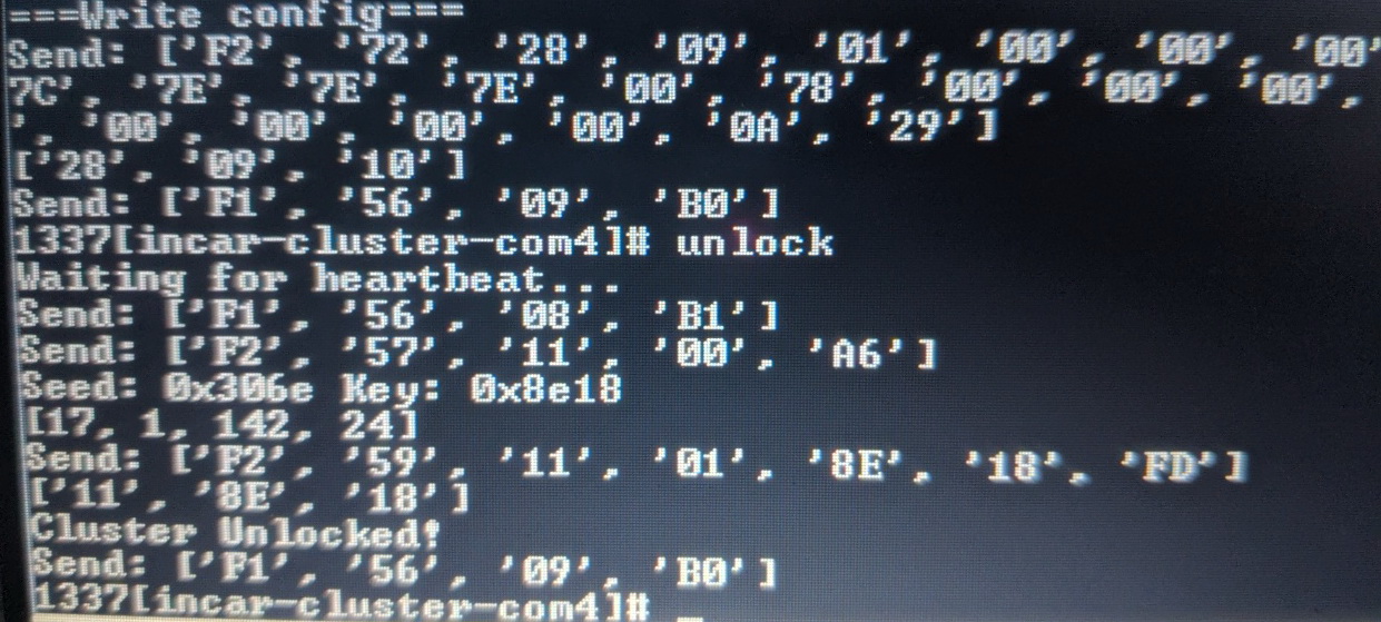

I know this VY Cluster post is old but hoping I can contribute I've seen a few posts about taking the cluster out to program I tried out the 1337vending vzclustermod incar it all seemed to be working as per the steps in the txt file - could rear / write but the changes didn't take effect, getting no error...
I put the dash into the test mode by holding down Mode+Set turn on the ignition press the mode until the last display when ALL of the dash come on with the BEEEEEEEP.... and then make the changes all I was after was the HSV start up, Now when I startup I feel special, it 100% works in the car with the dash in the test mode
