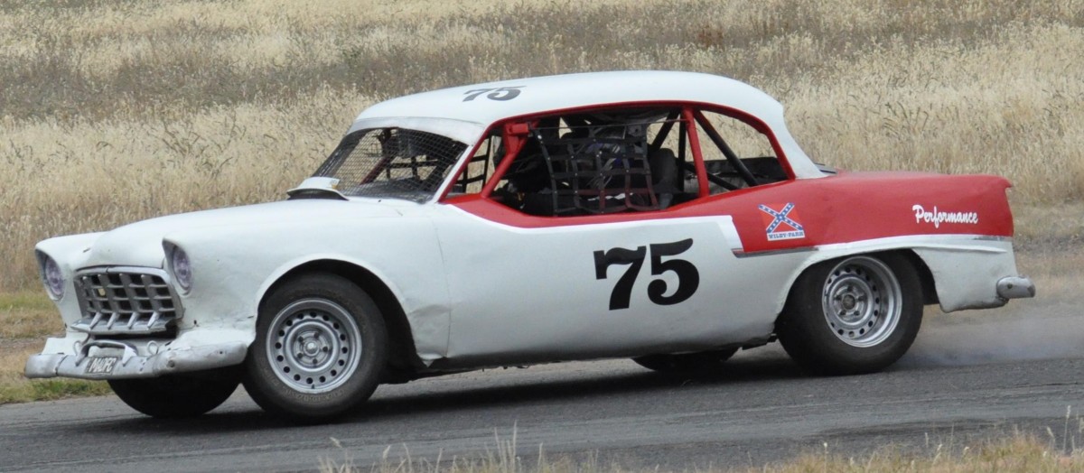

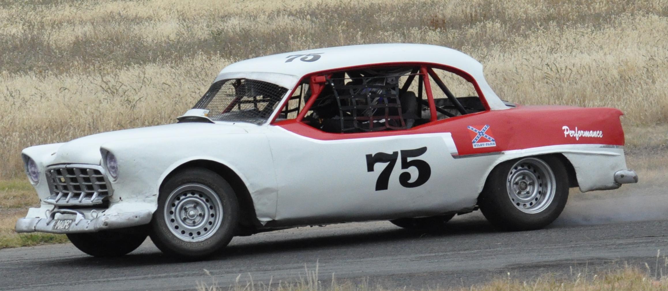

If I take the front off the motor I would replace the timing chains at the same time, Ive done that before it's a real pain! But the chains have been done in this engine before. I'm going to try the locking method and if the chain slips I have no choice but to do it the long way I guess As long as the cams are locked and the chain don't move should be all good!
I'd get an ls1 for racing my mate runs one at wilby park in an FC Holden with a commodore chassis and an LS1 it flies!

That is a scarey pic.... I know of the car and yes it does fly. As far as the LS1 goes the class for my daughter will not allow it. So i have to play on the v6 side. I might even have to go 4 cylinder yet.... she is 13 so is fairly restricted. Once she is 16 then yes I can get her into the v8. Although I suspect she will have a brown pants moment and will not get back into the car. Ideally I woudl love to build her a datsun 1600 running the patrol v8, but they are very hard to find and stupidly priced. I expect I will most likely start with a KE70 or KE55 corolla and then look at the 1u 0r 3u v8. Would love the lexus 5.7L but again stupid coin. Reasons for this is I would like her to be eventually able to qualify for vicv8's. I was considering a mx5, however mazda do not really have a v8 option thus it becomes a short time plan.Madmatt2006 wrote:Hi Oldn64oldn64 wrote:Honestly Matt,
