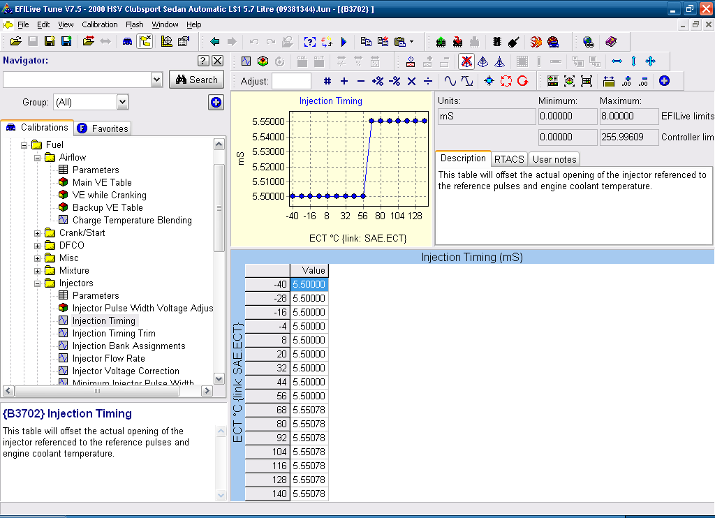

Been away from home for some time now, so using alone time to familiarize myself with a parameter within the ls1 tunes that I find little mention of here or other forums, plus the info I've found isn't definitive.
The end of injection timing in EFILive is referenced in mS, a total of 8, and in HP tuners defined as reference periods, again in a total count of 8, leading me to think that each single unit represents 90 degrees of crank timing.
Why EFILive reference it in time (mS) makes no sense that I can rationalize as the differing crank speed means differing timing settings.

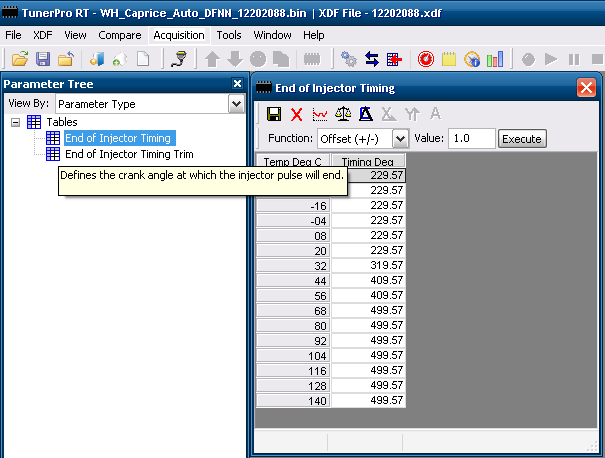

Dimented 24x7's 2088 XDF states
I would suggest you use his XDFs as they are very high quality.
It also has it as a 16 bit value, with equation (X/256)*(720/Y).Defines the desired point at which the fuel injection pulse will be completed by. The value is the position for the current cylinders next firing pulse in degrees after the current cylinders last reference pulse. By altering the position fuel is delivered, the fuel is given sufficient time to vaporize before it is ingested."

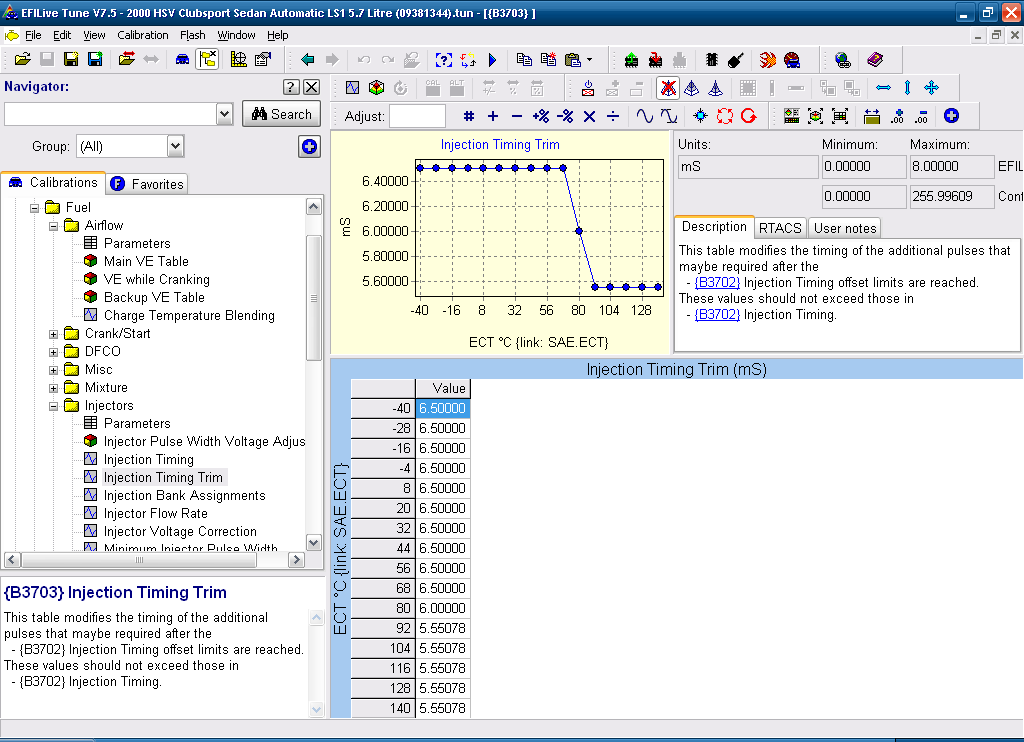

Also, according to EFILive, the trim setting isn't supposed to be greater than that of the EOIT setting, yet it is in the VX HSV tune from GM, I'm finding lots of contradictory information regarding this feature both online and within the popular tuning programs themselves.
EOIT. EOIT Trim.

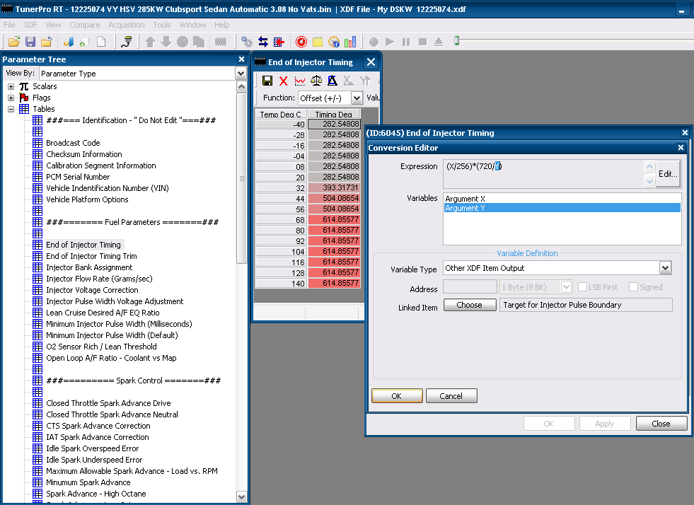

I recently found and looked through Dimented 24x7's 2088 XDF, the "Y" variable in the equation just seems to be referenced to cylinder count, odd for an LS1 tune, whats even more odd about that is if I change the cylinder count to 6, the 720 degree limit becomes 960 degrees.antus wrote:Dimented 24x7's 2088 XDF states
Other research has led me to thinking that the "Y" variable might be the Scalar "Target for Injector Pulse Boundary" if at all it's meant to have a "Y" variable.
Dimented's XDF: The same outcome could be achieved using a math sum with either
X / 2.844444
or
X * 0.3515625

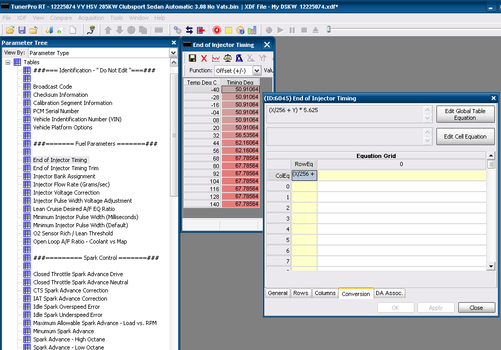

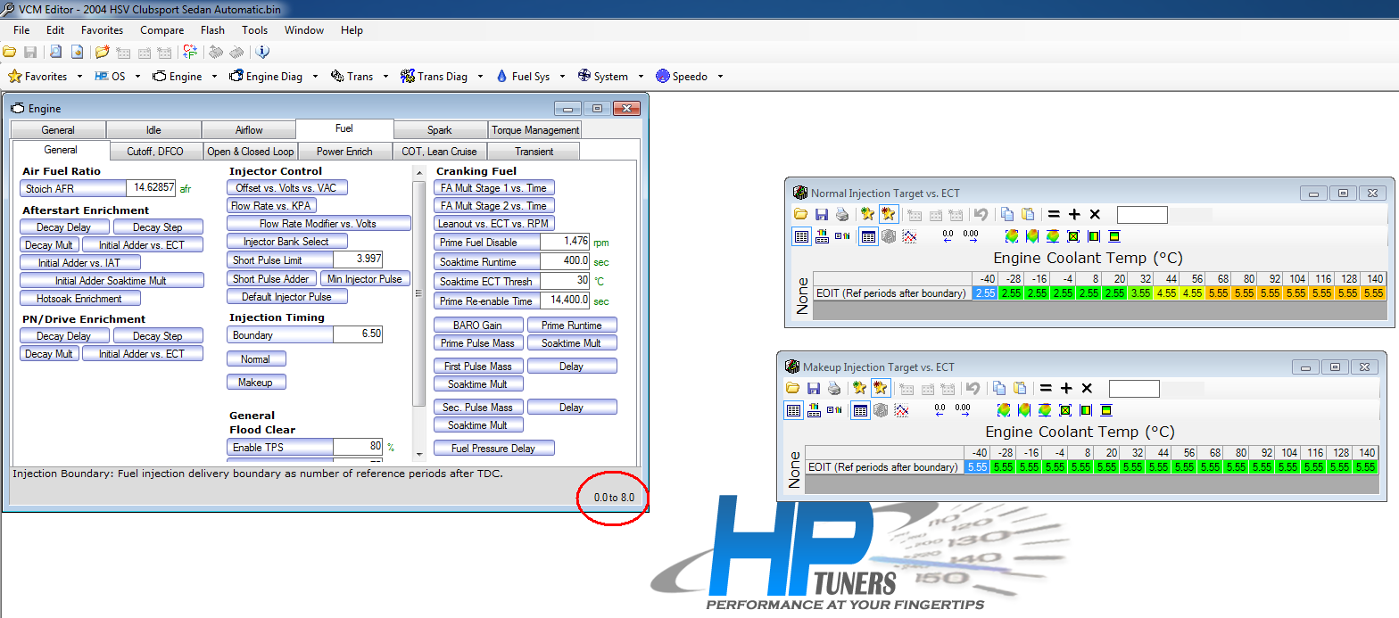

Posts on other forums have led me to believing that the boundary is a part of the math equation.
VCM Editor also shows the Boundary as being a part of the group associated with the Injector Timing options: If the Boundary is the "Y" variable, the math sum used in Dimenteds XDF gives errors when pushing the upper and lower boundary's of options, regardless of whether or not an upper and lower limit is set in the XDF, and just shows the word "inf" in the box of converted string.
However, using a math sum of "(X/256 + Y) * 45" and using the boundary as the Y variable, calcs spot on when setting the boundary to any of the upper and lower limits of 0 to 8.
This is using Dimenteds math sum and boundary as Y variable, the scale of timing ends up rather large: Though using the equation I showed above: "(X/256 + Y) * 45"
Ends up like this below, the scale of which is much narrower, and calcs without error when using the max upper and lower boundary options:
Though this is all just a calculated guess on the research I've done so far, the jury's still out.

Mystery number 1 is the "Injection Timing Trim" does nothing after moving it no matter what bench conditions we could apply to it.
