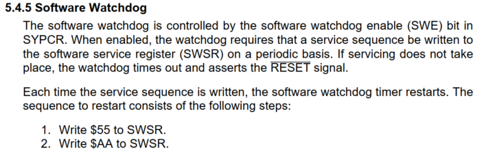

any one know where this data came from or if its just arbitrary numbers?
void ScratchWatchdog()
WATCHDOG1 = 0x55;
WATCHDOG1 = 0xAA;
WATCHDOG2 &= 0x7F;
WATCHDOG2 |= 0x80;
its from the hammer kernel
Posts: 8253
Re: V6 ability for pcm hammer.
WATCHDOG1 and WATCHDOG2 are register addresses defined here https://github.com/LegacyNsfw/PcmHacks/ ... mmon.h#L20 found by disassembling factory code. 0x55 and 0xAA are from the code and the DLC data sheet, and are just picked by Motorola as the magic values the hardware checks for to know the code is alive. Probably because:
0x55=01010101‬
0xAA=10101010‬
ANDing with 7F where 7F is 0111 1111 clears the high bit and leaves other bits as they were, and ORing with 80 which is 1000 0000 sets the high bit. So were toggling the high bit. The factory code uses bit set and bit clear asm, but there isnt really a way to specify those opcodes from C, though we could have inlined some asm like:
asm("bclr #7,($FFD006).l");
asm("bset #7,($FFD006).l");
But then we cant use the #define macro so you need to know to look at that code right there instead of the values in the H file should you want to port it to another system. Pros and cons...
Here is part of the documentation about it from the datasheet. The above is what they're on about and with enough sifting through the datasheet you can figure it out. The datasheet doesnt give you the addresses in this implementation though, so you need to put 2 and 2 together from the disassembly.
