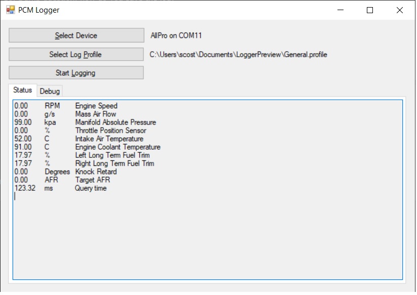

It works! Using the Allpro in Windows 10. Dumb question, how do you save the log?
Re: Data logger for P01 and P59
I suspect
Right Click over the text
Select: Select All
Right Click over the selected text
Select: Copy
Then paste into your favorite text editor.
Copy and paste what?
- PCM Logger Debug Screen.jpg (128.77 KiB) Viewed 10400 times
- PCM Logger Status Screen.jpg (72.71 KiB) Viewed 10400 times
I have nothing to log, I do not have the logger available at this moment, I am only going by his (NSFW) typical competent work. I may be wrong!
However, If you hover the mouse over the Text box where the Data is ("Requesting row" or "Intake Air Temperature") and Right Click it should give you a 'Context Menu', from that menu you can 'Select All' ... (Or copy if it's already selected)
I should have said something about this...
Better yet, I should put something in the UI to say something about this...
You'll find log files in c:\users\USERNAME\
