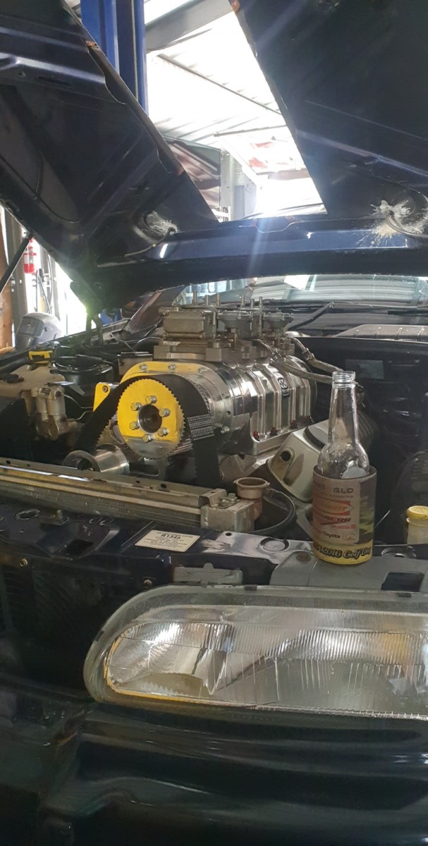

Hey guys just after some advice.
I'm helping a mate get his vr Stateo going with a 6/71 blower on his worked 5L. Recently we've just done a 2speed powerglide conversion on it and got it going sweet but now he's got himself a full supercharger kit including boost referenced blower carbs so efi is outta the question...
I'm thinking if I adapt a tps to a carb and put a 2 or 3 bar map sensor I should be able to accurately control spark for all boost conditions??? Or is it more than just that?
Any info is much appreciated
Cheers Rob
Spark only 11P 424 on 6/71 blown vr Stateo

Geeee what are those filthy things on top

Re: Spark only 11P 424 on 6/71 blown vr Stateo
lol yeah i know ive been into im over them but i think ive convinced him to do hidden injectors in a efi bird catcher scoop later on...
ill start a build thread shortly, cheers
