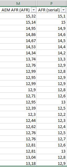

Finally analog and digital/serial AFR in one log. Quite close to each other.
Btw. Running rich at wot ?
NSFW
Posts: 679
Re: Pcmlogger EGR/WB profile
Post by NSFW »
Congratulations on getting it working, that's really cool.
12.5:1 is pretty reasonable for full throttle, max power is often in that range. Air is the scarce ingredient, and I read somewhere that adding a little extra fuel helps to ensure that 100% of the air gets combusted.
It might also be partly because extra fuel allows a little more timing advance without knock (due to cooling, if I remember right). Turbo cars rely a lot on that, my Subaru runs around 11:1 at WOT (and stock it was almost 10:1), but I don't know if it's useful for NA cars to go that rich.
aaronc7
Posts: 53
Joined: Mon Jun 15, 2020 12:35 pm
cars: 2003 C5Z
2017 Audi S3
Post by aaronc7 »
My go for the LS1 NA is 12.5 (on the gas 14.7:1 scale) AFR. Some dudes target around 13:1, but in my experience, minimal power gain, so I prefer to have a little extra cooling and headroom. Also since it's open loop at WOT...12.5 adds in another safety factor for inconsistencies.
