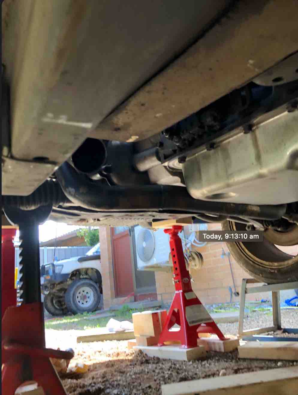

so me and ryan got to some work on the weekend. getting burnt, grinding welding and making noise. good times.
so this became a thing
......at least the exhaust comes out under the car.
its a bit tight, which is what she said

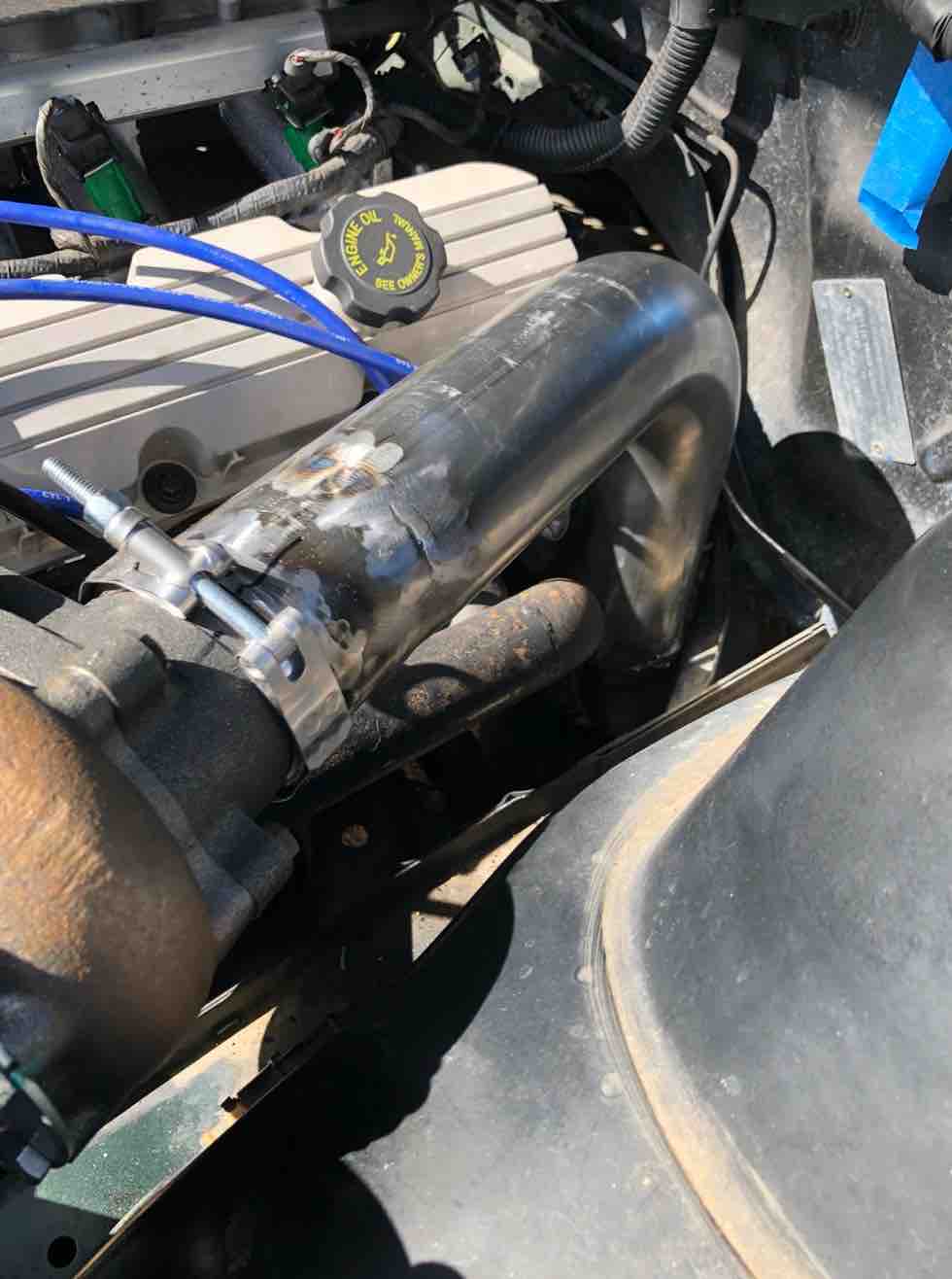

i don't like cheap vachina v bands. they are shit. EDIT. they are even more shit when some fuckwit welds them on backwards. i hate building exhausts not on a hoist. it is shit also. never again, meh i had a go. i am living up to my burnie tannington name now my arm is burnt from welding flash.
the wastegate angle is nice now. modified and welded the bracket so it fits nicely
modified this
then further modified it by removing the bottom part of it later on as the ball/cable receiver was sticking on the bracket = death.

PS; yes I need more jack stands. a friend got crushed under a car but lived to survive the tale. LOL at the 9.13.10am in my image, thanks Mac.
