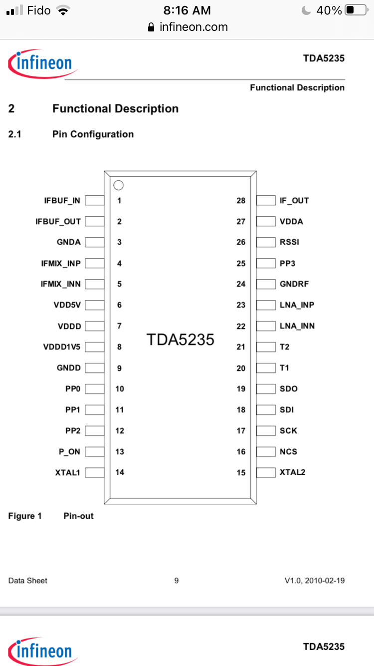

So clearly pin 11 data out of the rf receiver goes to the processor.. but I tried to trace it and nothing pinged off the processor pins with the multi meter on the 2009 board.
I really want to find what module this goes to see the way the processor receives the key fob remote I have one with a trunk button. I want to get its signal to lock the tailgate!
How does the OS send a signal to the processor to upload data from the registers? Is it first controlled via a MUX, then the data outputted into a register?
