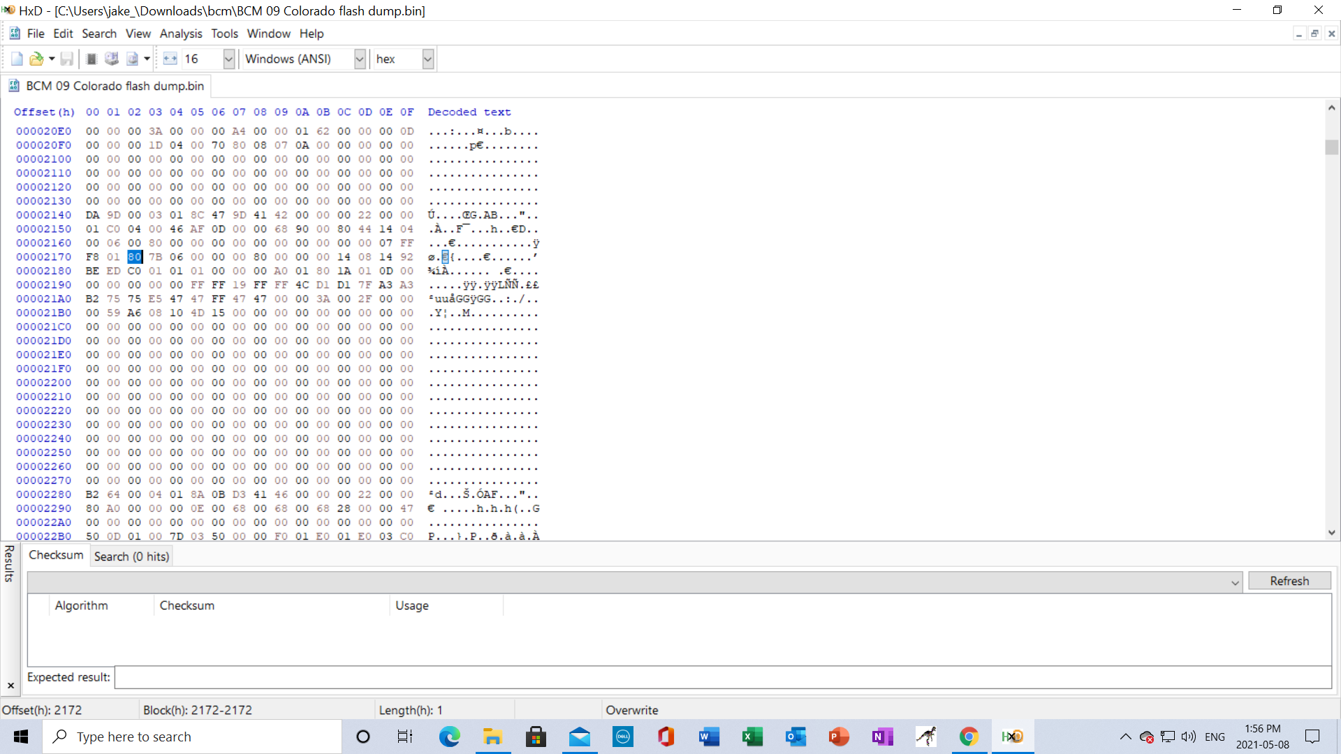

So for example I think that this is likely the location that enables or disables Fog lights, I don't think the file you posted has fog lights enabled? If it did this would likely be F0, instead its 80. Location 21722. What I want to know, is, in an disassembly does this address show up in the OS? It should somehow be linked to it? And would it show other options that work? Because I'd like to enable fogs to stay on with low beams and high beams on. So maybe we can say type E0, or something to make that happen, but its an complete guess without seeing what is implemented in the OS.

JTAG doesn't use a kernel. It directly controls the hardware at a very, very low level. So when you send it a halt instruction, it stops. CPU, memory bus, watchdogs....everything just stops cold. You can read out the contents of memory and registers as they were frozen at that moment in time. The command I used to read the flash just went through and read every byte of memory between the start and end points I specified. You can use the same technique to write to flash, assuming you know how to set up the different control registers to enable flash writes in the first place. I don't know how to do that just yet. Having an unreliable interface didn't really help my motivation with that.
Sometimes different calibration fields are copied from flash or EPROM into RAM. You could potentially test calibration changes by editing the values in RAM instead of flash, assuming they're set up that way and not updated after the CPU finishes booting.
Finding other valid values in disassembly can be a real challenge. Take your fog light example. When you press the fog light button, it might check a couple flags in RAM that show whether or not fog lights are enabled, and whether they're allowed to be turned on right now. IE, are the headlights on. So then you'd need to backtrack that 'fog lights allowed' flag to see where it gets set up, and whether it's tied to a calibration value. If it's not, then you might need to modify the OS itself to allow headlights and fog lights at the same time. None of this can happen until you find the subroutine that maps to the fog switch input and output pins, which is a challenge in itself.
Keep in mind this is all just theoretical. I haven't dove very far into this OS at all.

Yeah people keep trying to tell me to use the ram to watch for changes and trace it back. Never could get that to happen on the E67, as it wouldn't stay in halt, and kept resting. I think because of its separate ECU chip with some kind of watch dog. Ok It seemed like PE micro had some sort of code to disable watch dogs on the main CPU for the E67, that's why I thought it would also be required for this project.
So in the disassembly it doesn't show where the Fog Lamp enable bit goes to in the OS? Isn't the Os laid out like a bunch of addresses? As the code executes in it's order it would reach address xxxxxxx and jump there to check what the Value is? If xxxxxxx = = 90 then Fog lamps are enabled .... etc.. I just wnat to find that point because there should be a table of values listed in the OS, that are excepted for that address. Then I can try each one and see what it does? Right now I don't really know which values are valid?

Here's why this is challenging.
Address 0x2172 isn't directly referenced anywhere in the disassembly. All of this code uses indirect references and offsets. I went digging for that reference, and I found where it makes a call to 0x216C, along with addresses from four other calibration segments. I've only glanced at this, so I don't have a full understanding of it. But this is the gist of it.
It loads a pointer to a starting point RAM, and then it loads these starting points from five different calibration regions. It loads a byte from each location, manipulates it, and then stores it in RAM. It increments all the addresses, and then does it all again another 11 times. It actually looks like it's packing different configuration options into various memory locations. So at some point it processes your byte at 0x2172, and I think it writes it to 0x8000C5A in RAM.
That RAM address isn't referenced directly in the code either. So we're right back where we started. We have to find the base pointer, find the code that offsets from that base address to the address we want, and then figure out what it does and what values are and are not valid. This gets even trickier if it's actually packing multiple values into a single RAM address. It also likely references a half dozen other RAM values along the way, so now we need to go find out what those do, before we can find out the valid ranges for your fog light calibration byte. So maybe 0xF0 is a valid fog light combo....but only if specific values in other unknown RAM addresses are in a given state.
It's this giant Gordian knot of ones and zeroes.
