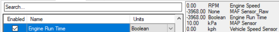

I noticed the Pcm Logger 016-D Preview 2 byte calculations are not what I expected. I changed the bin to force a run time of 0xF080, and did the same for the MAF sensor PID so I could report RAM address location values. Something strange is going on with the MSbit assuming a sign position and how the remaining 7 bits are used. It is not a standard 2s complement.
I expected to see 0xF080 = 61,568 is Pcm Logger assumes unsigned which the XML assumes since does a MSB*256
or a -61,568
From the Parameters.Standard.file

I think for now I will just report the RAM Address WORD sized data using two different byte sized PIDs which seem to not assumed 2s complement data.

I figured out what happened. Here is how it goes. I was reporting a value of 0xF080 in the Mass Airflow PID.
MSB = 0xF0
LSB = 0x80
The Pcm Logger assumes the MSB of the Airflow PID is SIGNED, and the LSB is UNSIGNED.
2s complement of 0xF0 is NOT(0xF0)+1 = 0x10 = -16 decimal
Pcm Logged computes this : -16 *256 + 128 = -3968
It does the same for the EngineRunTime so if the MSByte bit 7 is ever set it will start reporting negative. I am guessing it does this for all of the PIDS that report 2 bytes.

Yes, I think you've got it figured out.
I'm pretty sure that you can now use just "x" instead of combingin the x_high and x_low values in the expression, but the "x" value is going to have the same problem because it is computed the same way.
In the Subaru logger definitions from the RomRaider project, there's a storagetype attribute, so for example you can say storagetype="uint8" or storagetype="int16" or whatever. That tells the code how to avoid this kind of problem. I'll add the same thing here, and use that in place of the byteCount attribute that's in there now, since storagetype also indicates the number of bytes.
